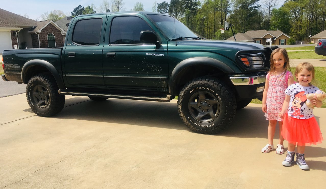

    Finally got my truck set up the way I want it. Took me 2 times if guessing and checking. I went with OME 881/bilstein 5100’s and the toytec AAL in the rear. I ended up using a 1/4” drivers side top plate spacer and set the 5100 on the drivers side at .67 “second from bottom perch”. This gave me a roughly 37.25” from ground to fender on both sides. I am very happy with the ride and stance of my old Toyota.

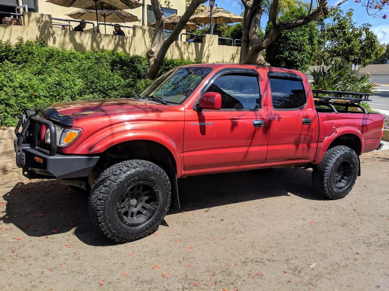

    I finally got the suspension, sliders and new gas tank skid installed. I had my buddy install the new Safe-T-Cap frame sections and everything works great. I'm running 882's w/ Dakar packs and the aal. The ride is so much smoother and the truck feels incredibly more stable. Absolutely love it. Sorry for the crap pics, I'll get better ones tomorrow in the daylight.
    [​IMG]20190328_195302 by Bob Condor, on Flickr
    [​IMG]20190328_195251 by Bob Condor, on Flickr

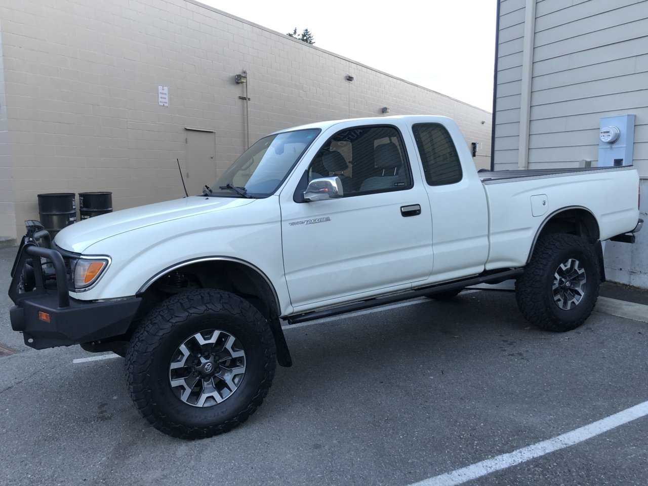

    So current set up:
    ARB Bumper
    Badlands 9K winch
    96 Tacoma SR5 Ext
    OME Nitros w/ 883
    .25 Wheelers lean spacer
    Dakar 2.25 w/ Bilstein 5100
    285/75/16 KO2
    Tacoma OR 16’ wheels
    1.25 Spidertrax
    Ride Height:
    Front Driver:
    23.75 / 39.5 (estimates on all measurements)
    Front Passenger:
    23.5 / 39.25
    Rear Driver
    25 / 41
    Rear
    25 / 41
    My leafs are still fairly new so I’m guessing some sag will come. Hoping the 883 holds up for a while and doesn’t sag too much. Rear plate bumper should be on next weekend.
    Hope this helps someone trying to figur this out.
