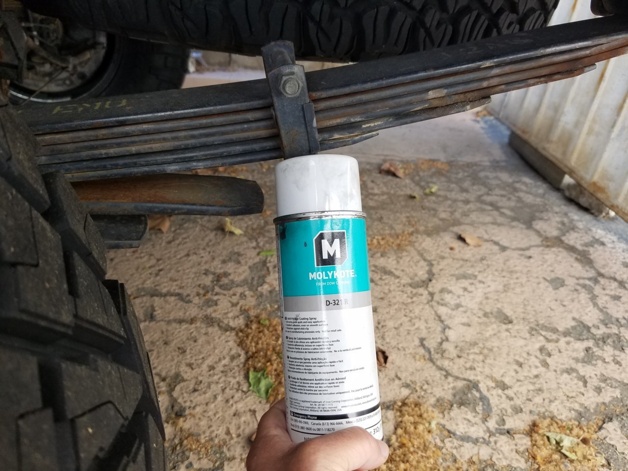

  7. Apr 13, 2019 at 9:26 AM
    #4307
    btu44
    btu44 Well-Known Member
    Sep 7, 2016
    #196732
    330
    Long Beach area, Ca
    04 Tacoma Double Cab, 4WD, TRD Off-Road
    SC with 7th injector. ICON 2.5 shocks and coil overs, SPC UCA, EMU Dakar rear springs. FrontRunner bed rack. ICOM IC7100 amateur transceiver
    I bought a can of this from McMaster-Carr. The price will make you choke but one application has lasted all year.
    D321R has heavy solvents so it seeps in between the leafs then dries to waxy moly coating.
    In desert sand woops you could hear my truck coming a mile away the squeak was so bad. Since using D321R the truck is almost silent.
  8. Apr 13, 2019 at 11:11 AM
    #4308
    Area51Runner
    Area51Runner Well-Known Member
    Jun 26, 2014
    #132748
    11,972
    Northern California, Bay Area
    02 3.4 DC TRD PreRunner 4WD SWAP
    Thx. Looks interesting, I'll order and give it a try. They also apparently make it in goop form as well.

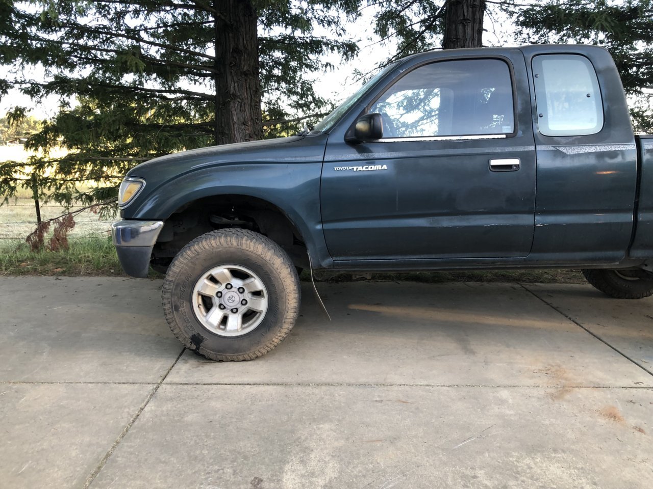

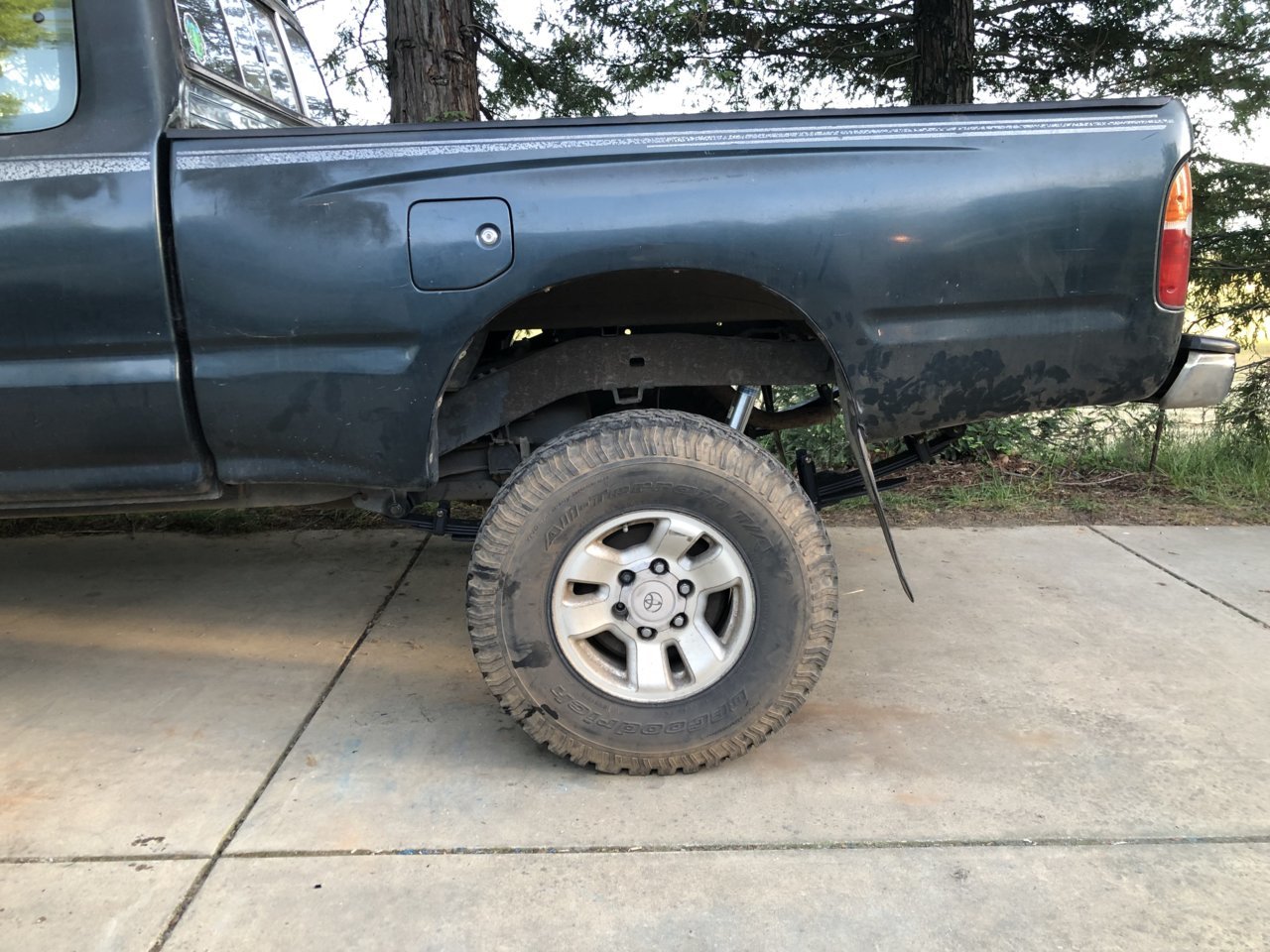

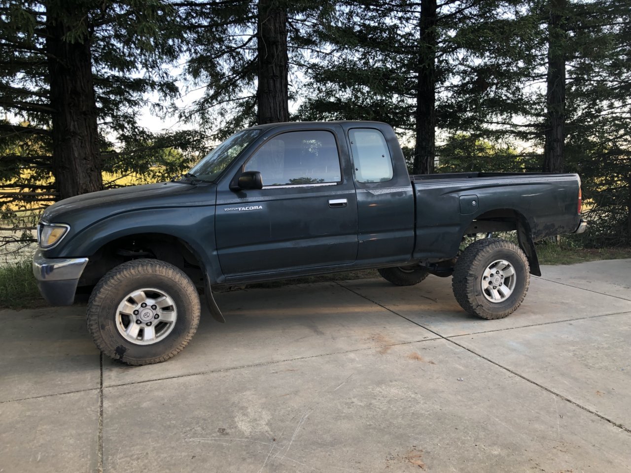

  18. May 10, 2019 at 4:58 PM
    #4318
    techfinsoup
    techfinsoup Well-Known Member
    Sep 28, 2017
    #231471
    2,647
    Sacramento
    1996 Tacoma 4x4
    Finally had the time to install the lift kit. First time installing a lift kit and boy ohh boy what a learning experience. Long story short.....rear leaf spring pack was a pain in the ass. I was not able to line up the bottom pin of the leaf pack to the actual axle where it sits. Was able to do so after reading another member's method of using tie straps and pulled it in place. Day 1.. Installed the rear 5100's and the front adjustable 5100's at 0 with the OME 881 springs. Instantly what a difference it made! truck felt brand new. If not smoother than my 2017 TRD Sport 4x4. Love the ride, went through some dirt road and terrain and it handled like a champ!. Day 2.. Installed the leaf pack, I was like WTF! this is high as hell! measured a total of 4" of lift. Took it out on city streets and dirt roads, ohh man the rear was super bouncy and stiff. The ride was horrible. Now i know what "medium duty" means. Although it rides like a brick in the rear, the truck was solid!. Thank goodness I bought the 5100 adjustable with OME 881. OME 881 alone gave me 2", which means I can adjust the 5100's to the first clip, which will give me an additional 1" of lift. This will level the front between 3 - 3.5". Dump a half cubic yard of landscaping rocks or mulch in the truck bed and let it sit. Maybe in a month or so the rear will settle down to 3". This should level me out completely without the fear of any sag if I were to add a front and rear bumper.
    If I were to do this all over again, the only thing I would change is to remove one of the leaf from the pack. Or if the rear leafs were not 302K miles and beyond death, I would get an AAL. Also extended brake line is one item I should have bought as well.
    Below are pictures and measurements of the truck with 5100's at 0 with OME881 and 5100 rears with full Dakars CS019R. When i get a chance I'll take pictures and measurements of the truck after i adjust the front to "1".
    Tire pressure 32 psi all around
    Ground to fender
    Rear left 36 7/16
    Rear right 36 8/16
    Front right 35 13/16
    Front left 35.5 even
    Center hub to fender
    Rear left 22
    Rear right 22 1/16
    Front right 21 14/16
    Front left 21 13/6
    After lift
    Ground to fender
    Rear left 41”
    Rear right 41”
    Center to fender
    Rear left 26 7/10
    Rear right 26 7/10
    Ground to fender
    Front right 37
    Front left 36 8/10
    Center to fender
    Front right 23
    Front left 23
