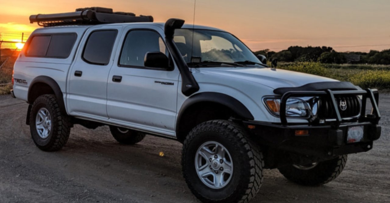

    Old Man Emu lift kit with 881s. I have an 02 and went with this kit. Have a leer 100r cap and also went with OME's AAL. With nitrochargers all around, I'm satisfied with the stance and amount of lift. I currently have an ARB bumper without winch but may add one later. If so, will switch out coils then. For now, satisfied.
    Check with Josh over at @Wheeler's Off-Road Inc - he'll be able to answer any Q's and square away what you need. He was awesome when I was researching my kit.
    Here is the kit I went with (AAL is additional) - Screenshot_20190714-112126.jpg
    For the 255's, going to suggest SPC Upper Control Arms... I went with these when I moved to 255/85/16's.

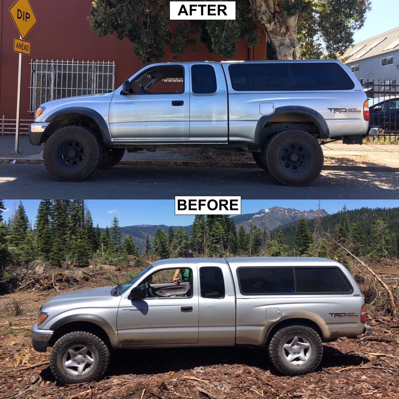

    Tacoverlander, could you provide some wheel/tire specs on your first Gen. I realize this was a long time ago but I dig this truck and wanna know if you kept everything clear from rubbing with this set up. Thx

    Pretty sure those are 255/85/16 km2s on some sort of Toyota spare wheels.
    You’re not going to fit a 255/85 without a little trimming. Nothing crazy though.

    Ok, thanks, that's the straight up answer I was looking for. I like those 255s though. Did you need any wheel spacers with those steelies?

    Without knowing what they came from, it’s hard to say for sure, but most likely if you want to stay off the frame. Mine rubbed frame at full lock plus full bump when they were new at 4.0” backspace. Stock 1st gen wheels are 4.5”.
    List of the other things I had to do to get them to fit is referenced on page 1 of my build.
    It was an awesome size for me. Big fan of that tire too.

    This is correct on the tire size and Toyota Tundra spare wheel. I had 1.5” spacers as well. As far as scrubbing, I only scrubbed at full lock while hitting a bump. To correct this, I install the 1” body lift from 4Crawler that completely eliminated any scrubbing. Hope this helps.
