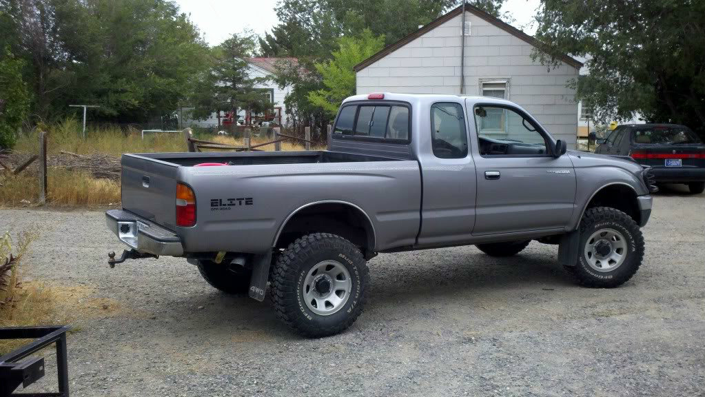

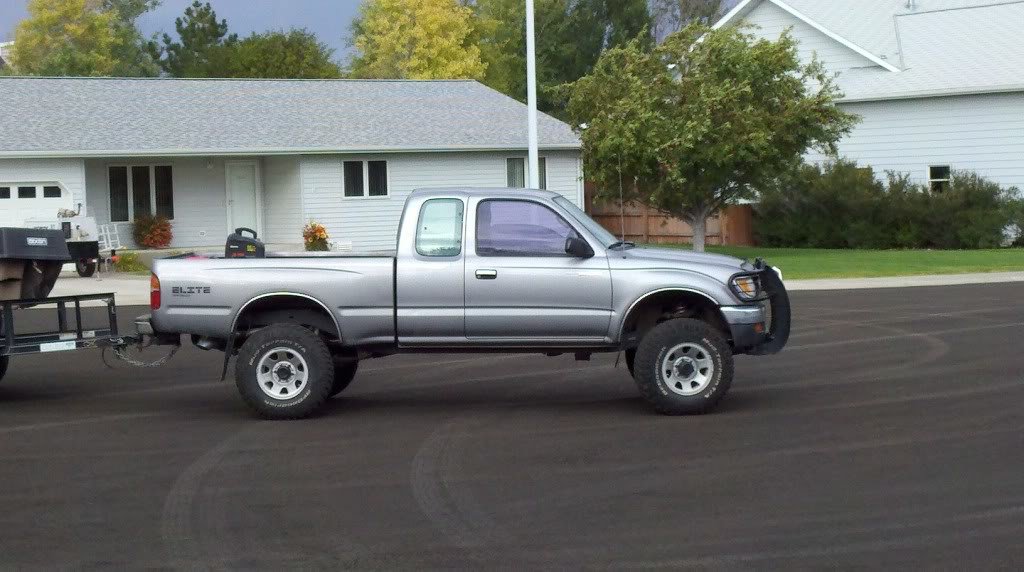

    i had 3.5'' front lift and 4.5''ish rear with 31x10.5s. Looked fine. Big part of that was i added wheel spacers to push out the wheels. Looked better to me. But it doesn't look funny.
    33s did make it look better no doubt. But i didn't think it was bad at all with the 31s. I will say once i got an plate bumper the 31s looked odd up on the front. But stock bumper it was great.
    there is no way you could run a 33'' tire on saggy old suspension without doing serious trimming. especially a 33x12.5

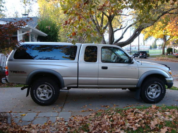

    Just for reference: When I first bought the truck used, 100k miles, worn out stock suspension, 265/75 16 BFGs. One side showed witness marks of having rubbed a tad on the frame at full lock, and the mudflap showed the same, and one of its screws was missing. I can only imagine he had wheeled it a bit to do this. Previous owner did live near Hollister Hills Offroad State Park.
    After changing to Michelin 256/70 16 (stock for TRD) but still stock worn suspension:
    Immediately after adding 881s (no settling):

    Thanks a lot for the pics. You're right it doesn't look bad at all. Those are pics of the truck lifted with 31's right? Looks good. Thanks again!

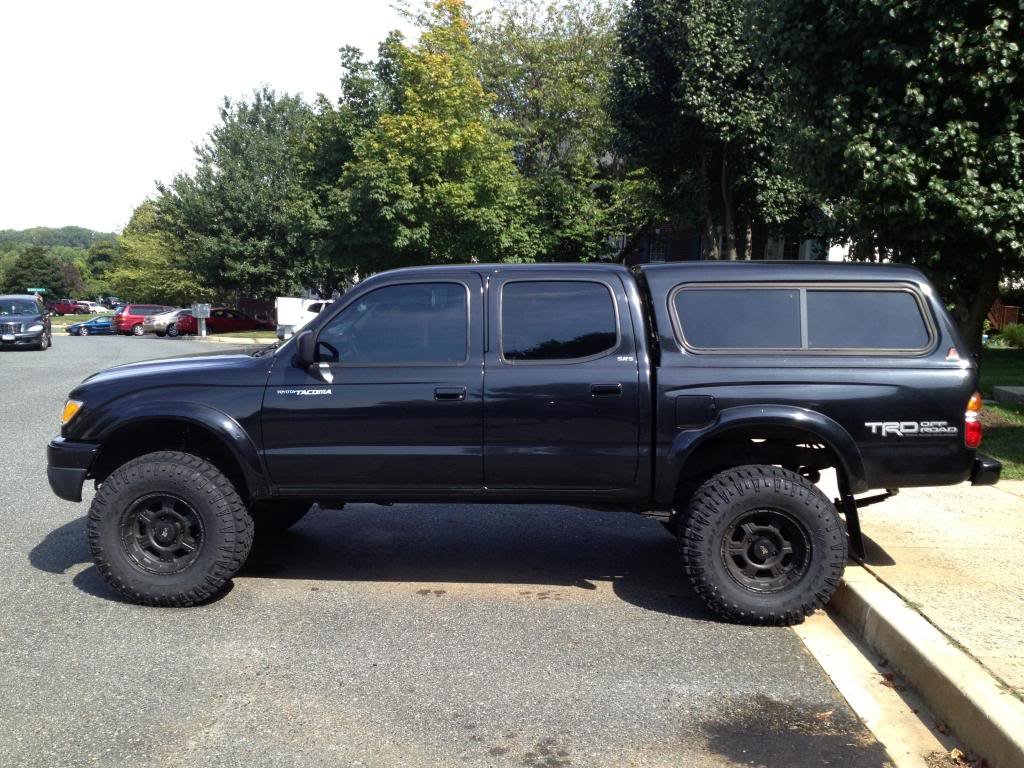

    04 SR5 TRD DC 4x4
    OME 882 Coils, OME Dakars with D6XL AAL, Nitrocharger Sport Shocks, Sky Manufacturing rear axle relocation plate set 3/4 inch towards rear, BAMF BPV Relocation Bracket, Leer 100R Shell, Trail Gear Sliders, Trail Gear Low Profile Front Bumper, CBI Outback 1.0 Rear Bumper w/ tire swing-out, Cornfed Suspension Diff Drop
    882's
    Dakar with D6XL
    285/75r16 Duratracs
