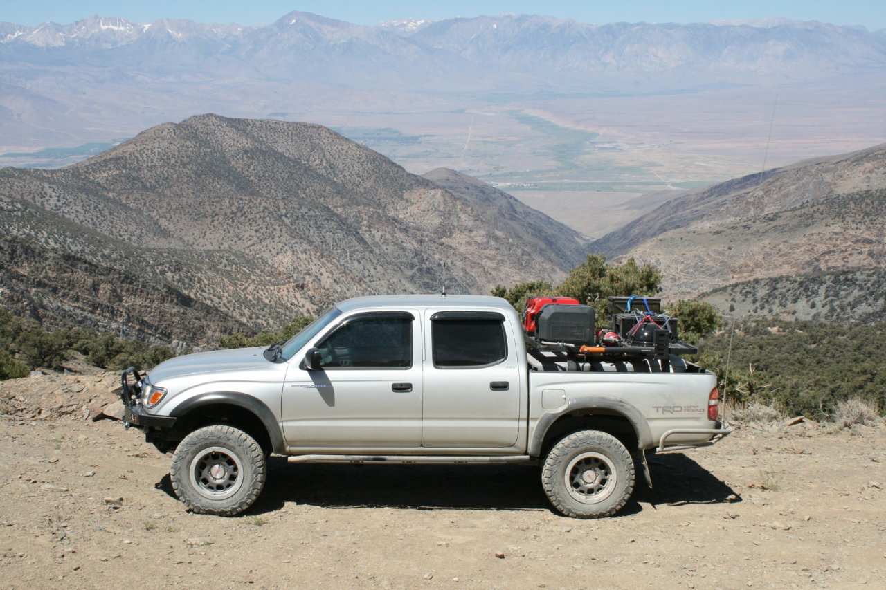

    SC with 7th injector. ICON 2.5 shocks and coil overs, SPC UCA, EMU Dakar rear springs. FrontRunner bed rack. ICOM IC7100 amateur transceiver
    When I purchased my Tacoma in Arizona and reg'd in Ca it weighed 3180 lbs...was basically stock.
    Later with mods and a camp load I'm up to a portly 5180 lbs (Frt 2560, Rr 2600). I am running the Dakar's with the 'Extra Leaf'. Also have ICON 2.5 shocks in the rear that provide a little lift too.
    Poncate likes this.
  14. Oct 24, 2019 at 5:50 PM
    #4394
    Dirty White
    Dirty White Well-Known Member
    Nov 5, 2017
    #235126
    64
    02 DC Prerunner and 03 ext can prerunner
    2002: 2.5" ome lift springs, 2.5" lift bilstein 5100 front shocks on oe coils and 5100 rear shocks. Topper. 285 75 16 toyo at2s. K&N intake. 2003: super spring progressive aal. Slide master 1000lb bed slide. Custom utility bed with lumber rack. Diamond aluminum 6ft boxes.
    Thank you for the info. How did you determine the front and rear weights from one another?
  15. Oct 25, 2019 at 5:06 PM
    #4395
    btu44
    btu44 Well-Known Member
    Sep 7, 2016
    #196732
    329
    Long Beach area, Ca
    04 Tacoma Double Cab, 4WD, TRD Off-Road
    Went to my local big truck weigh station. I parked the Tacoma over two of the scales pads.
    It did look kind of silly my little Tacoma in line with big rigs.
    couplefunones likes this.

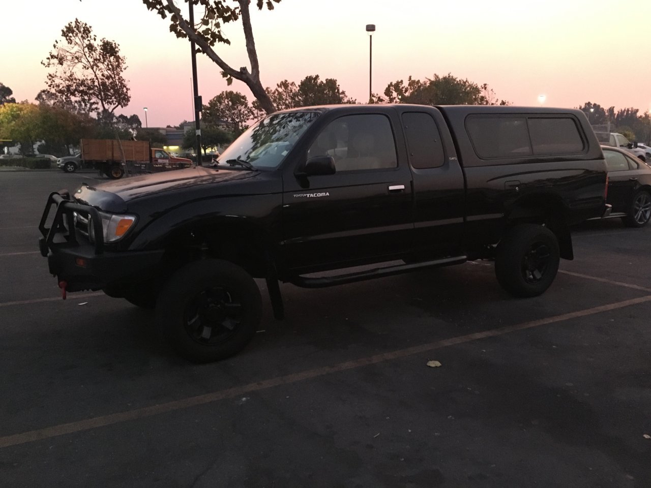

    1999 Toyota Tacoma 4x4 SR5 extended cab reborn!
    Complete OME suspension kit, Used low mileage V6 engine swap, black powder coated Chou Seiki T15x7JJ, ARB deluxe bumper, Smitty Bilt nerf bars, Weathertech floor liners, Torklift tiedowns
    I ordered my first suspension kit from Headstrong Offroad and had Milogen Fabrications in Milpitas, CA install my complete OME suspension kit. Parts installed by Milogen were:
    883 front coils
    Nitrogen Sport gas shocks
    Dakar leaf springs
    D43XL add a leaf
    greasable shackles
    Light Racing upper control arms
    I'm waiting for Milogen to call me about my 2' stainless steel brake line, having it installed, and my brake lines bled by him. The truck handles great on the highway and can't want to drive it offroad once the stainless brake line upgrade & service is finished.
  18. Oct 28, 2019 at 1:43 AM
    #4398
    Area51Runner
    Area51Runner Well-Known Member
    Jun 26, 2014
    #132748
    11,954
    Northern California, Bay Area
    02 3.4 DC TRD PreRunner 4WD SWAP
    Can't remember if he does alignments or not. If you haven't had it aligned, put it on the to-do list. After tires of course :thumbsup:

  19. Oct 28, 2019 at 1:55 AM
    #4399
    Hamer95USA
    Hamer95USA Well-Known Member
    Jan 11, 2017
    #207262
    567
    Milo had the alignment done by an outside shop that he does business with. I will be upgrading to a set of 16" OEM 4Runner aluminum alloy wheels & load range E tires very soon. I have plans that I will share with all of you soon. Getting the suspension upgrade was a priority since the worn out shocks & stock suspension made the truck handle poorly. Thanks for the compliment!
    Area51Runner[QUOTED] likes this.
