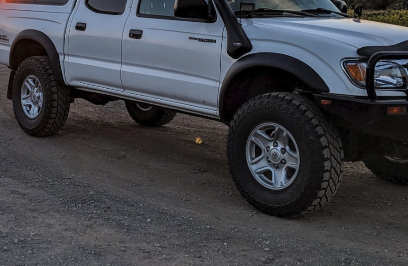

    Not those wheels. The 16" OEM 4Runner aluminum alloy wheels are similar in style to the 15" OEM Chou Seiki aluminum alloy wheels that are on my truck in the pictures. I also bought a spare 16" steel wheel as well when I switch over to the 16" wheels. Your truck looks bad ass in that picture!

    Ahhh ok. When anyone mentions 16" 4Runner wheels I think of these. Must be that 4.6 backspace thing ;)
    Thx!
