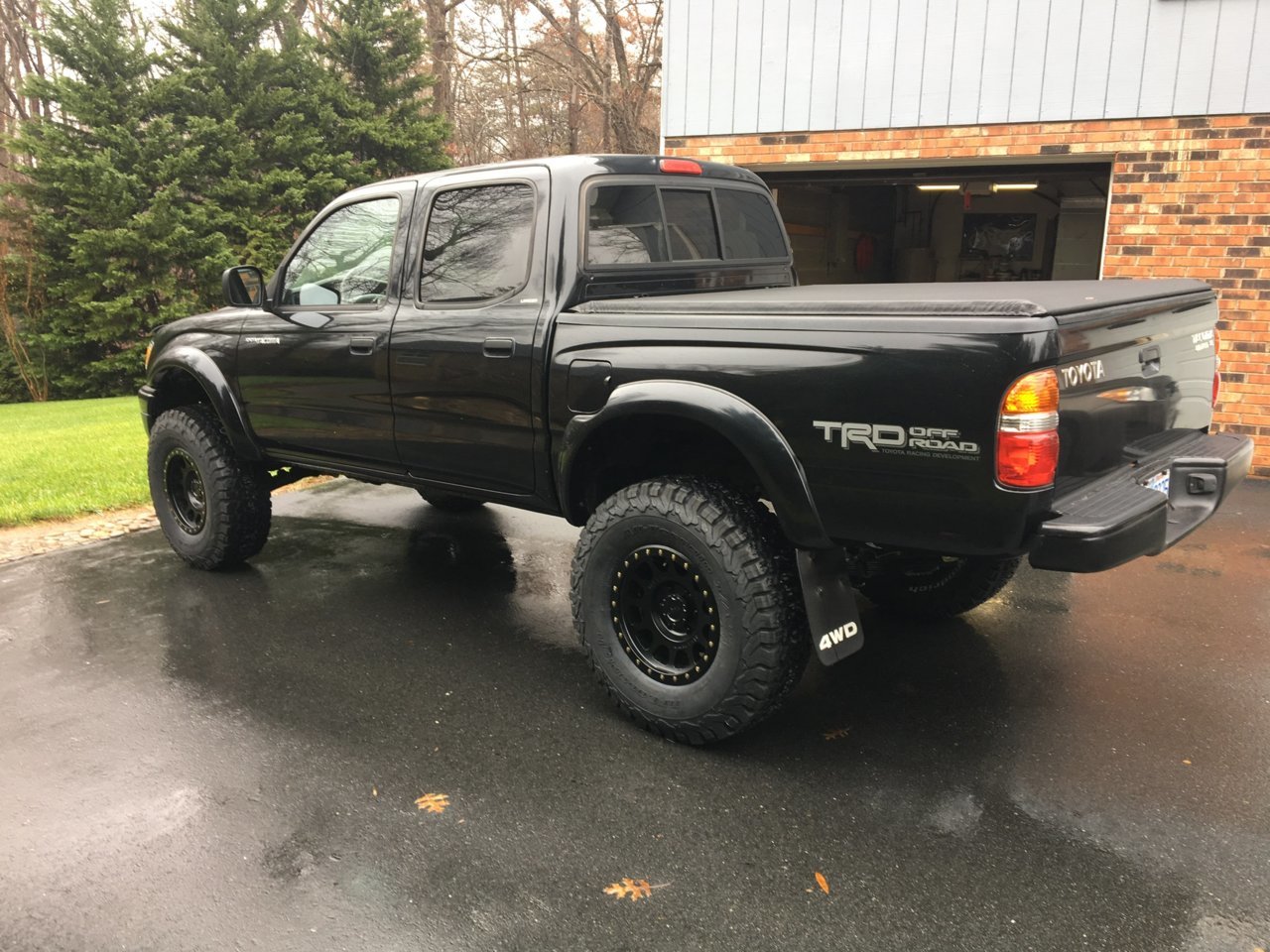

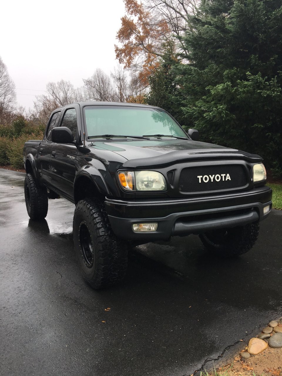

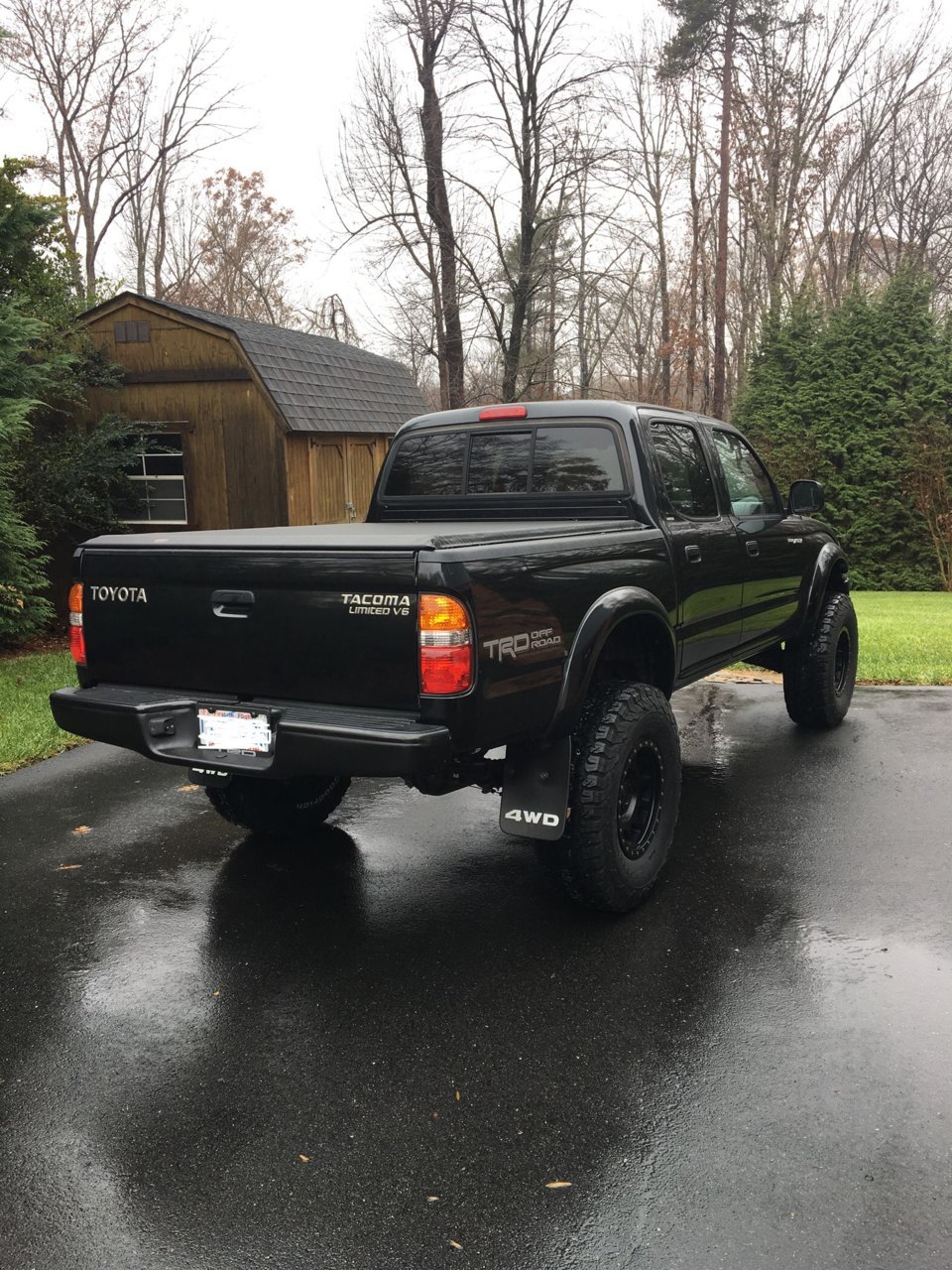

    A bunch of the same stuff everybody else has already done.

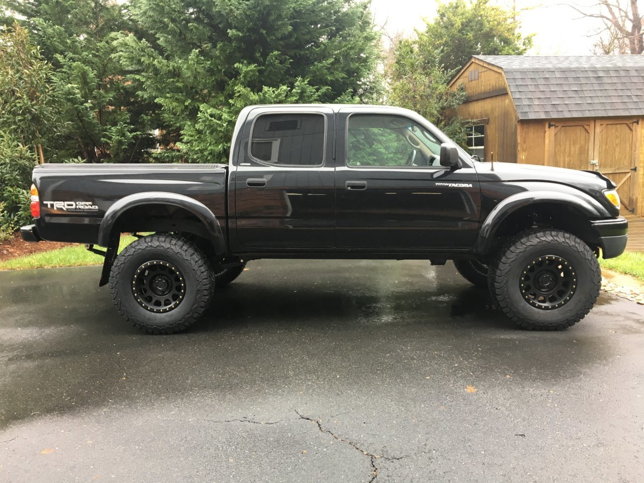

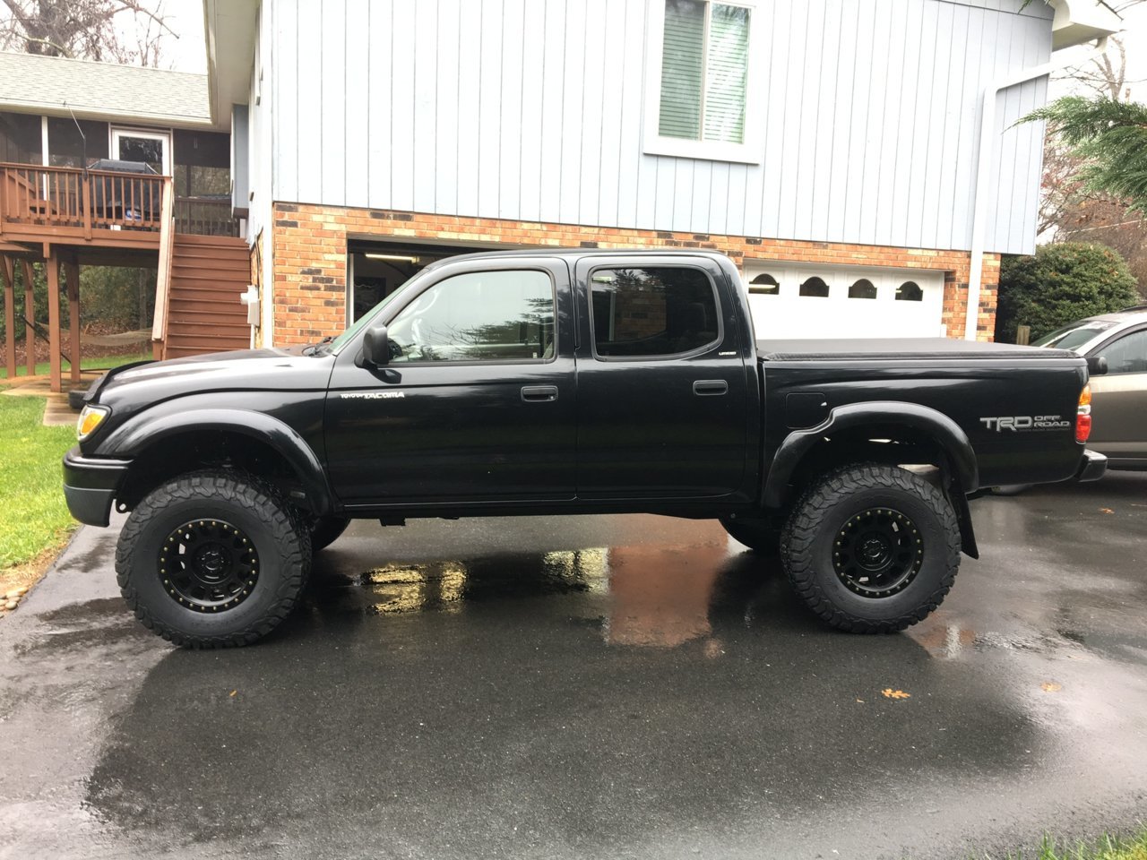

    Well, I finally got this baby all set up! Full OME lift. 883’s and nitrochargers up front, SPC light racing UCA’s, Dakar’s w/AAL and nitrochargers in the rear. Used the Sky’s off road design axel relocation bracket, 3/4” rear biased. Total Chaos diff drop as well. Desperately needs alignment and extended rear brake line. Method NV302 16x8 wheels with Spydertrax 1.25 spacers, and 285/75/R16 BFG KO2 meats:
    2DE5C2CF-B62B-4DCB-ACC7-1D8EADD0AE1D.jpg 61C32BAA-635B-4C6F-A5BF-D898A6211410.jpg
    Heights before lift, ground to top of wheel well opening:
    Driver front: 34 1/2”
    Driver rear: 35 5/8”
    Passenger front: 34 3/8”
    Passenger Rear: 35 1/4”
    Pumpkin to ground : 9 1/4”
    Transfer case to ground : 11 1/2”
    Skid plate to ground: 8 5/8”
    Heights after lift, ground to top of wheel well opening:
    Driver front: 39”
    Driver rear: 41”
    Passenger front: 39 3/4”
    Passenger Rear: 41 1/4”
    Diff Pumpkin to ground : 10 1/2”
    Transfer case to ground : 16 1/2”
    Skid plate to ground: 13 1/2”
    I’d say overall I got about 4.5-5” of lift from a very TIRED 2003 factory suspension and the 2” larger than factory diameter tires. It was a fun project and I learned a lot in the process! There’s definitely a little bit of the “taco lean” and the ass end is a little raked up but I’m hoping that will settle a little bit?

    It’ll settle over time for sure. If you use your bed any to haul stuff around town or load it down for a trip you will want some empty rake so it’s level when loaded. My Ford sits dead level and when i hook the trailer and crawler up it sags- makes the front light which sucks. Thinking about some air bags or AAL to solve this issue. :notsure:
    Edit: truck looks great BTW!

    Really like that grill

    Thanks ! I wasn’t sure if I would like it but I do for now

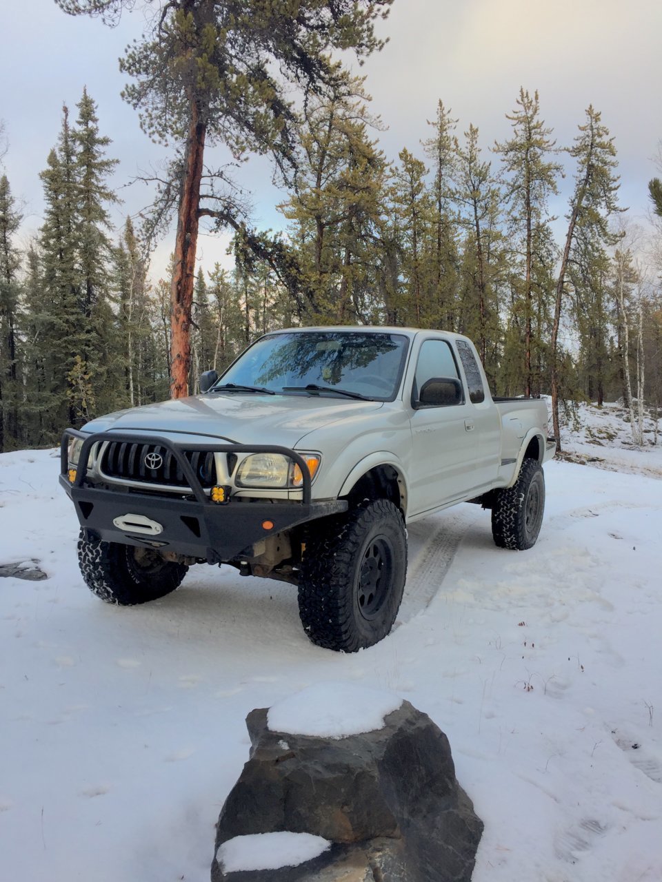

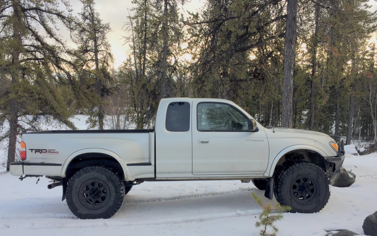

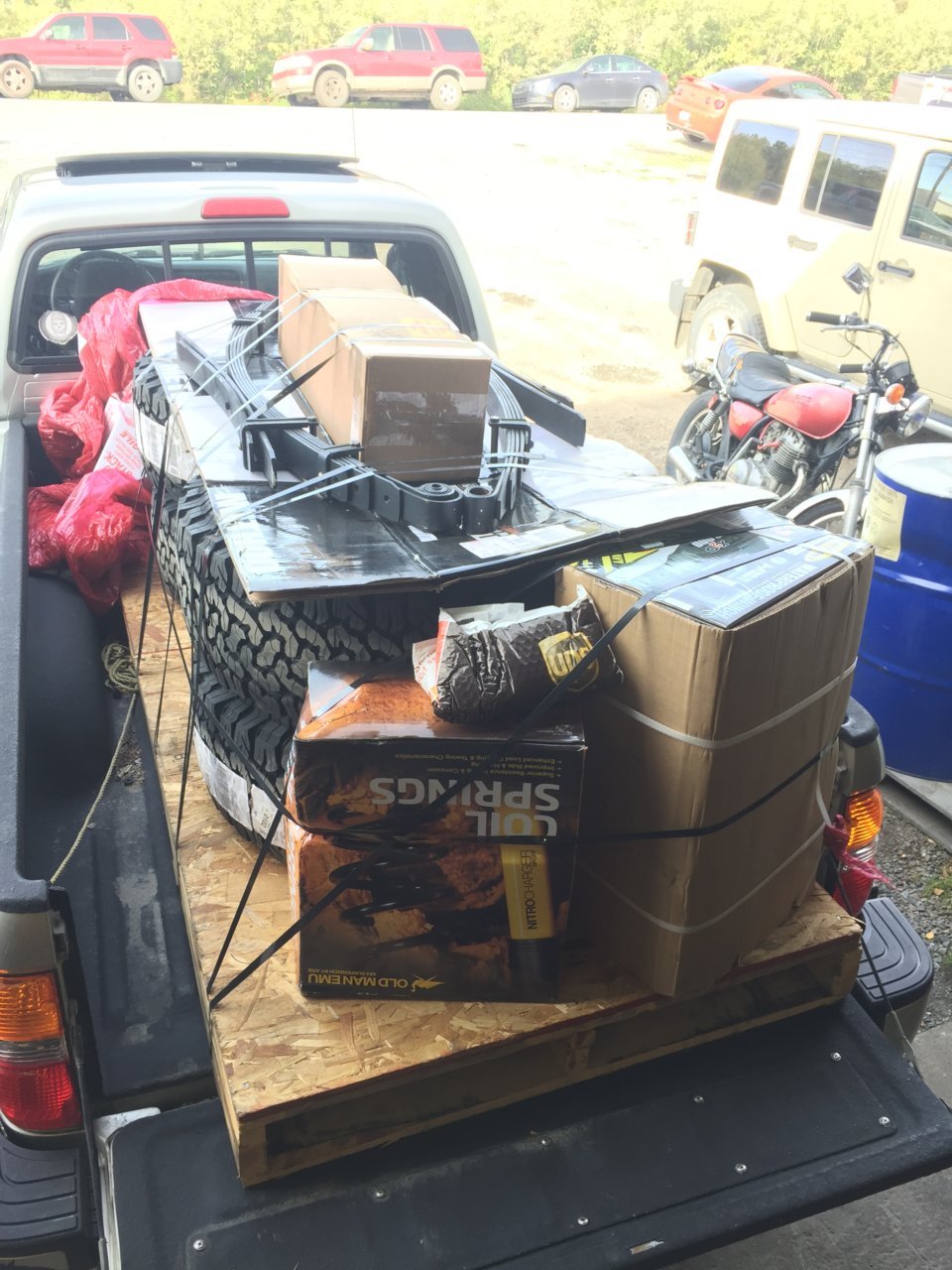

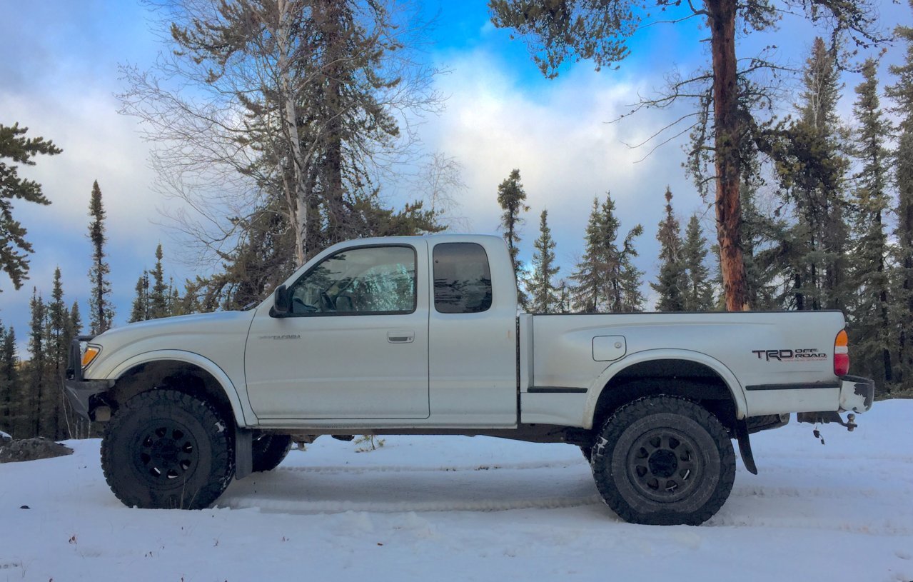

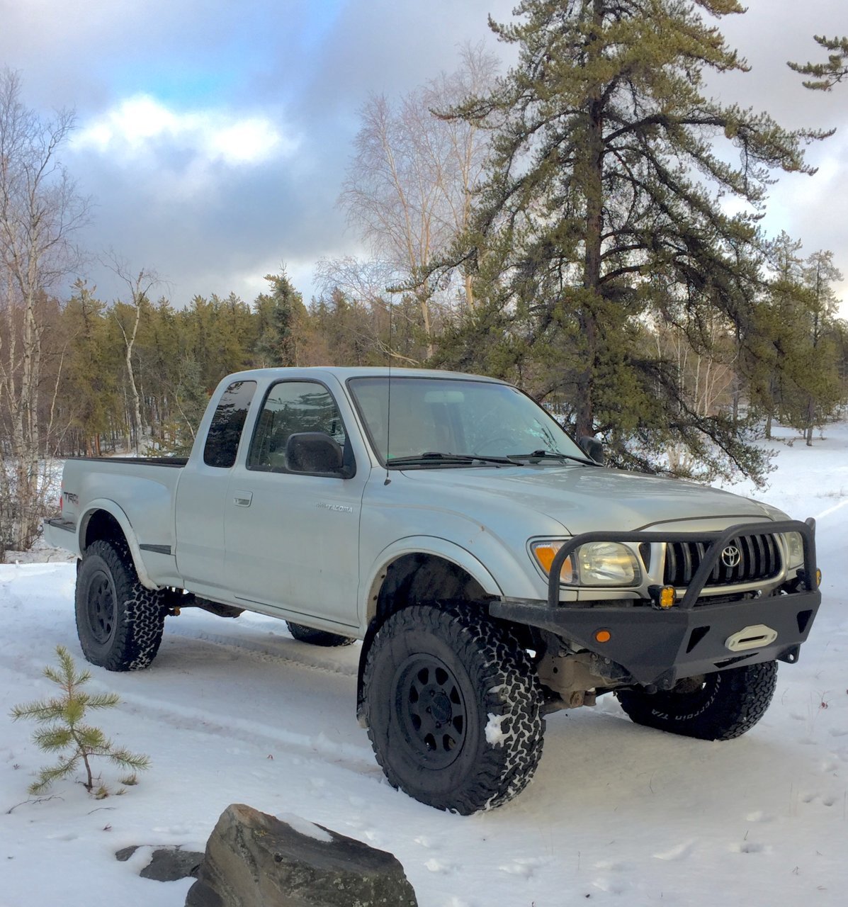

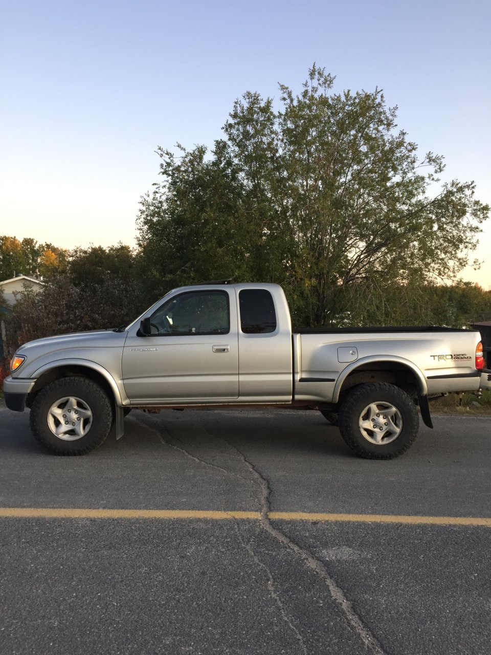

    Hi
    I might be the most northerly member on this site living in Yellowknife NT, Canada. Its -37 outside RN. I own a '03 TRD stepside bed. This summer I did:
    • OME lift 882's and nitrochargers up front.
    • Dakar and nitros in the back.
    • Diff drop kit.
    • CBI Moab bumber,
    • Smitty X20 winch,
    • Baja squadron Pro's
    • BUSSMAN relay box
    • BFG Ko2-285/75/16
    • Method 701
    Definitely wasnt cheap with shipping, and the install but I really like my ride now. Have some minor rubbing up front, and need a new skid plate. Id like to thank everyone on this site who helped me, and answered questions. Couldnt have done this without it so a big THANK YOU! IMG-4668.jpg IMG-4636.jpg IMG-4800.jpg IMG-4796.jpg IMG-4798.jpg IMG-4799.jpg

    Welcome to TW! Truck looks awesome! Stepside at that! AND A SUNROOF! Nice!
    Very reassuring our trucks can handle your weather (holy hell! -37 wow)
    Where is the rubbing up front? Stock Upper Control Arms, right? I wont suggest another upgrade (damn, you've done a ton already!), but SPC UCAs might help with that rubbing, especially if the rubbing is on pinchweld area of the fender splash liner.

    Thanks! Ya greatest truck ive ever owned. A bit small, but starts at -37 no probs with no plug in but I do plug in when possible.
    Rubbing is mostly on driver side, and yes stock upper control arms. Ill look into the SPC's, but realistically wont get to it to the spring (which is most likely your summer ha). Thanks again!

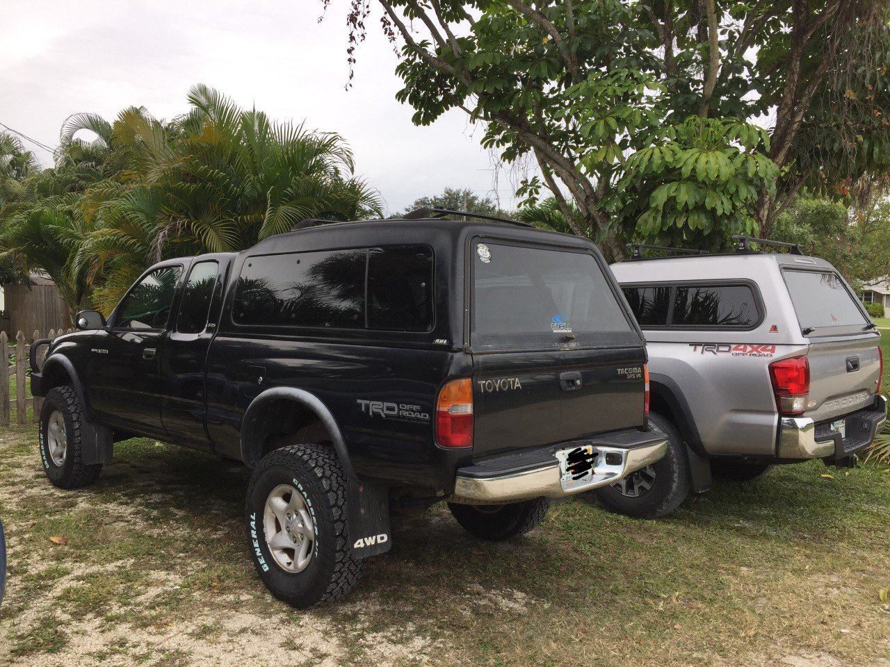

    OME 883s, Nitros, SPC UCAs, Dakar leaf pack with AAL, General Grabber ATx 265/75/ 16 No rubbing at full crank normal street/parking lot driving. Have not tested any articulation off road ect.
