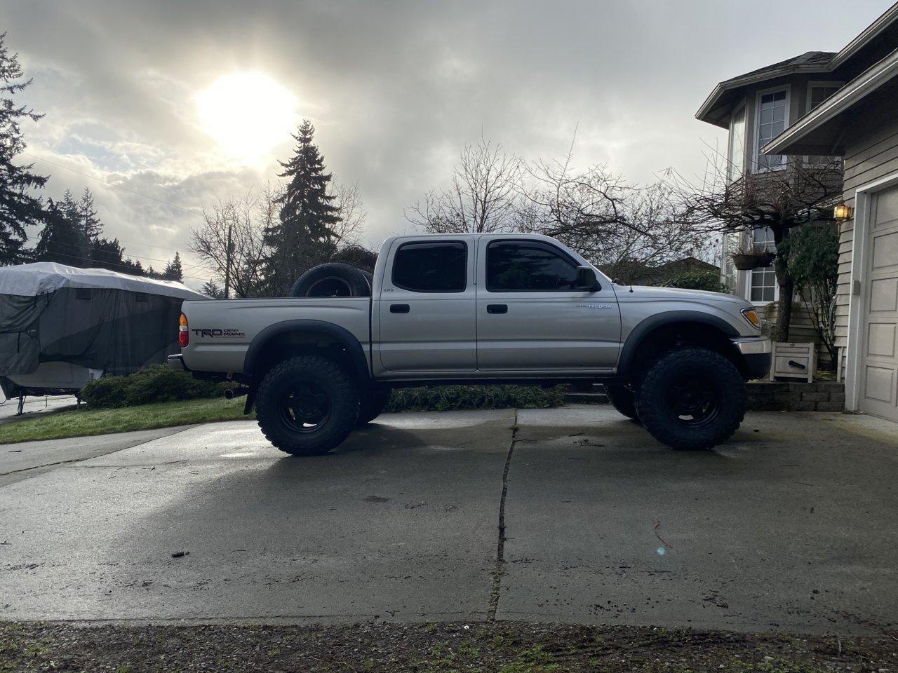

    BioG
    BioG Active Member
    Jul 22, 2018
    #260139
    29
    Pasadena, CA
    2002 Tacoma 2.7l 4x4
    OME 881, Nitros, Dakar leaf pack. Rides better than stock. Super capable little beast.

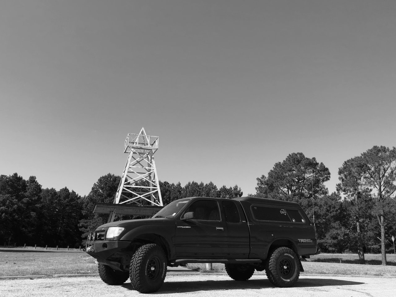

  13. Feb 3, 2020 at 12:33 PM
    #4453
    Paco the Taco
    Paco the Taco Well-Known Member
    Aug 19, 2016
    #194986
    101
    2000 Tacoma TRD 4x4
    Ballpark how much does that camper weigh?
  14. Feb 3, 2020 at 6:22 PM
    #4454
    Brake Weight
    Brake Weight But it hasn't rained in weeks...I'll make it.
    Jan 27, 2015
    #147363
    2,869
    Deep South near the Third Coast
    Taco pulling 33s and a B6 pushing 33psi
    Weld on sliders, fiberglass shell, 12k winch in an Elite Offroad bumper, front Aussie Lunchbox
    Love my Generals, too.
    indowaver[QUOTED] likes this.
