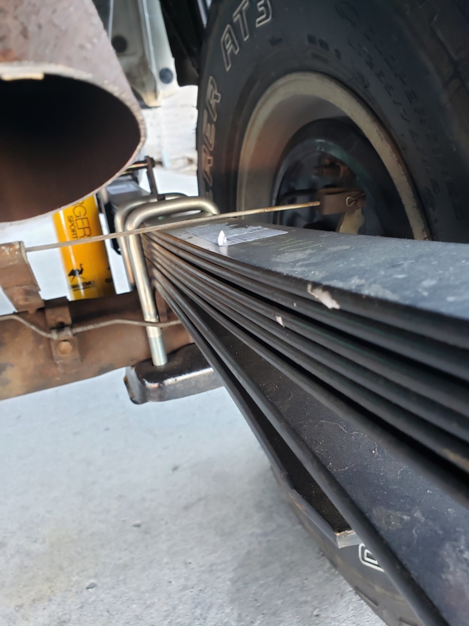

    Just did a full OME kit with the 882s and the add a leaf. Choose to go with the JBA UCAs.
    My parking brake cable is contacting the new leafs on the passenger side20200304_154248.jpg

    Looks great man! E-brake cable bracket mod will lift the cables off your leafs. You should see mine, yuck (Dakar with AAL). I've been meaning to make these brackets for too long, thanks for the reminder.
    https://www.bajataco.com/Brakes2.html

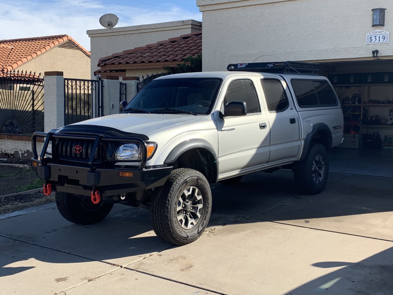

    Here is my OME kit from Wheelers Off-Road. 883's in the front due to bumper and soon to be winch. Very happy with the look and ride :)

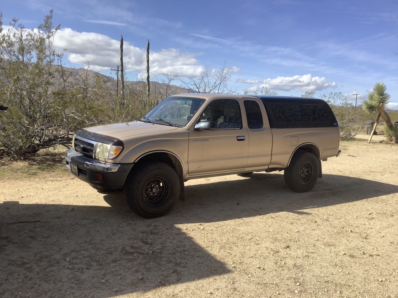

    1F836E27-04A7-4065-8B5E-A7A6DF8A8A91.jpg E6EECD64-98B5-4286-BA53-CF88831E60D9.jpg Hi y’all! Just got a Tacoma, first post. About to install a full OME kit. Wish I would’ve had wheelers assemble the struts, took em to a local shop not to happy with how it looks. Can’t tell if it’s just a poor quality strut mount/isolator and fitment or a poor job. Thoughts? I admit that I got too anxious and got the strut mounts from autozone, instead of waiting a day for the Monroe’s that reportedly work well. Oh stupid me. I’ve never seen the isolators look like this and watching the “mechanic” struggling to work the spring compressor doesn’t give me much confidence this was done right. Any advice is appreciated!

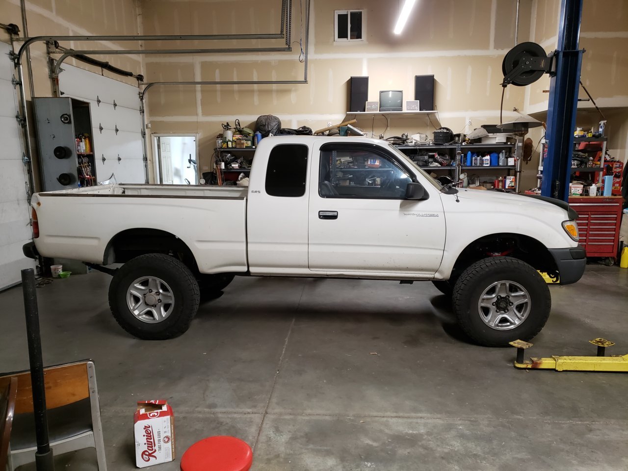

    I just placed an order at Wheeler's Off-Road for a complete OME 2" with 881s and an AAL for my 02 Xtra Cab. I am so excited!!!
    Does anyone have any install tips or advice? I plan on installing them myself at an auto hobby shop.
    BEFORE:
    2002Tacoma4x4 and Dalandser like this.
