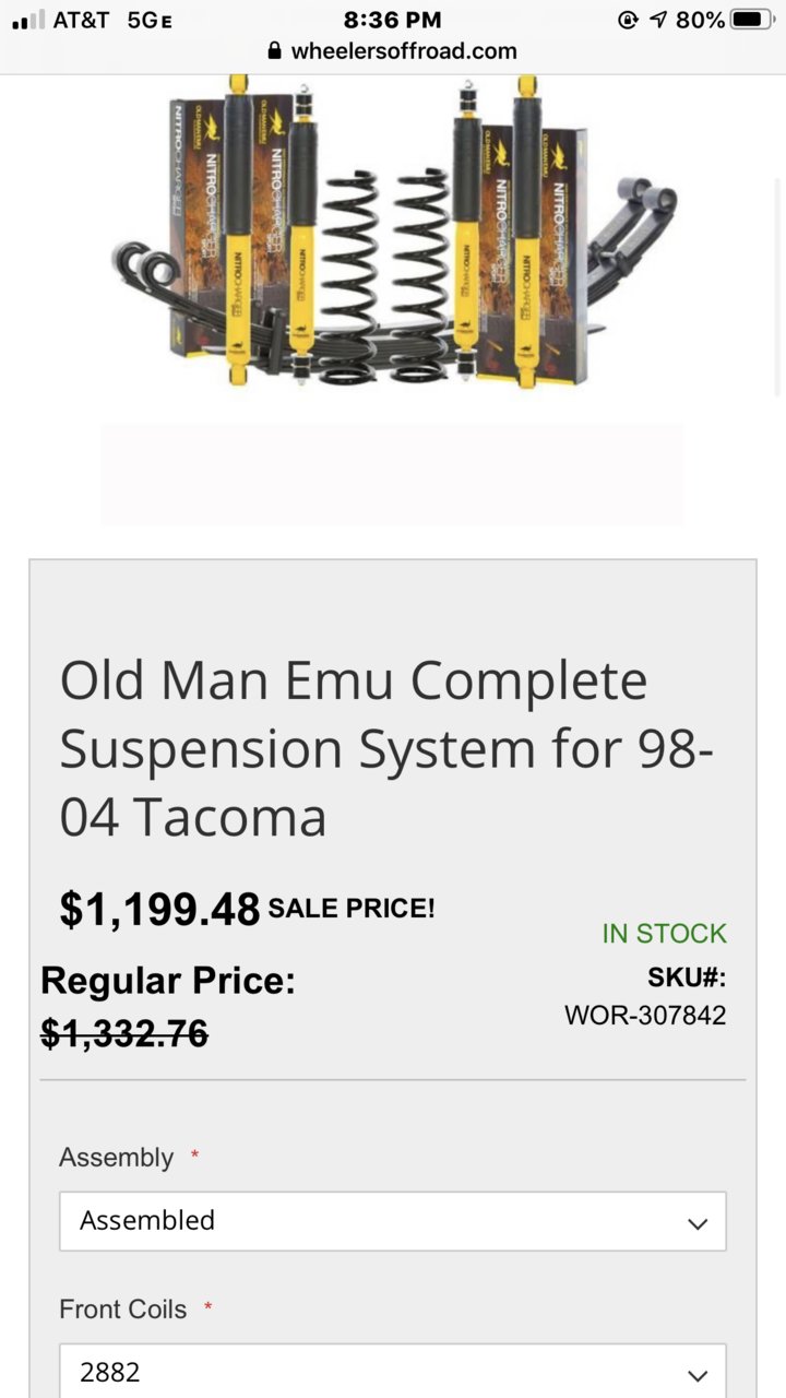

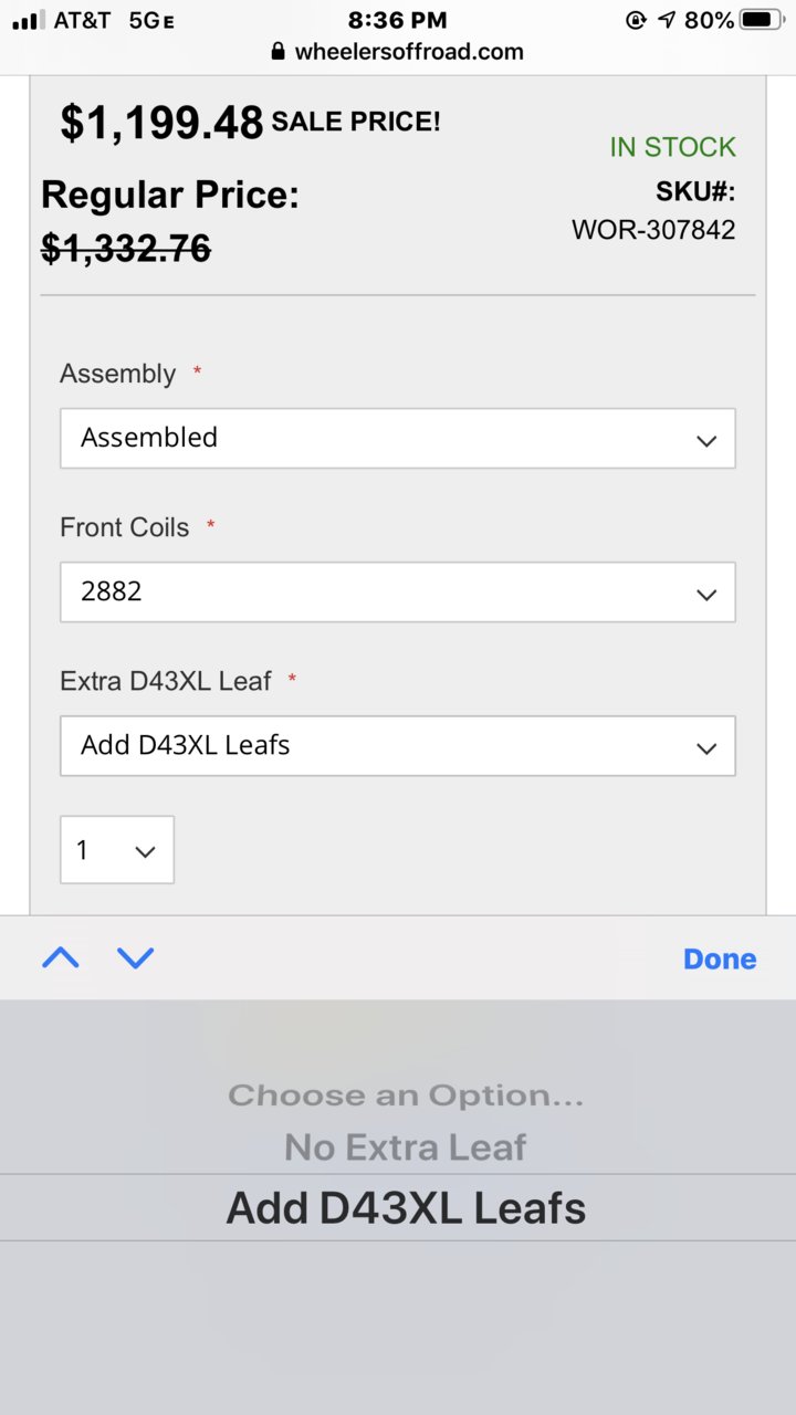

    2001 v6 4WD auto
    HELP. I’m about to buy the OME full set. I want the full leaf set included but is this option that it’s giving the full dakar set or is this just one individual leaf for each side?? I want the lift in the rear so would a single leaf do? I feel like I should replace the leafs entirely since as far as I know they’ve never been replaced. I’m at 265k. The price stays at $1199 whether I include the leaf option ornot. Sale ends tonight so I’m panicking

    881/5100/Dakars 4R wheels / TBU / New frame
    That item includes the Dakar leaf pack for both sides. The option for "With Extra Leaf" or "Without Extra Leaf" is just if you want to include an add-a-leaf. When I'm on the page the kit with the add-a-leaf is $1,239.26, and without it's $1,179.90.

    2001 v6 4WD auto
    Ok that clears up a lot. I guess if there’s no price change then I might as well include it? At least not that I saw. I don’t load the bed a whole lot but I will every now and then and I do plan I’m getting another dirtbike eventually. Maybe my webpage is screwed up cus it doesn’t show a price difference. Weird.

    dents and missing bits, built in the Gravel garage, hillbilly trained mechanic…
    I suspect there is a price change, I think the AAL/pair is somewhere between $50-60. If you add it to the package it comes separate ( from the leaf packs- or at least mine did) but you only end up paying shipping one time.
