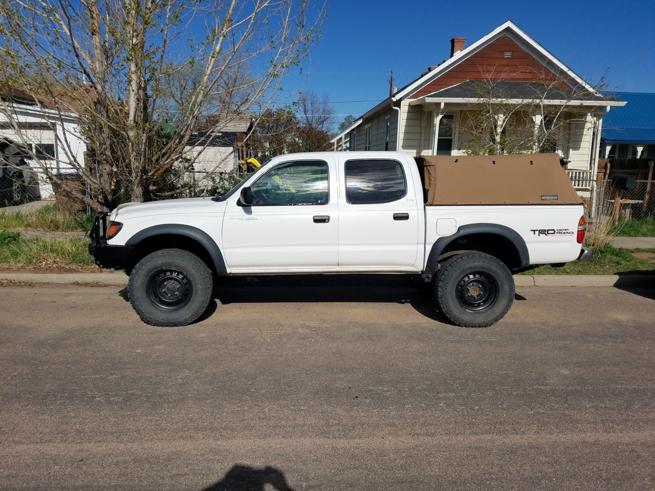

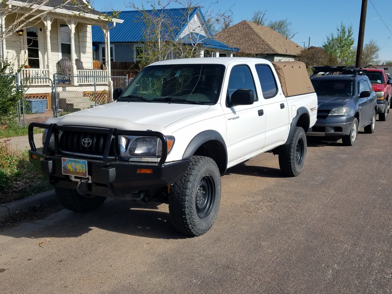

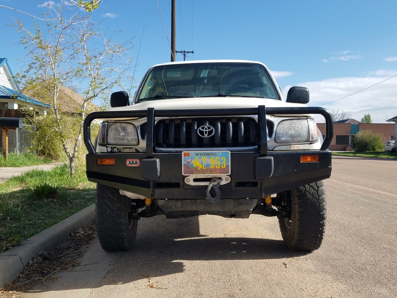

    20200523_084615.jpg 20200523_084604.jpg 20200523_084548.jpg Just put a 2inch OME full kit on my truck. Went with the 881s in the front and new Dakars in the back, with nitro shocks front and back.

    Looks good and I do enjoy seeing those soft toppers. How is the wind noise on the highway with it?
    I see Wyoming plates. Are these pics in Wyoming? Curious to the amount of snow that could be on the ground in that neighborhood? I get snow every 6 years or so here and maybe 1" will stick until the sun gets high noon and the yard becomes a mud hole. Wet snow is not good for working in.

    Yeah I love the soft toppers. It isn't loud on the highway, but my truck isn't exactly quiet to begin with.
    Yep I am in Wyoming. We can get quite a bit of snow each year. No snow on the ground right where I live, but there is still about 5 feet up in the mountains just to the west of me.
