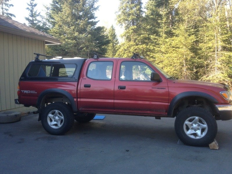

    Nah. Looks close mine when I first lifted. Before it settled of course.
    09FB2F7E-7151-4D7E-9C63-034D790CEE35-264_93e2b7597fd1e1ba4b0540e115b1978d037d743c.jpg
    I'm actually looking for a way to lift the rear more. Even with the AAL with the dakars, I'm not really sitting level. Leaning toward new shackles at this point.

    Hmm that's interesting, maybe because it's a double cab...my extcab doesn't look that high and I have 4inches in the rear and 3&1/4 inch of lift up front

    Except your on 265/75s in that pic and he says he on 285/70/17 tires which are roughly 1.5" taller than your tires.
    I thought the exact same thing when I saw those pictures. Looks really high for 285s.

    Oh whoops. Didn't notice that. They are more like 1" taller so yeah, it is pretty high. 882s are taller than my 883s and he's got a 10mm spacer on top. With no heavy bumper that will sit pretty high.

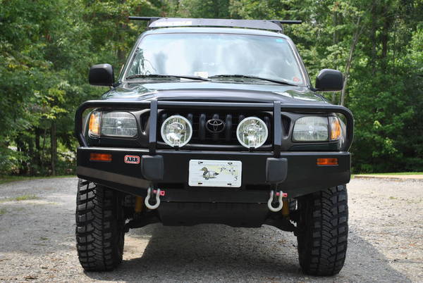

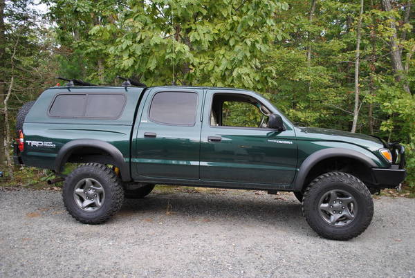

    Same basic shit everybody else had 5 years ago.
    2003 with full OME - 882's, Dakars and AAL and nitrochargers all around. No winch in the front yet and the 882's sat high as expected and of course the weight in the back didn't help, but I need my "stuff".
    Side view with Dakars and AAL. I tried to get away without using the AAL but with the heavy shell, CBI bumper and drawer in the back it was hurting.
    Rear view:
    Front view with 882's and Toytec diff drop, photos a little dark but the angles seem fine:
