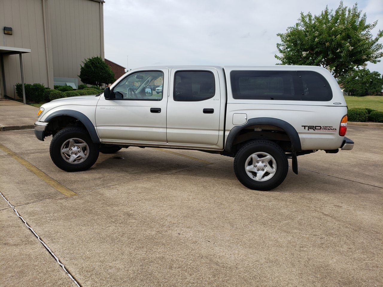

    Is that profile pic current? You running a topper? What's it weigh? Any tire size goals?

    In my profile picture is my truck. Everything is stock the only thing I’ve done to it is added 265/75/R16 Nitto terrain grapplers to them. Makes the truck look a bit beefier. The rear leafs might need to be exchanged but I’m not too sure if it’s a necessity. And it is a 2.7L 4cyl.

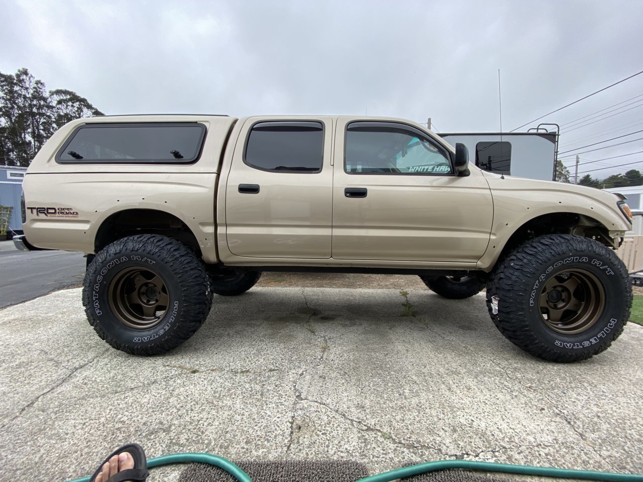

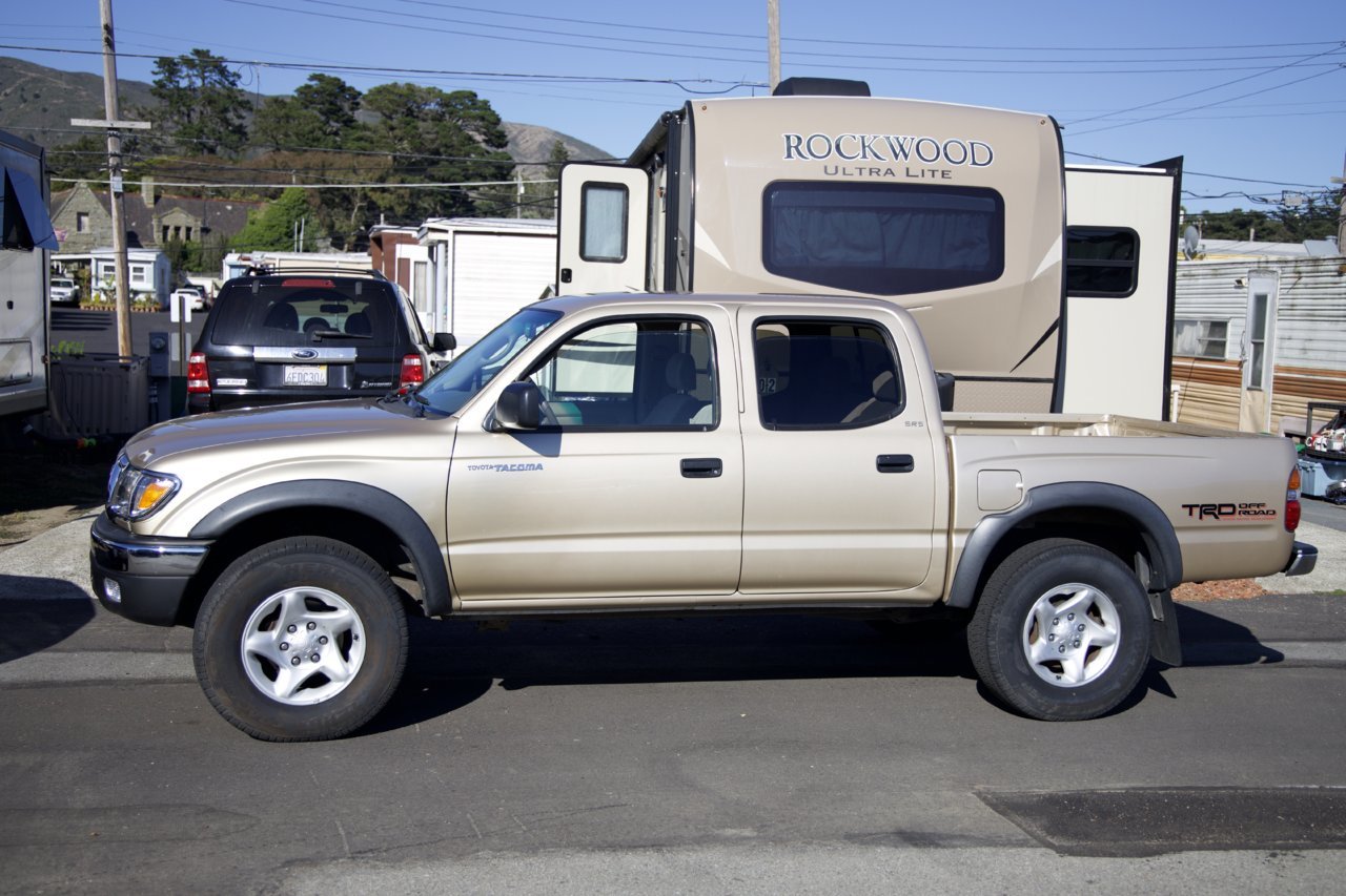

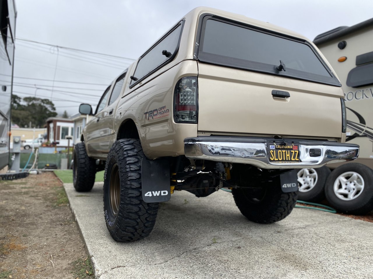

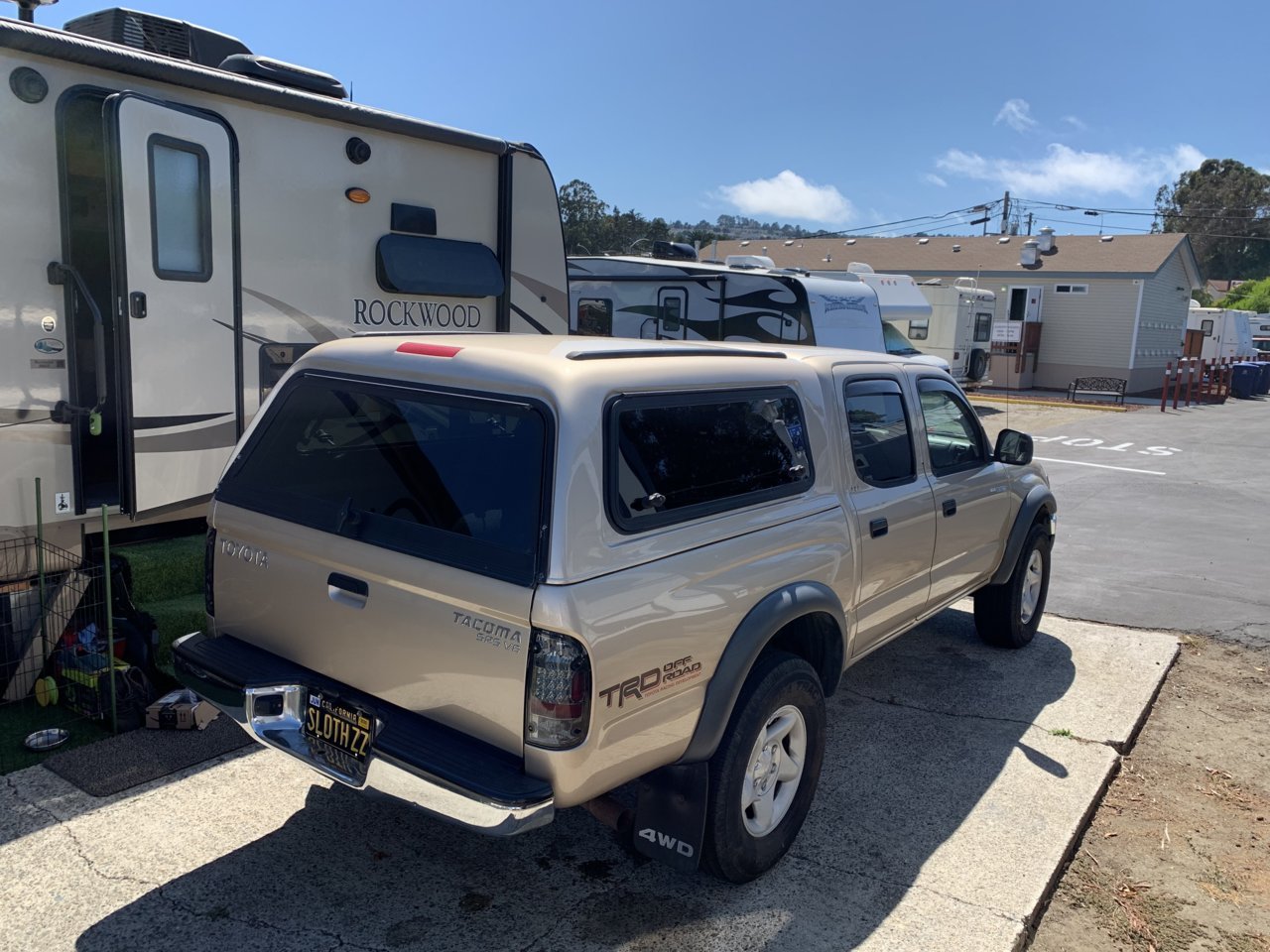

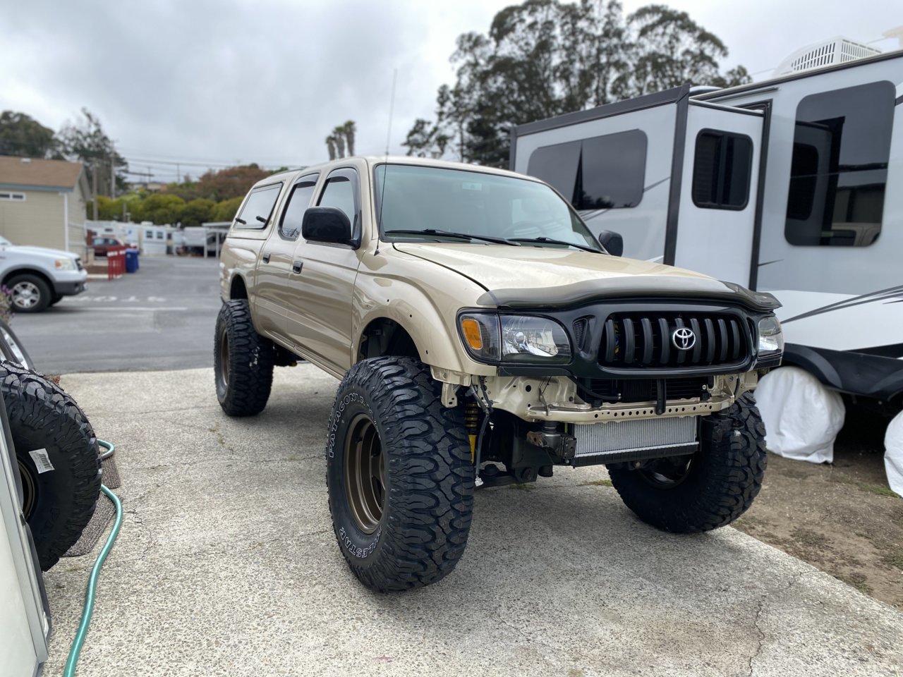

    SPC UCA
    Marlin Crawler Extended Brake Lines
    Whiteline LCA Bushings
    Sitting on 37” Milestar Patagonias mounted to 17x9 Dark Bronze F5s w/ 3.5 BS and -38mm offset.
    Contemplating;
    -Trim packers for the front but the rake isn’t nearly as bad as I thought, I do have about 350 lbs in the back right now though.. want to see how it settles before I make that decision.
    -TC LCAs to push the front wheel forward a bit, I put the body lift on in hopes of not having to tub the firewall as much, and think the Total Choas LCAs may further assist, but they are expensive.. when I pull the fenders and get a better look I’ll make a decision.
    Rubbing:

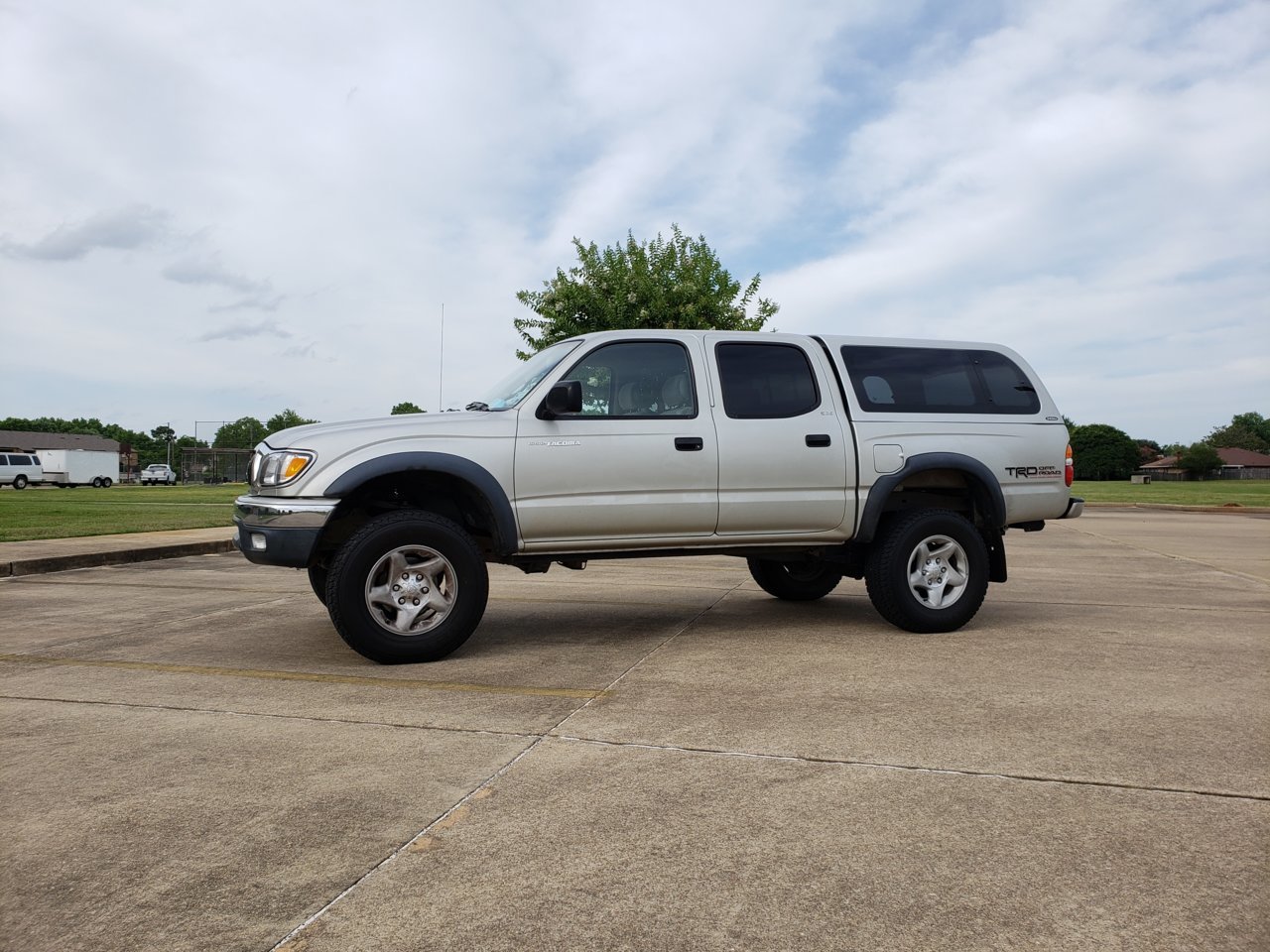

    As of right now, I can basically only roll straight forward and back hahaha. I just sat it down on the new feet to A.) see if it could, and B.) get the stock wheels off for sale. I have A LOT of work to do before I can actually drive this thing with full functionality.
    Measurements - Taken without the fender flares on, from ground to center of the fender arch:
    Before;
    Front Passenger 36.25
    Front Driver 36
    Rear Passenger 36.75
    Rear Driver 37
    After lift, stock tires;
    Front Passenger 39.75
    Front Driver 39.5
    Rear Passenger 41.25
    Rear Driver 41.25
    After new feet and a couple weeks of sitting on the new suspension, with ~300lbs in the bed.
    Front Passenger 42.5
    Front Driver 42.5
    Rear Passenger 43.5
    Rear Driver 43.5
    Sitting really even side to side, with a slight 1” rake on the back, again with a lot of weight in the bed. If the rake doesn’t settle down to the front measurements I’ll add trim packers.
    Before
    0FDE90E4-61FF-4EC1-8CA7-D8DCE019CEB3.jpg D80596F5-05C8-43D7-9ECD-358BE18A2E0E.jpg
    After
    40334FDF-4028-46C5-93CF-3F9D0A53D359.jpg DEB378FD-A196-46C5-958F-4894DDA0C7EC.jpg 8F7659CE-EA1E-48AF-915D-B91C0432CE54.jpg 102FBC91-2596-44FF-A9FD-F62E0491252A.jpg
