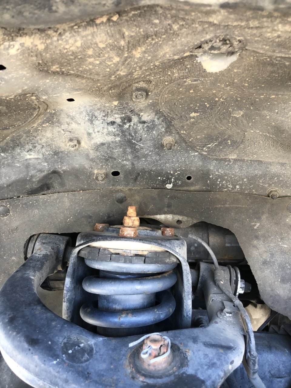

    yeah here’s mine

    That's sketchy AF. These are the preassembled setups? From where?

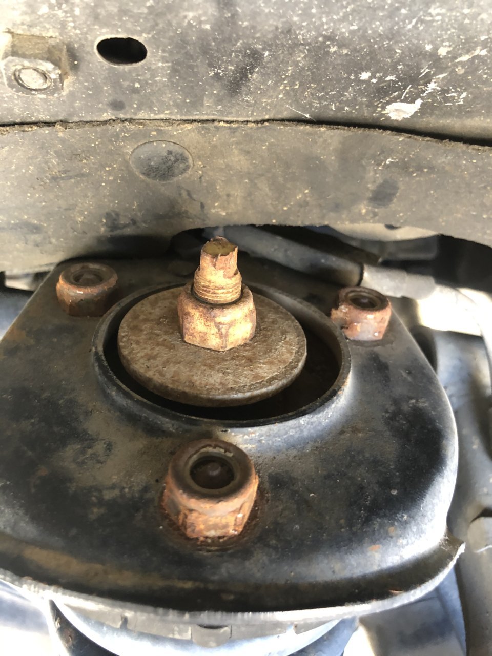

    I got mine from a buddy. I think my issue is due to the taco lean spacer. I’ve been driving it like this for 25k no issues lol. But I’m going to fix it for sure.
    any idea why it would be like this? The other side is perfectly fine.

    it’s because you put a spacer in top of the shock, but did not get extended studs, or a top hat with longer studs.
    This is why spacer lifts have two sets of studs. One in the shock that bolts to the spacer, and one set in the spacer that bolts to the coil bucket in the frame.

    I actually found out its because I'm a dumbass and didn't realize the dude I bought them from already had the coil spacer on the bottom of the coils from OME. So essentially I have 2 spacers right now. So I'm taking one out this weekend.

    Yeah but the spacer in the bottom does not affect the available threads on the top hat studs.

    I have a spacer on the same shock on the top hat too. That I don't need.

    Right. It’s the one on top that is the problem. Should be really simple to remove.

    Yup. I’m honestly just going to unbolt the shock and pull it out.

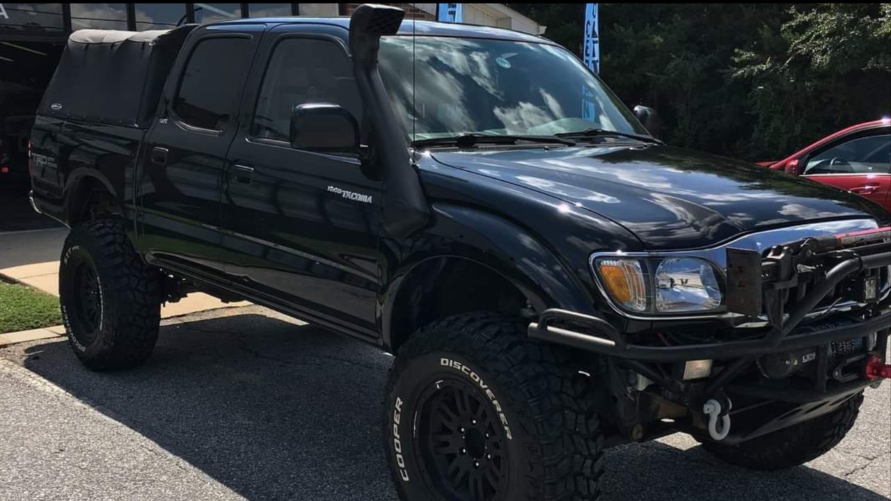

    Weld on sliders, fiberglass shell, 12k winch in an Elite Offroad bumper, front Aussie Lunchbox
    You got a 3/4 front end pic of that? Those skinnys look good on there.
