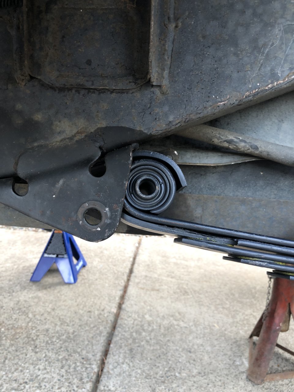

    I’m starting to think wheelers may have sent me the wrong leaf springs because for the life of me I can’t seem to install them. Every video I’ve watched seemed to be so plug and play and installed like a breeze. Are there any install threads of this cus YouTube isn’t helping.

    Does it matter what end of the leaf installs first? The little bolt on the bottom of all the springs that fits into the notch on the axel lines up ok but I’m still about 1.5 inch short from lining up the front bolt.

    And as you can see the rear is nowhere near lining up right. What am I doing wrong?

    It does matter which way the leafs are installed but it looks like youve got them in the right direction. iirc I attached the front eyelet first, then shackles, then the rear eyelet.

    Right I knew I had them facing the right way but wanted to know which side should be done first if it matters. I’ll be trying that tomorrow. Thank you.

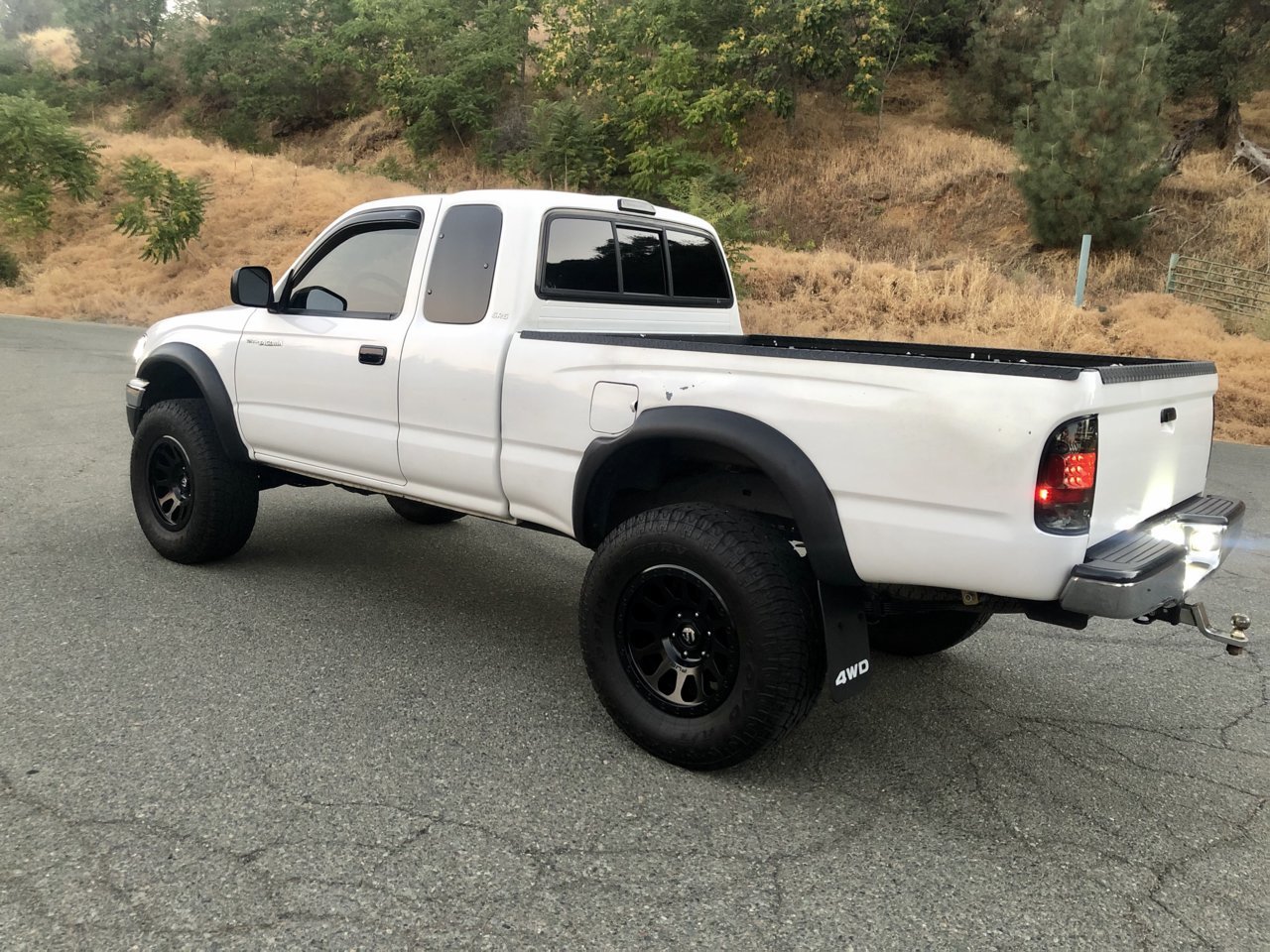

    Mild lift and some tasty bits

    Looks like you need to jack up the truck more to create more of a gap between the truck and axle. I did mine a couple months ago and it took some finagling. You just need to find the sweet spot to where you can line everything up. Be extra careful maneuvering your truck and stay clear from underneath it because if it falls theres nothing to stop the frame and body from going all the way to the ground.

    There is a centering pin on the bottom of the leaf set. That will insert into a hole on top of the axle mounting plate. That should put the axle close to where it needs to be. On my passenger side I had to use a ratchet strap to pull the axle forward a little bit to get the front eyelet bolt in. Just make sure that centering pin stays in the mounting bracket hole when its all said and done.

    You'll need the truck to be pretty high up to stop the axle from interfering with the install.
    Attach the front portion of the leaf springs to the frame first. Do Both Sides of the truck at the same time.
    Attach the rear shackles to the leaf springs next, leave the bolts loose until the end.
    Your axle is off center because it shifted during the process, happens all the time.
    After the springs are bolted loosely to the frame and shackles, manhandle that axle until it lines up with the spring bolt and the axle perch center hole. Your shocks should be disconnected, if not, remove them until the end.
    GENTLY lower the truck to help seat the springs, and install the U-bolts.
    After it's all bolted up, remove the jacks and start tightening everything up. Install the shocks at this point too.

    If you still have trouble after doing everything that Deathbysnusnu says, try disconnecting the drive shaft. I just installed some Dakars and once I did that the axle moved around WAY EASIER and allowed bolting everything up.

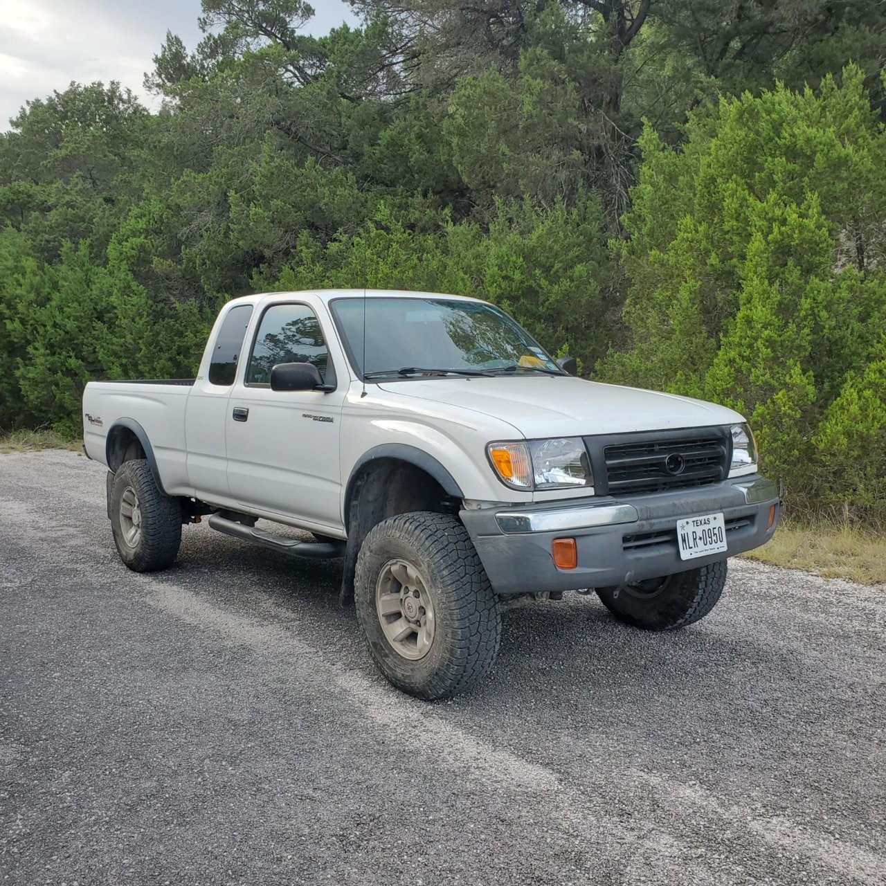

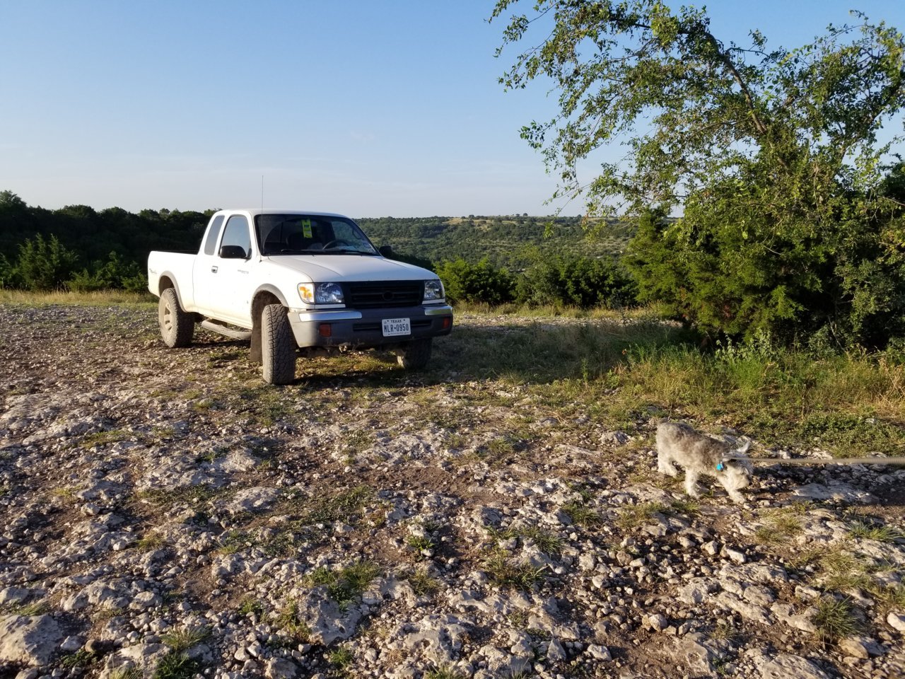

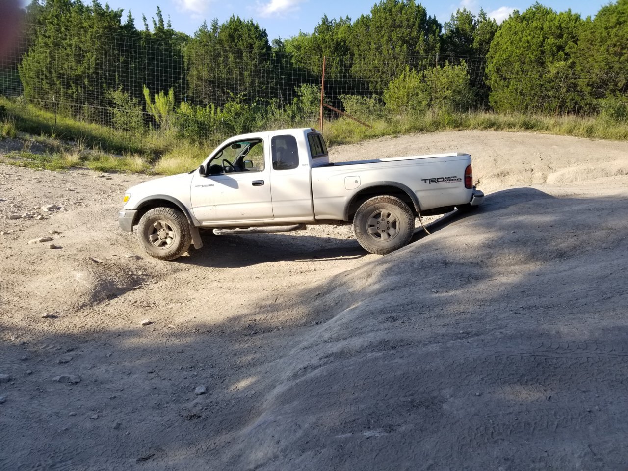

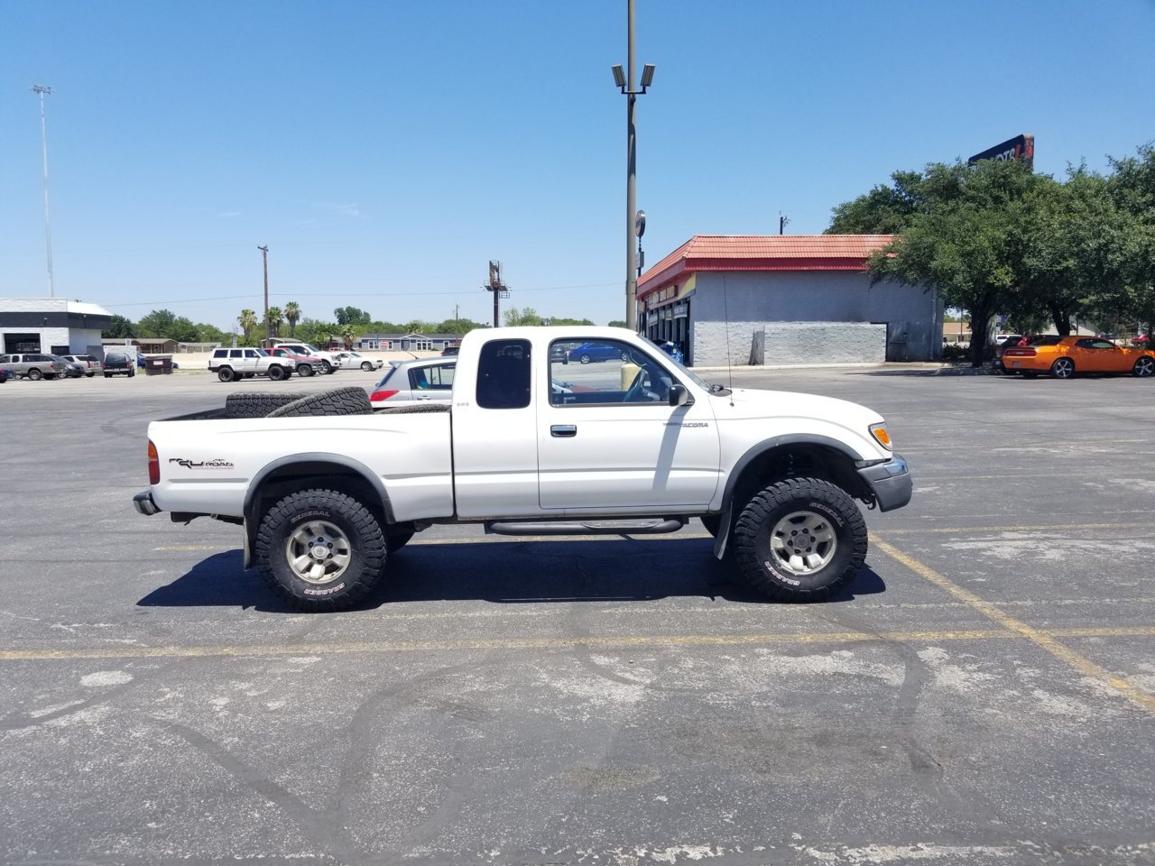

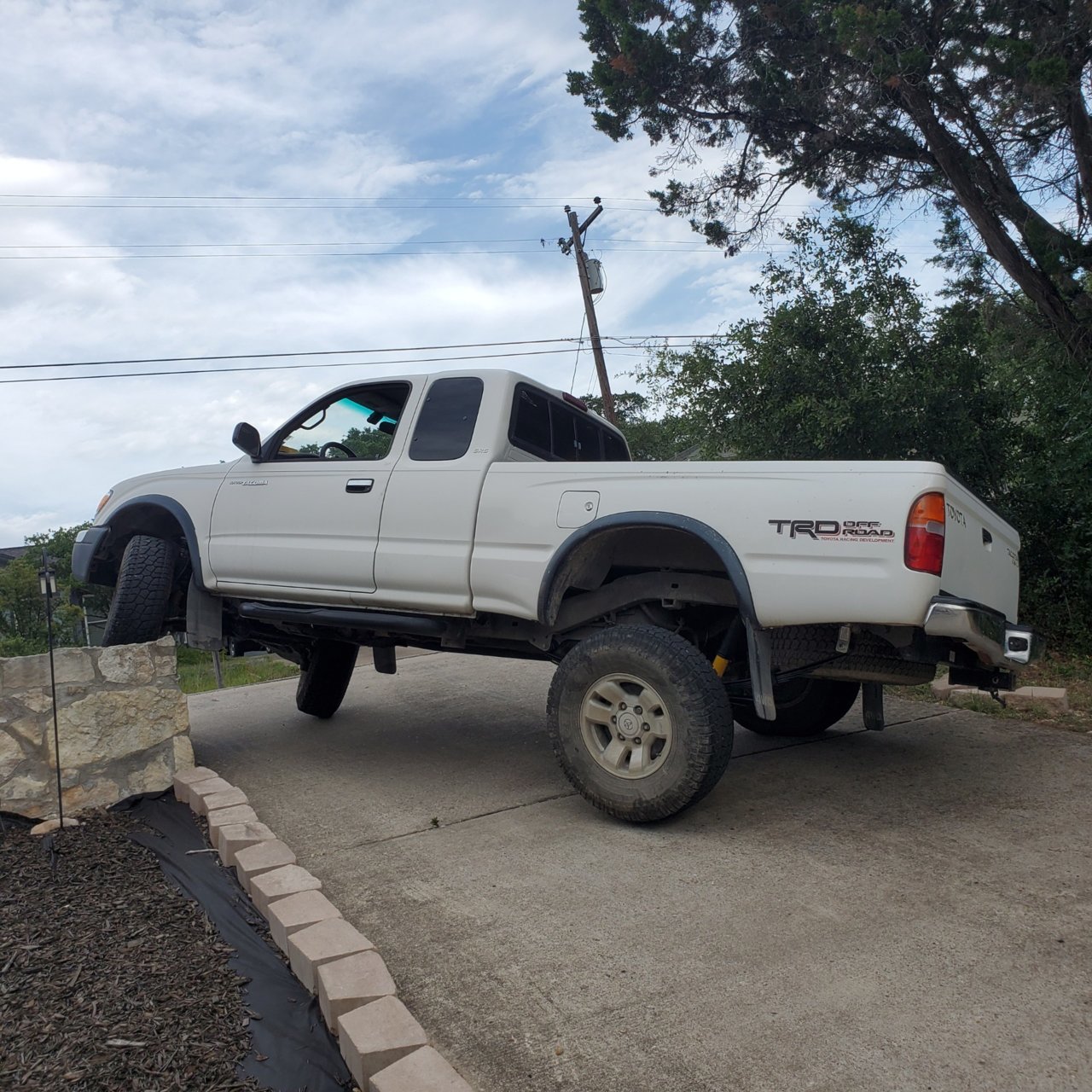

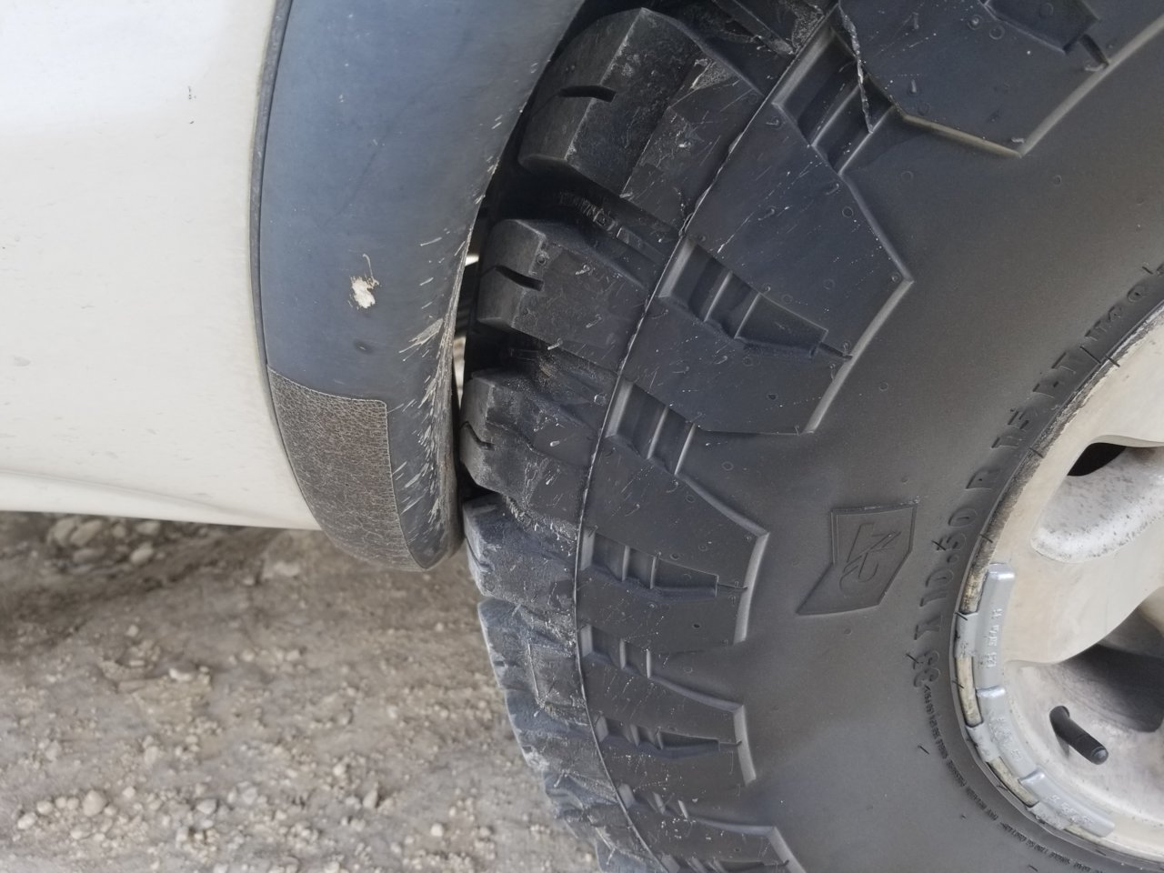

    There are two pictures before, two pictures after with teh stock tire size (31x10.5r15), and then two pics with 33x10.5r15 General Grabber X3s.
    Surprisingly I get tire rub on the back wheel well under full flex, even though everything I read said that I should not rub at all with this 3 inch lift and 33x10.5 tires. I get zero rub on the front, even under full flex when offroading, so it was very odd to see my tires on both driver and passenger side rub on the back wheel well when at full flex. It wouldn't be so bad if it weren't for a bolt that sticks out to hold the plastic trim, as that is what the tire is mostly getting hung up on. You can see where it is rubbing in the very last picture.
