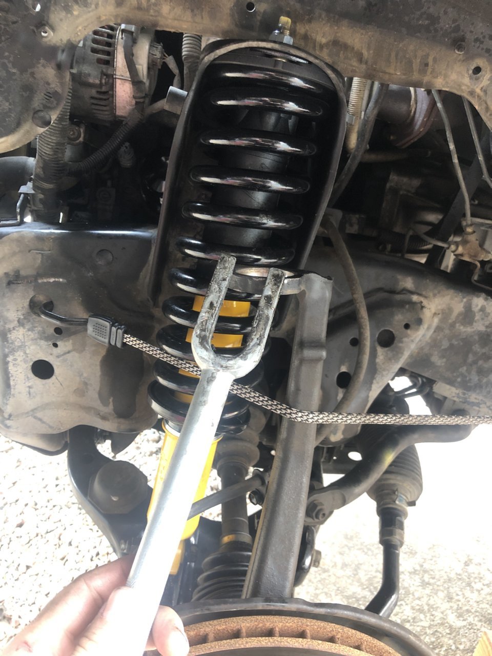

    The LBJ is held on with 3 bolts to the LCA. To get more freedom to work on the UBJ you could just unbolt the lower. If you drive it out with a pickle fork you'll need to replace it. If you're replacing the UBJ, how are you doing it without a press?

    Ya I’m putting in SPCs and they come with UBJs. I’m using this guy and a hammer sledge. So if I’m using a pickle fork To remove UBJ do I need to replace LBJ??
    The ball joint tools I got from Napa weren’t really helping as in nothing fits to the steering knuckle to press it out. Only thing I could try was pressing on the ball joint bolt itself and I wasn’t going anywhere with that.

    Those are best done with a press of some kind. I drove one out with heat and a hammer once but when putting the new one in I ended up splitting the eye. Had to find a used one and then I took it to a shop. I've since bought the medium press from Harbor Freight and it's paid for itself in time, gas, and especially paying a shop to press something for me.
