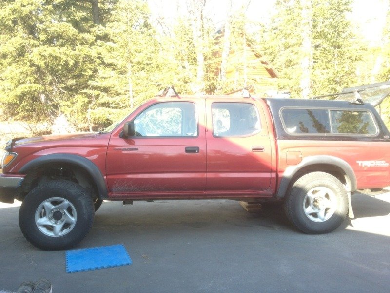

  19. Oct 31, 2013 at 11:28 PM
    #479
    ffirg
    ffirg Well-Known Member
    Jun 9, 2011
    #57975
    4,876
    mike
    Anchorage, Alaska
    2002 Tacoma SR5 TRD 4X4
    Yeah you should see more in the back it seems.
    Here's 883s in the front before doing dakars.
    0749DB59-B32E-486E-9FA6-307B3BB5D436-236_04242fb946034881dfb4906ba3da5a21e20bdfe1.jpg
    And with the dakars and AAL. That's with no spare on yet right after I installed them. So it has settled and the rear is level/slightly lower than the front.
    09FB2F7E-7151-4D7E-9C63-034D790CEE35-264_93e2b7597fd1e1ba4b0540e115b1978d037d743c.jpg
