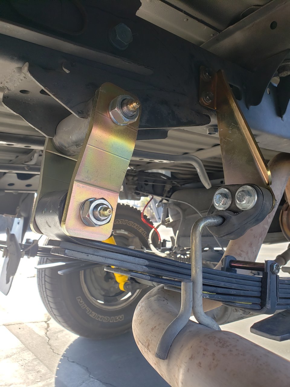

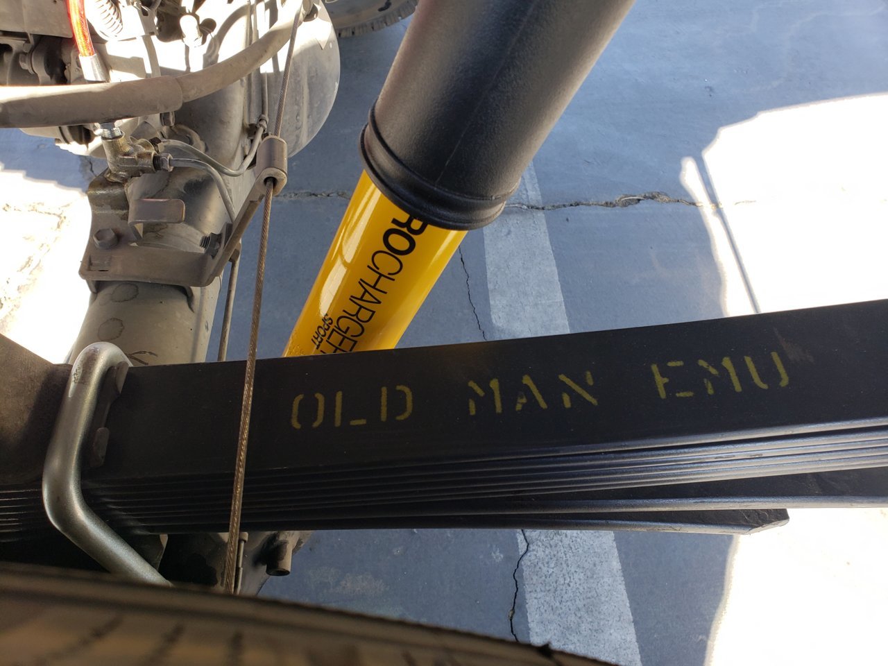

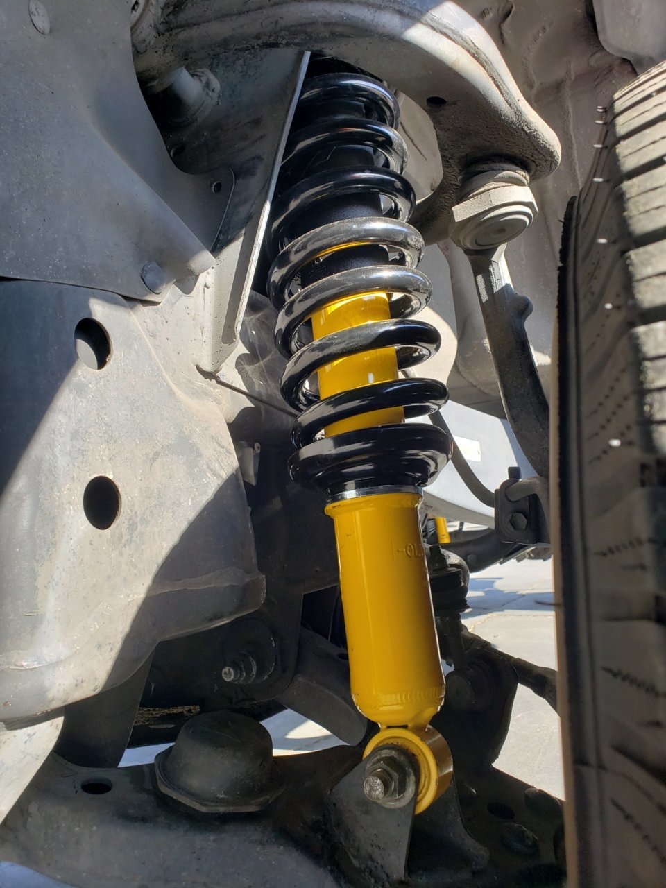

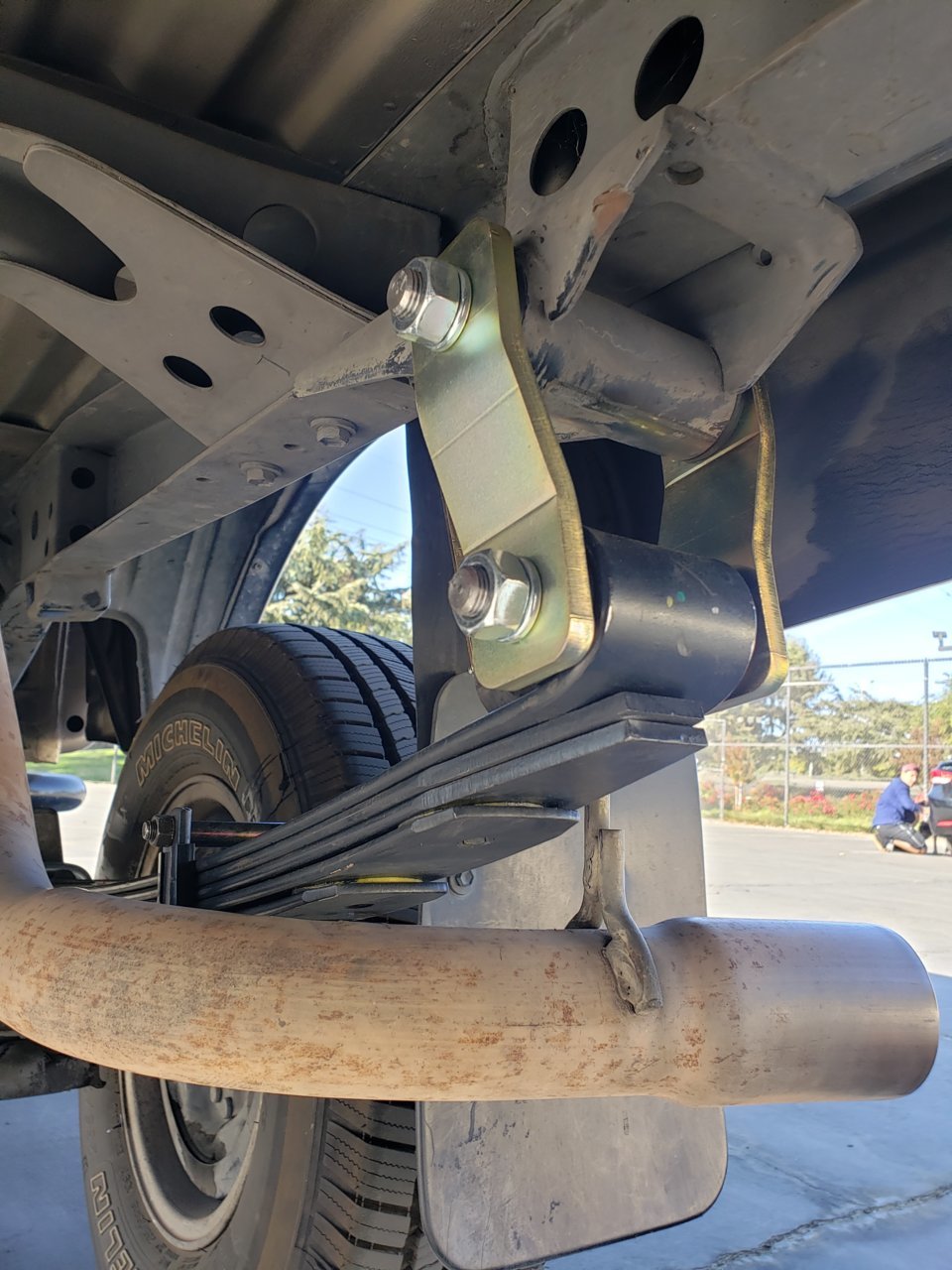

    Quick question: I installed my OME kit last night. Instructions said to grease the shackle bushing prior to installation but I didn't have the grease with me and went ahead and installed it anyway thinking I could grease them later since they have the zirc fittings. Should I be concerned that I didn't grease before install?
    Kit installed included:
    Nitrochargers all around
    883s
    Dakar leaves w/ aal
    Wheelers leaf bushings
    Extended rear brake line
    Exhaust drop kit
    Spacer on drivers side for taco lean
    OME greasable shackles
    Hamer95USA likes this.
  5. Nov 8, 2020 at 9:45 PM
    #4785
    Logans2001
    Logans2001 What’s crackin’
    Jan 23, 2016
    #175792
    1,970
    San Diego, CA
    2001 v6 4WD auto
    I think you should be fine. Just pump them until grease comes out. Maybe someone else has had a similar experience here..
    matches3215[QUOTED] likes this.

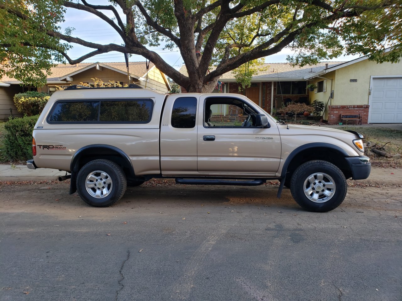

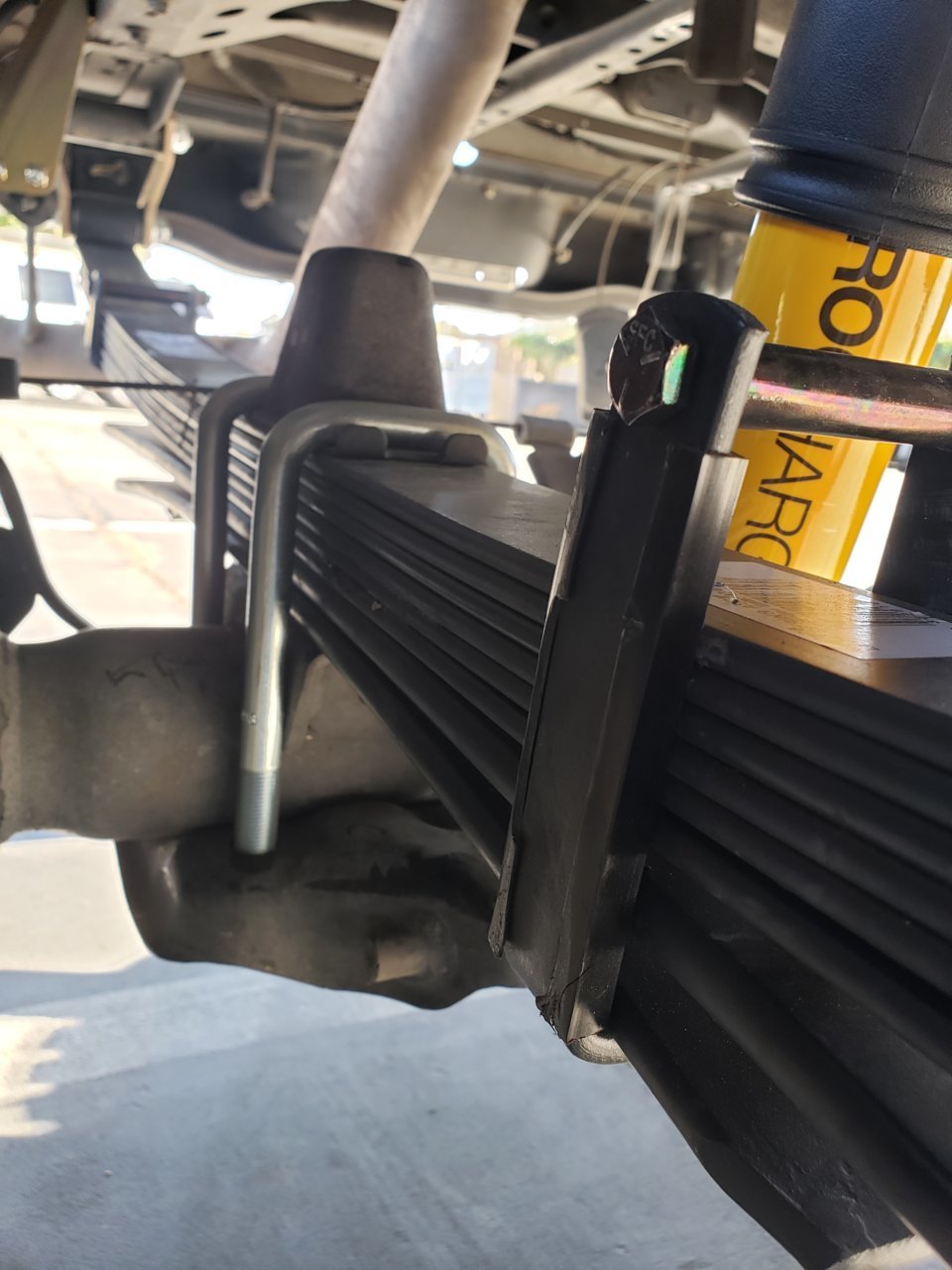

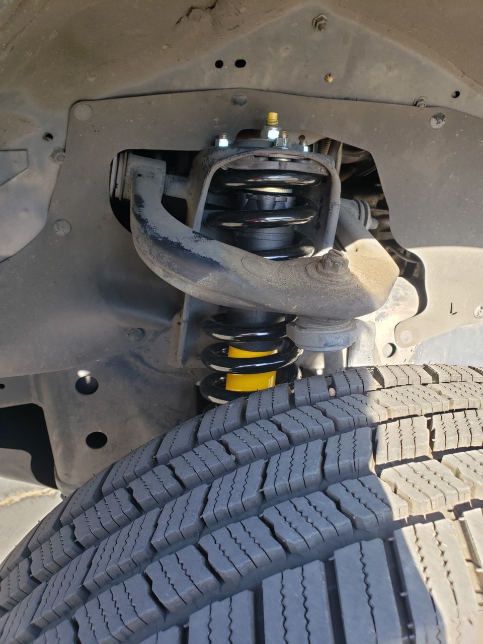

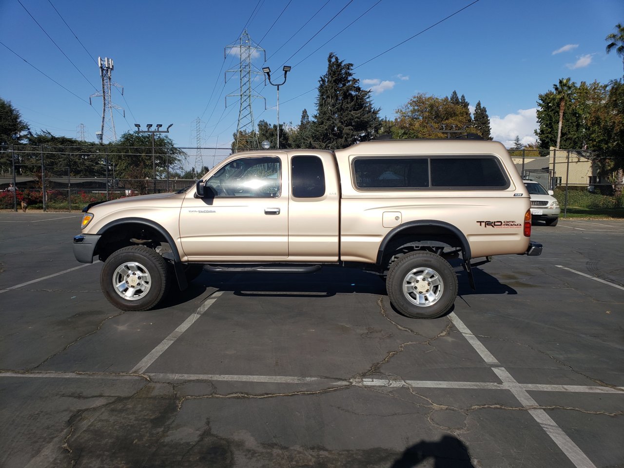

    Pics of said lift. I already know I need larger tires. Those will be up next.
    nicholst90, NvrSyNvr and Hamer95USA like this.

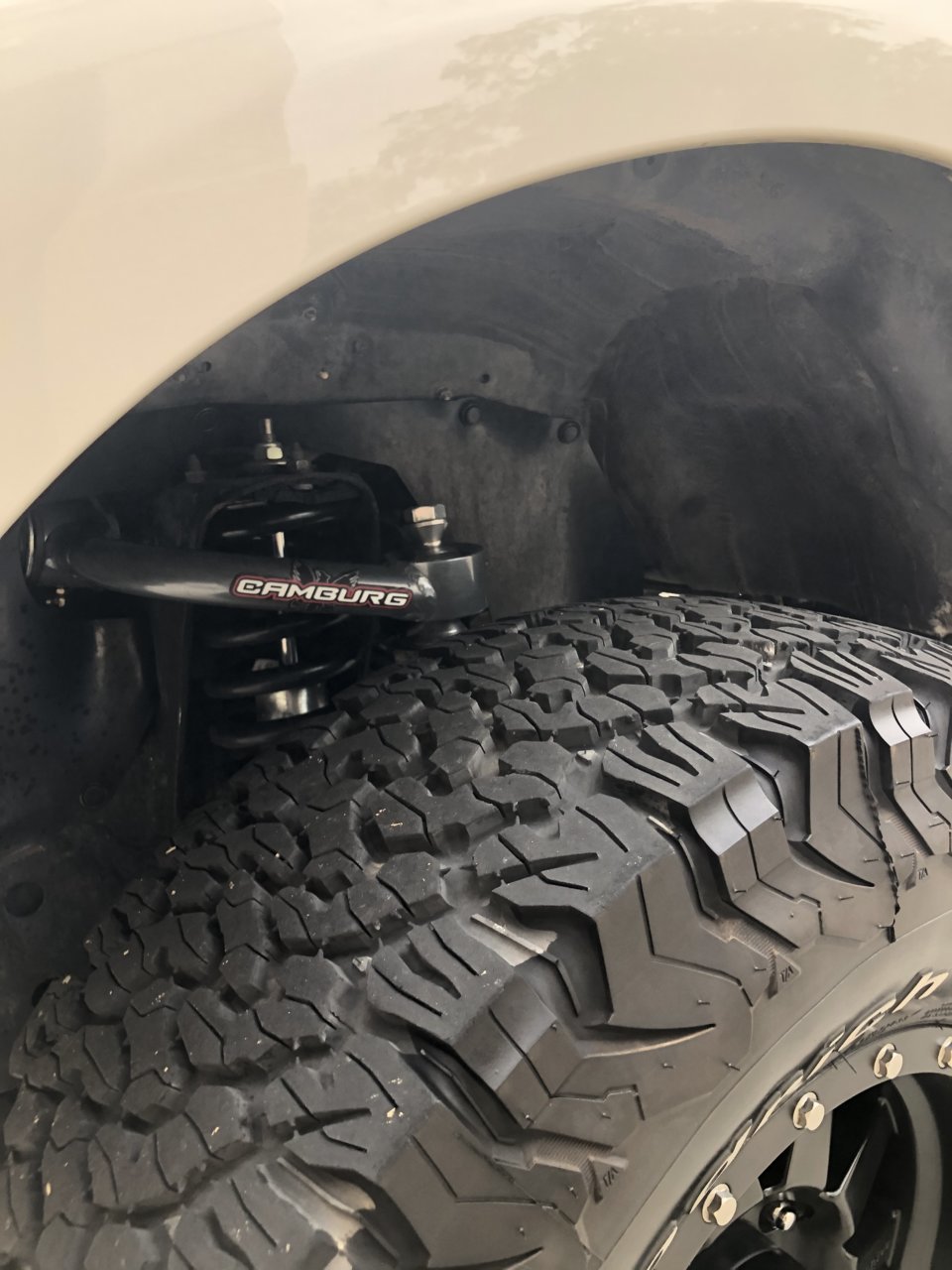

    Custom Interior, Aftermarket Audio, leveled (32/11.5 BFG AT's, Method Standards), Performance Intake

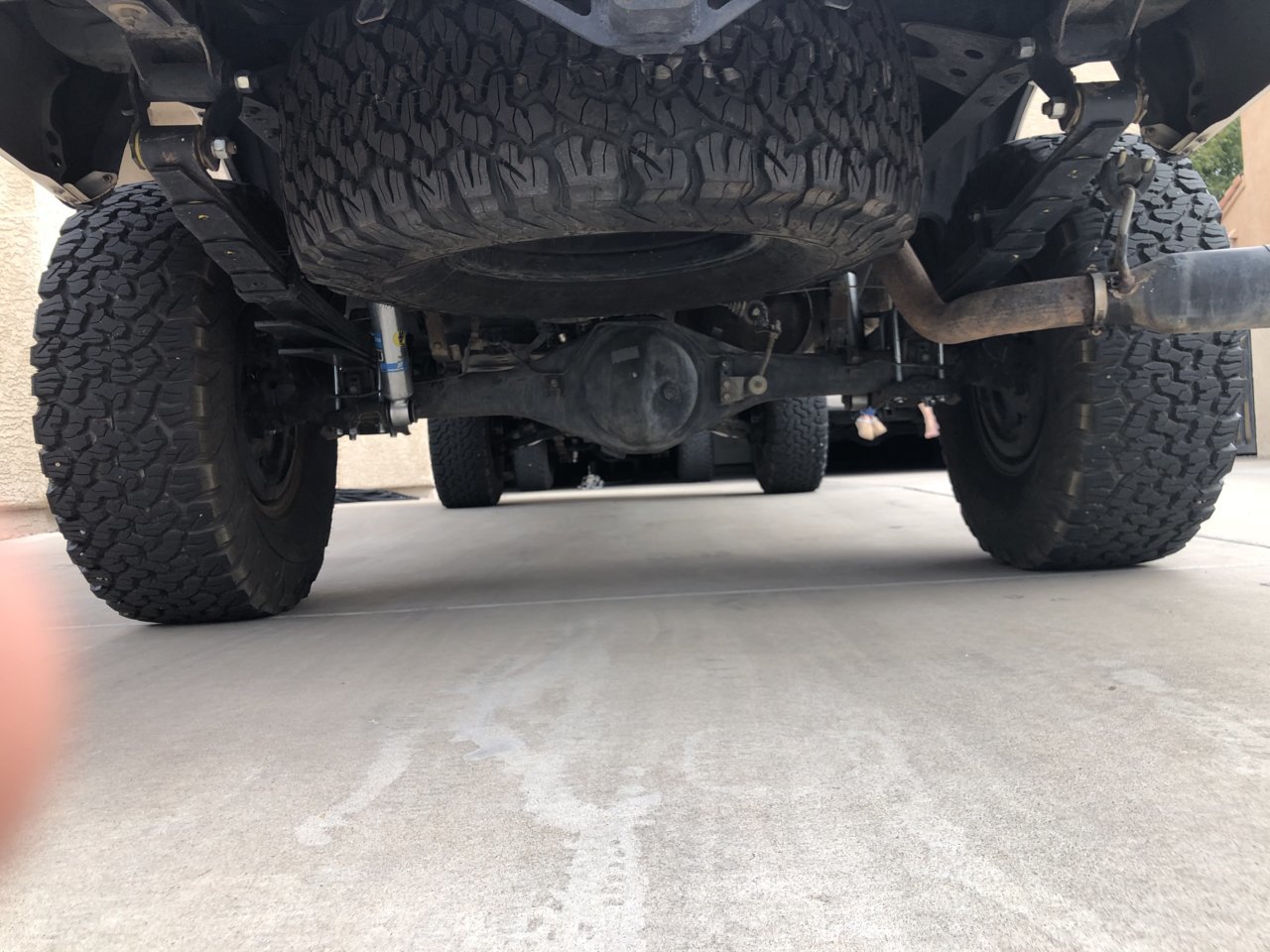

    9C26D9A5-4465-488B-B4E0-6C01A3DF63F2.jpg 64EC00BB-6FE4-4C09-88ED-F77DD735E51A.jpg Went with OME leaf springs and coils paired with Bilstein 5100’s and Camburg!
    matches3215 likes this.

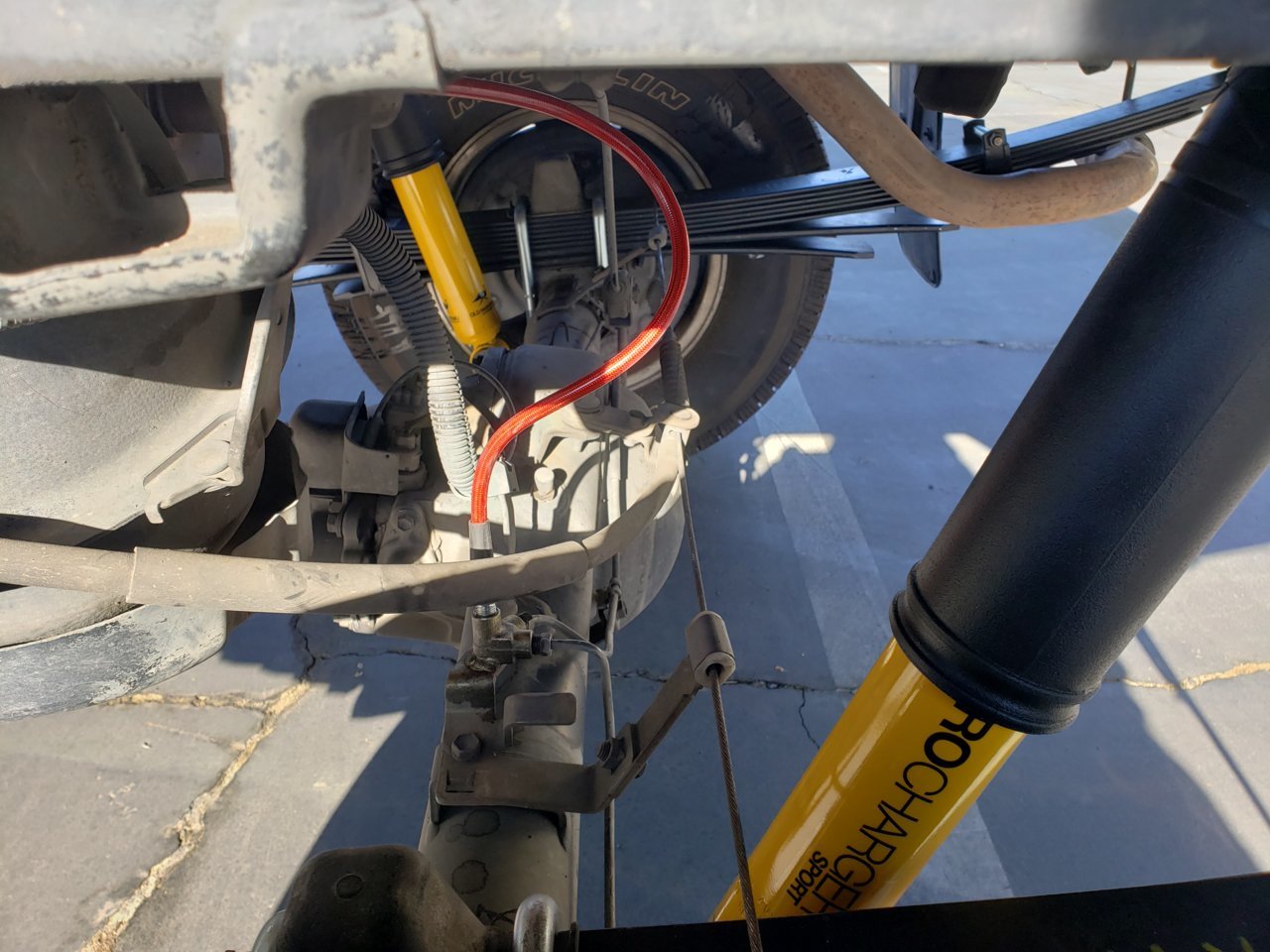

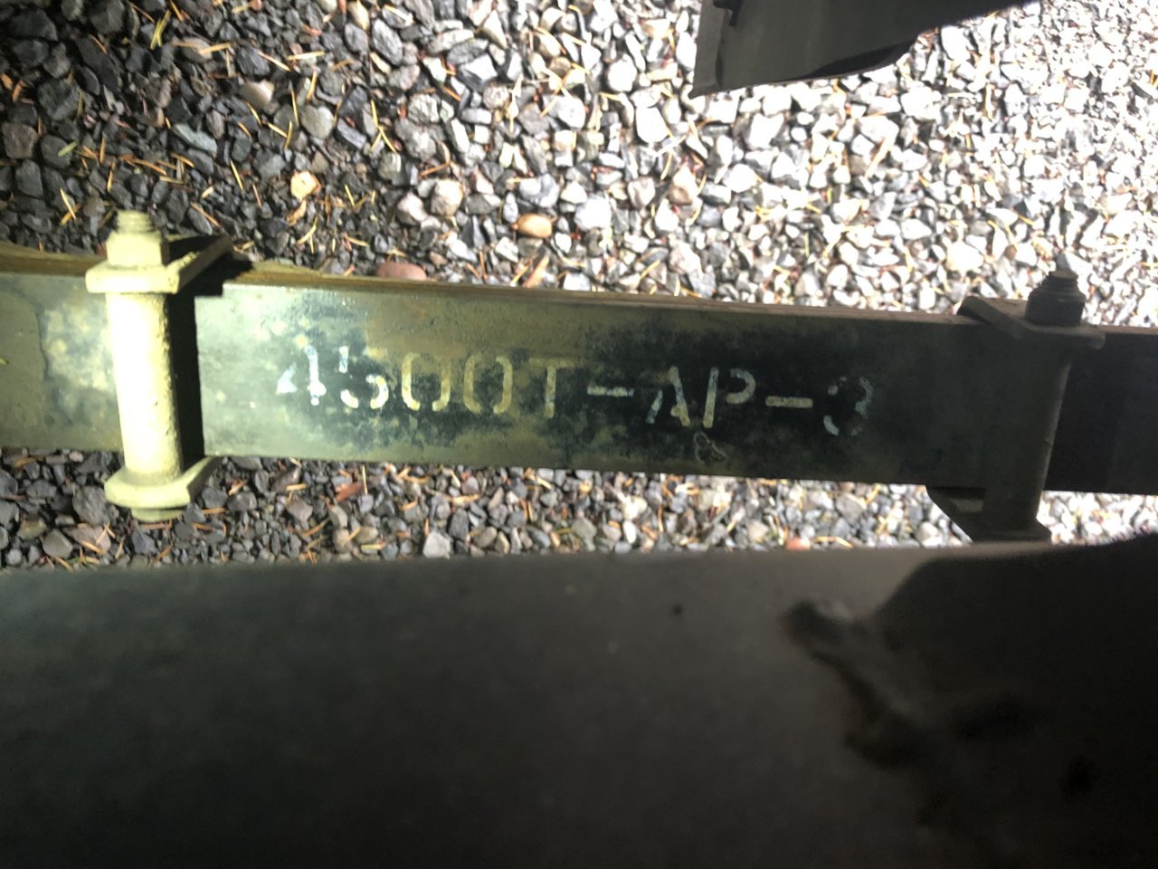

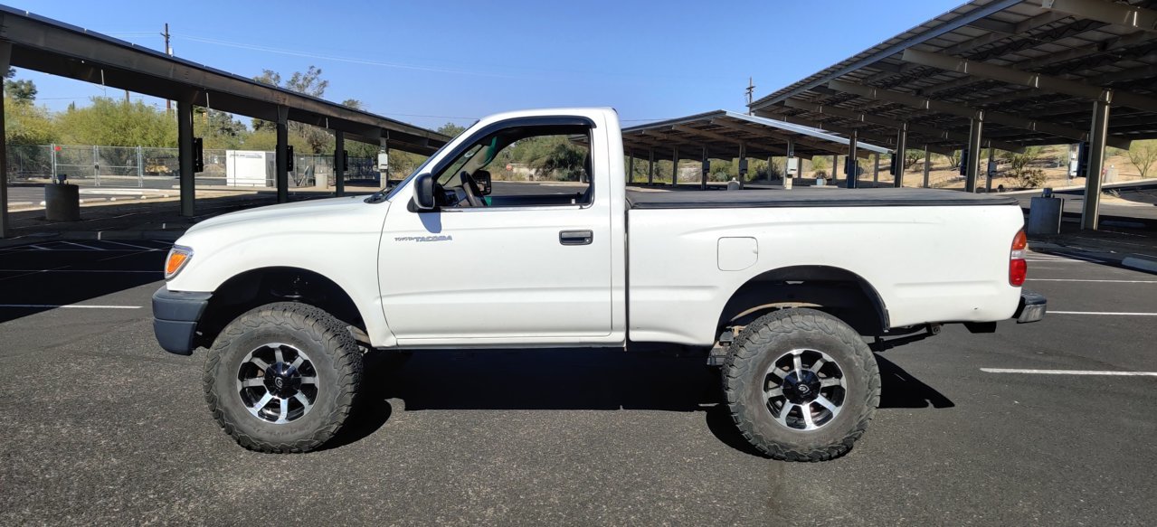

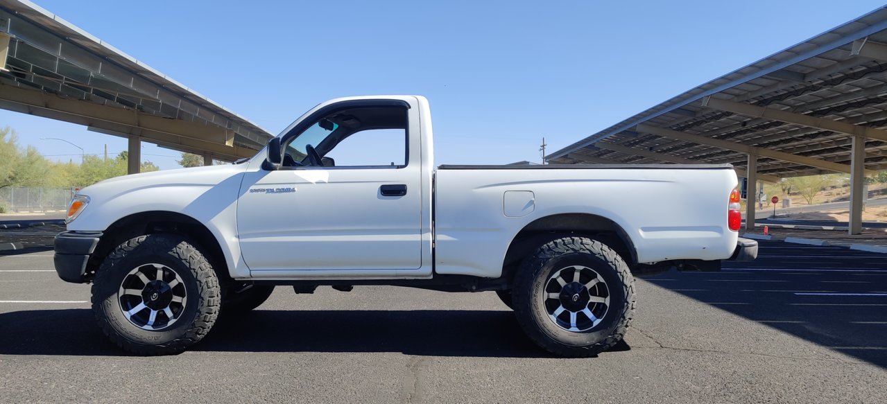

    Been hunting and hauling more weight in the back. With the canopy and gear I’d like to have less sag. It came with OME nitrocharger sport. These are the springs. Are they Allpro? Do they sell AAl for these or should I just replace with the Dakar’s with AAL? The first picture is with no load, only canopy. 52459AE2-9995-4CC6-AFF5-B7D77F1715D0.jpg0A5E51B3-72D2-4DFF-88B2-4EC7695AE020.jpg
  12. Nov 15, 2020 at 3:51 PM
    #4792
    Brake Weight
    Brake Weight But it hasn't rained in weeks...I'll make it.
    Jan 27, 2015
    #147363
    2,872
    Deep South near the Third Coast
    Taco pulling 33s and a B6 pushing 33psi
    Weld on sliders, fiberglass shell, 12k winch in an Elite Offroad bumper, front Aussie Lunchbox
    If you can swing it go with the Dakars. Count the leaves of what you’ve got and compare them to what you may want. I replaced the OEM set with a Wheeler’s set that ended up sagging after nearly 10 years. So they held up well to a fiberglass topper and hauling 2-300# of gear all the time. I bought new leaf bolts and split the old packs and newer packs to make a pack. Removing the overload from the equation and was able to add two additional leaves per side. It definitely carries a load better and still has a fair amount of flex offroad.

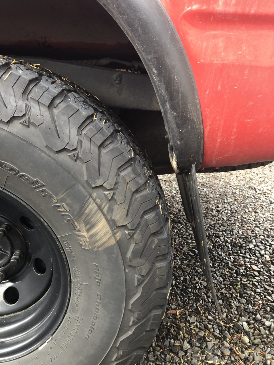

    Noticed you have tire size im looking to get. Mind sharing your suspension setup? Also it looks like your mudflaps are further back?
