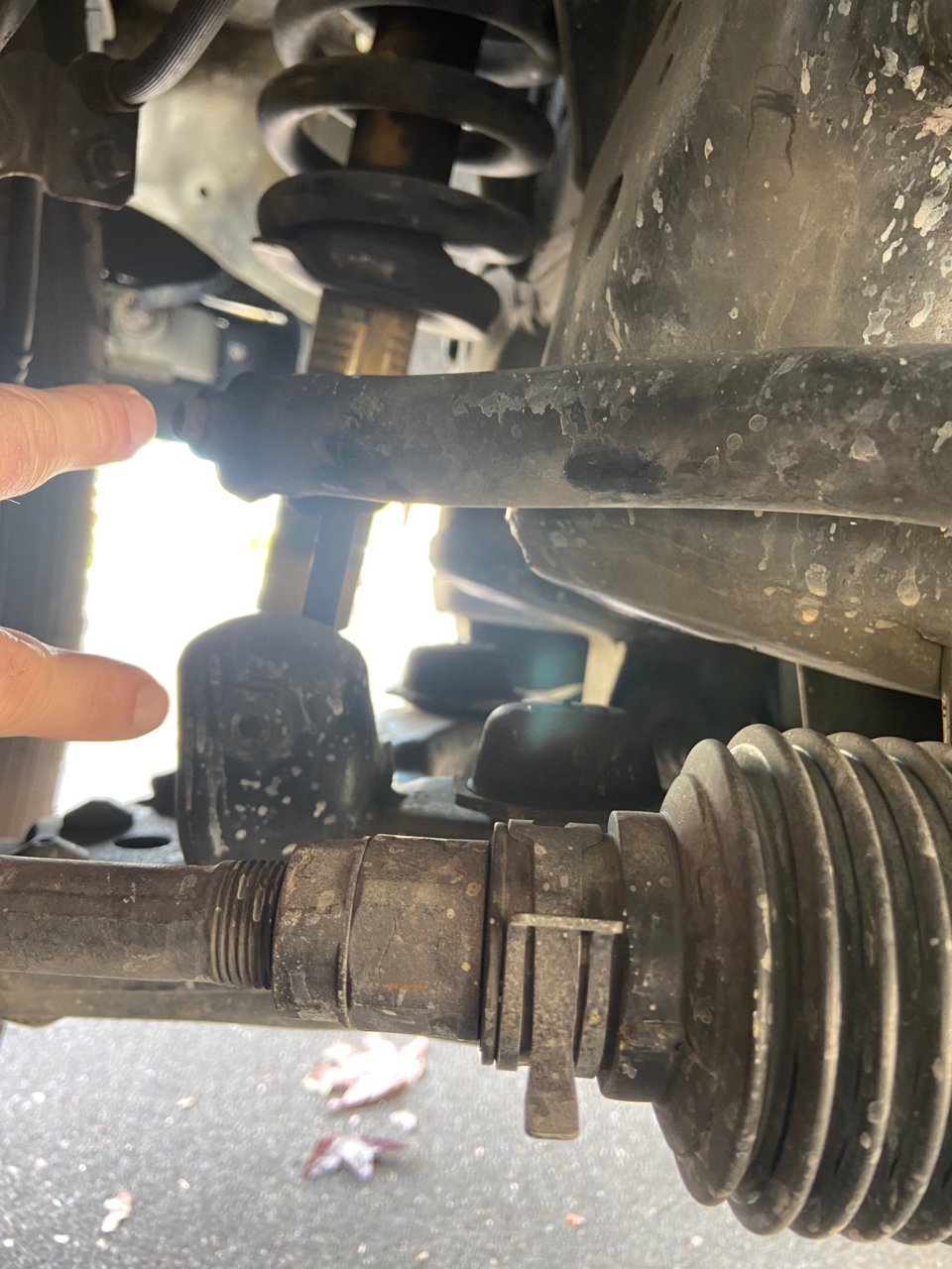

    I have this on the drivers side. What’s it for?

    is drivers side all I need? They said it’s recommended to combat drivers side lean. Not sure what it all means. But I have one on my drivers front shock.
    gonna try to do the rears and fronts again today

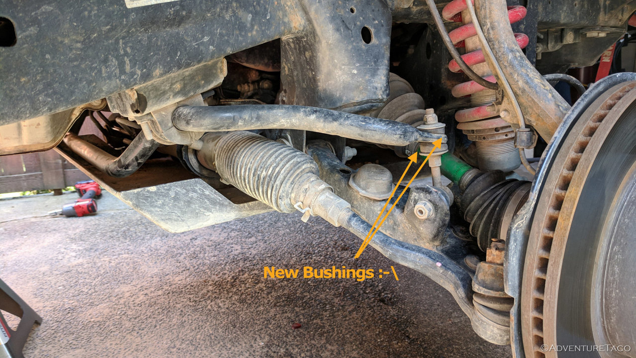

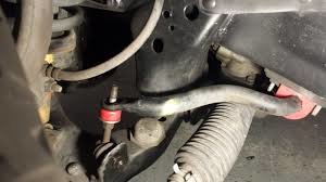

    I've attached some images of the sway bar link if your not sure about what to disconnect. Its a thick (about 3/4") solid bar with a flattened end with a hole in it. The bolt that goes through that hole is the link.
    Below the bushings you'll notice that there are some flat sides on the link. Put a wrench on that sucker and hold it on place while you take the nut off the top. Otherwise you'll be Appling torque on the baby joint at the bottom of the link and that's no good.

    Better yet, the bolt that has the allen-keyed hole in it.
    10 seconds to zip both sides off as mentioned.

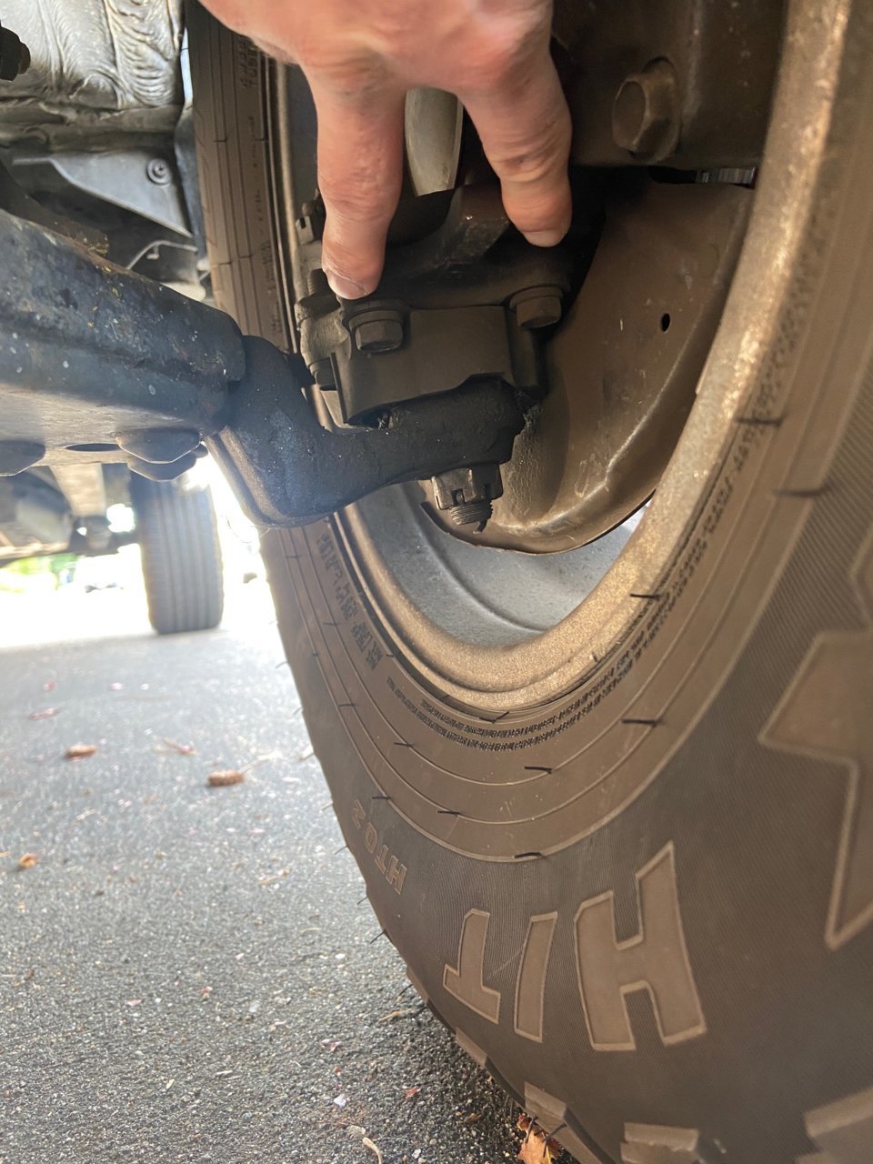

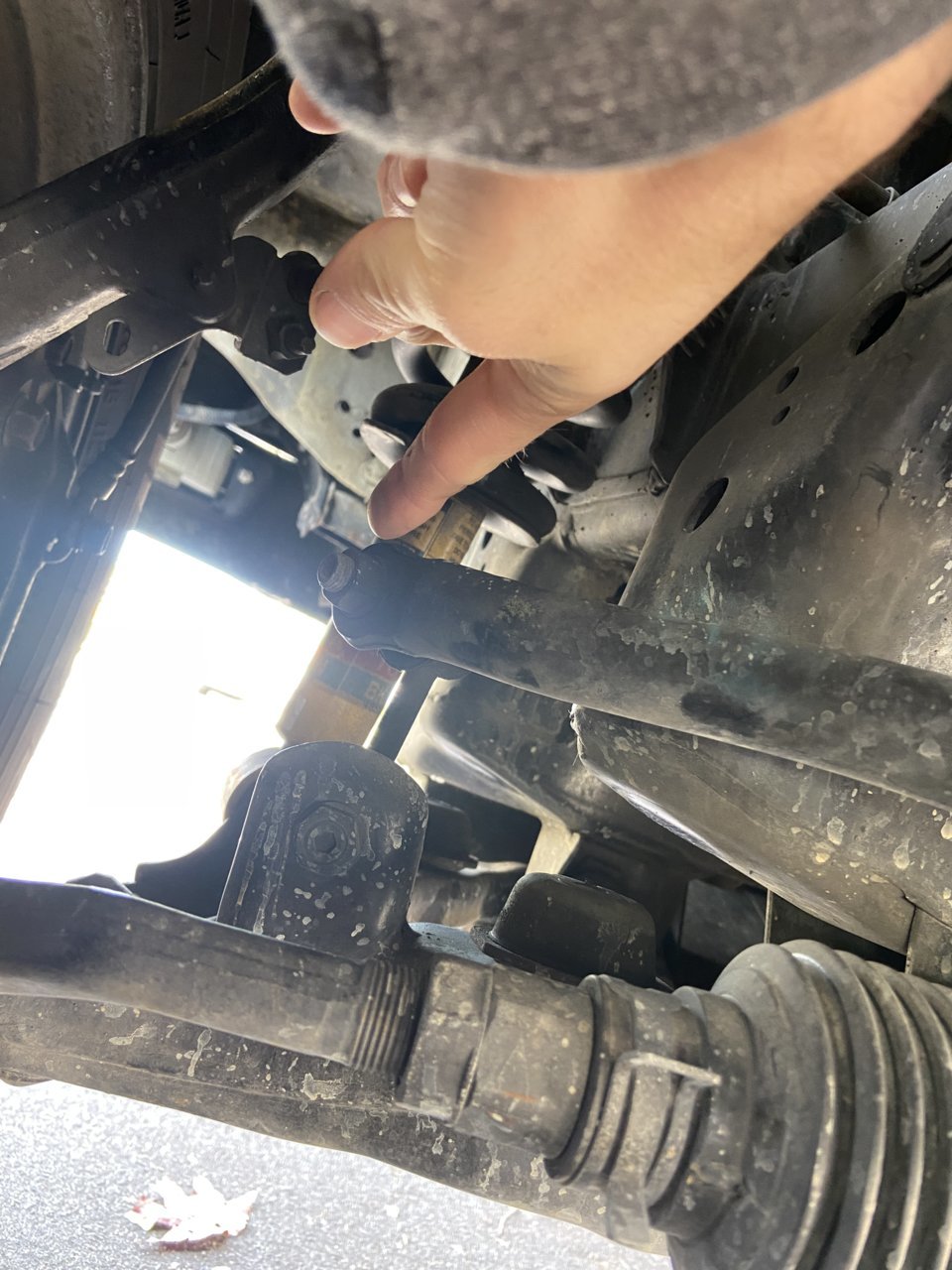

    Which bolt am I aiming for?
    Here's a pic of ball joint to steering knuckle. Which bolts am I dissasembling, two closest to the car or all four? I tried undoing the cotter pin/nut but the knuckle didn't budge. Seems like sway bar disconnect would be easier
    EDIT: Looks like I found a video here
    https://www.youtube.com/watch?v=qaQCb894F_M

    My last piece of advice in order to help prevent you from doing 10 times more work than is required.
    DO NOT undo your lower ball joint bolts that connect to your spindle.
    This is a completely unnecessary procedure at all for simply installing coilovers.
    Stated in two different threads, not to mention shown in the picture posted by another member, simply undo the bolt that has an allen keyed hole. This is the sway bar end link, and undoing it will relieve tension on your suspension.
    This should allow the necessary droop needed to install your coilover.
    If all else fails, including the bottle jack method, simply loosen your cam bolts on your lower control arm.
    You are proposing to do more work than required.
