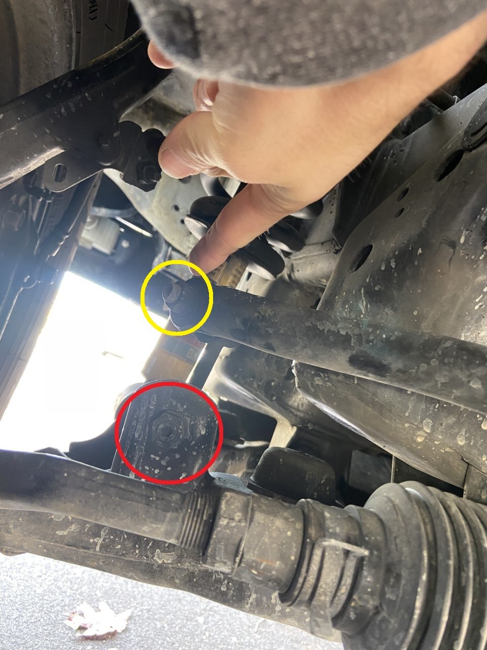

    I'm referring to the bolt in red.
    Undoing the one in yellow will give you the same result, but found it harder to get an impact on there.
    It will allow the assembly to move further down, yes.
    Downward movement is what you need in order to get your LCA to line up with your coilover, correct.
    The sway bar being connected limits your downward movement.

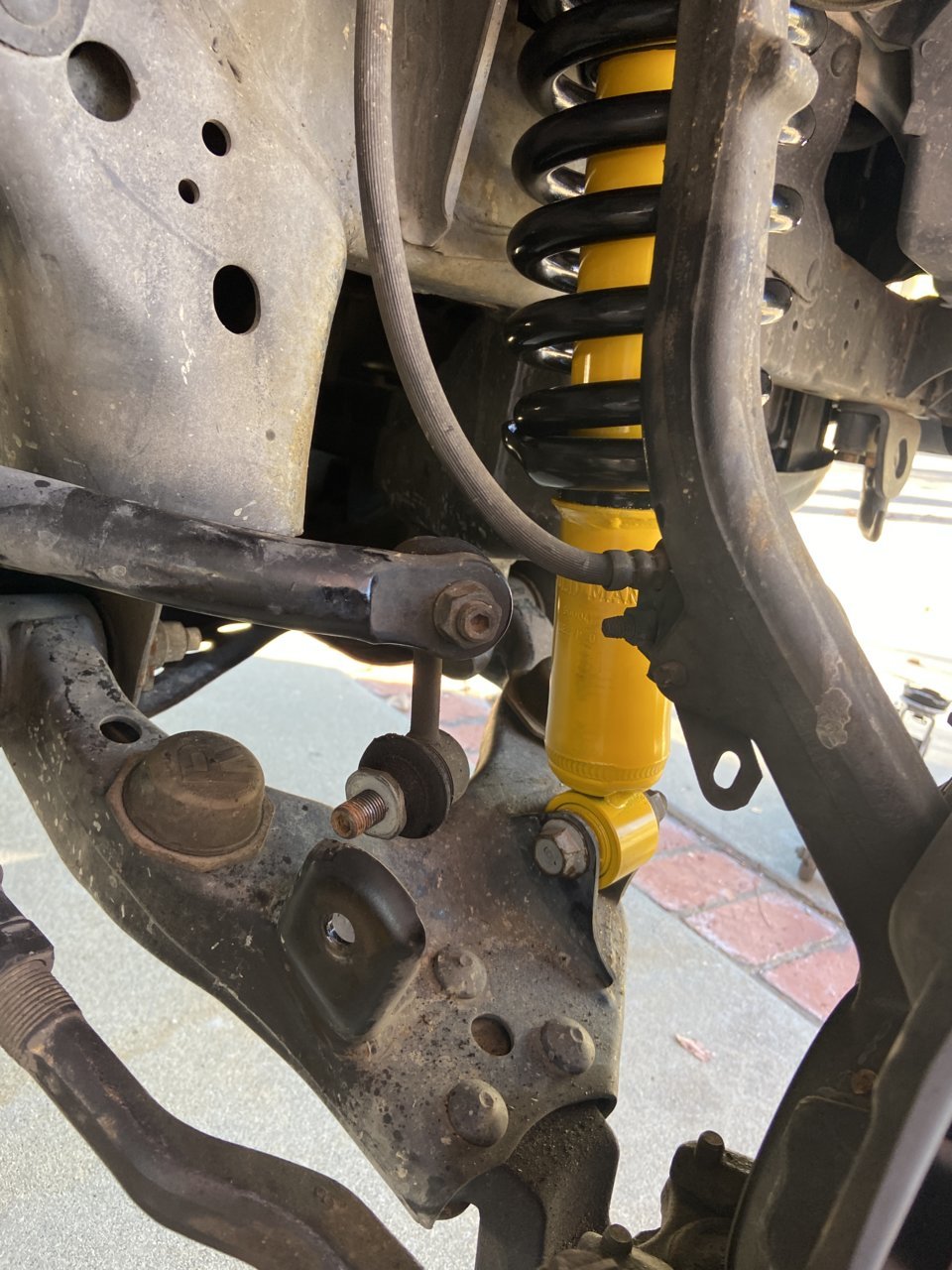

    Is the sway bar piece I unbolted the LCA to sway bar link? 51ftlbs?

  9. Dec 6, 2020 at 11:52 AM
    #4829
    Kwikvette
    Feb 27, 2019
    #284735
    82,840
    Fresno County
    4 run, 2 don't
    Correct

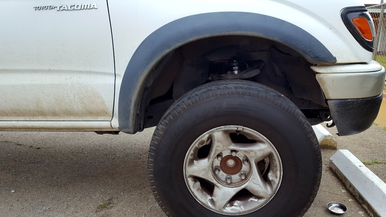

    Did the front suspension today. Nitrochargers and 882 springs. Going to do the rear nitrochargers and Dakar leafs next weekend. I’m going to pull the AAL off the leaf pack before install and see where it sits, hoping to eliminate rake. I’ll be putting the stock Toyota Bilsteins up for sale shortly.
    New rims and tires next month @SellyKlater
    Before
    After
    SellyKlater and Hamer95USA like this.

    Damn, even though the front will settle, that's quite a bit of lift up front.
    Just throw in the Dakar pack with AAL since you've got a camper shell anyway.
    Let the front coils and leaf pack settle at the same time and enjoy the ride.
    Here was the front shortly before I did the rears and install tires; Fox 2.5 up front -
