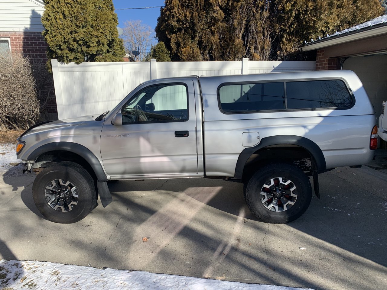

    @Liverfool mine settled a bit but I ended up pulling the third leaf after a couple years, I’ll try and grab a picture tomorrow.
    For reference, here’s right after install, same setup as you
    Liverfool likes this.

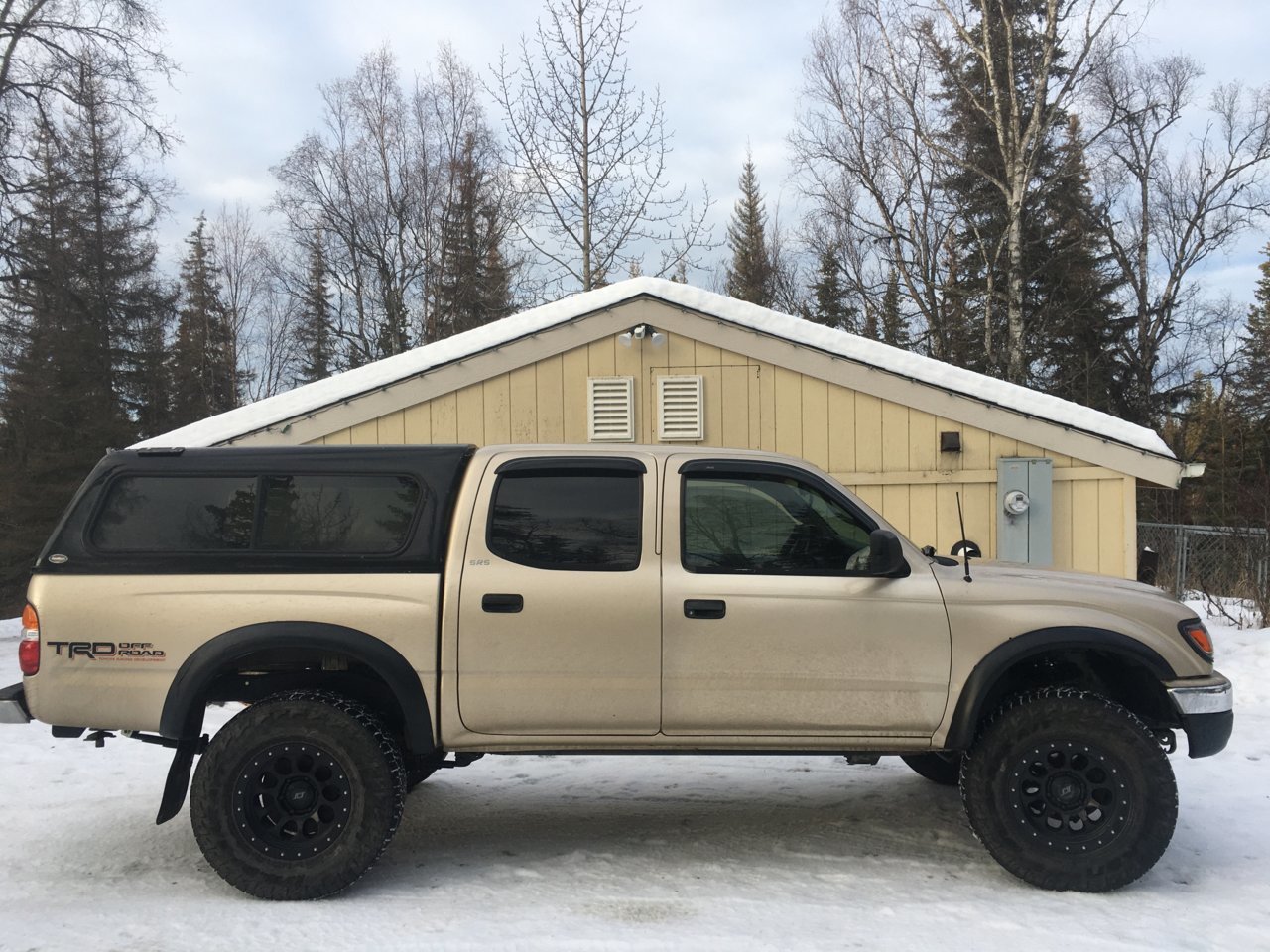

    @scott777taco INSTAGRAM
    SW Ontario, Canada
    2001 Reg Cab 4x4
    Blacked out badges-rims OME lift with 881's & dakar pacs, summer tires=BFG 31x10.5x15 on 93 4runner rims,winter= 265 75 16 DURATRACS on stock steelies,Flowmaster exhaust, deck plate mod, ARB front bumper
    Our trucks are very similar… My 0ME suspension is over nine years old… I think your truck looks fine.
    I have 881’s and Dakar’s, I had AAL as well but took them out because the rake was insane......I may add them back and down the road if the springs ever start sagging
    I love my suspension and you will as well!!!
    Liverfool[QUOTED] likes this.

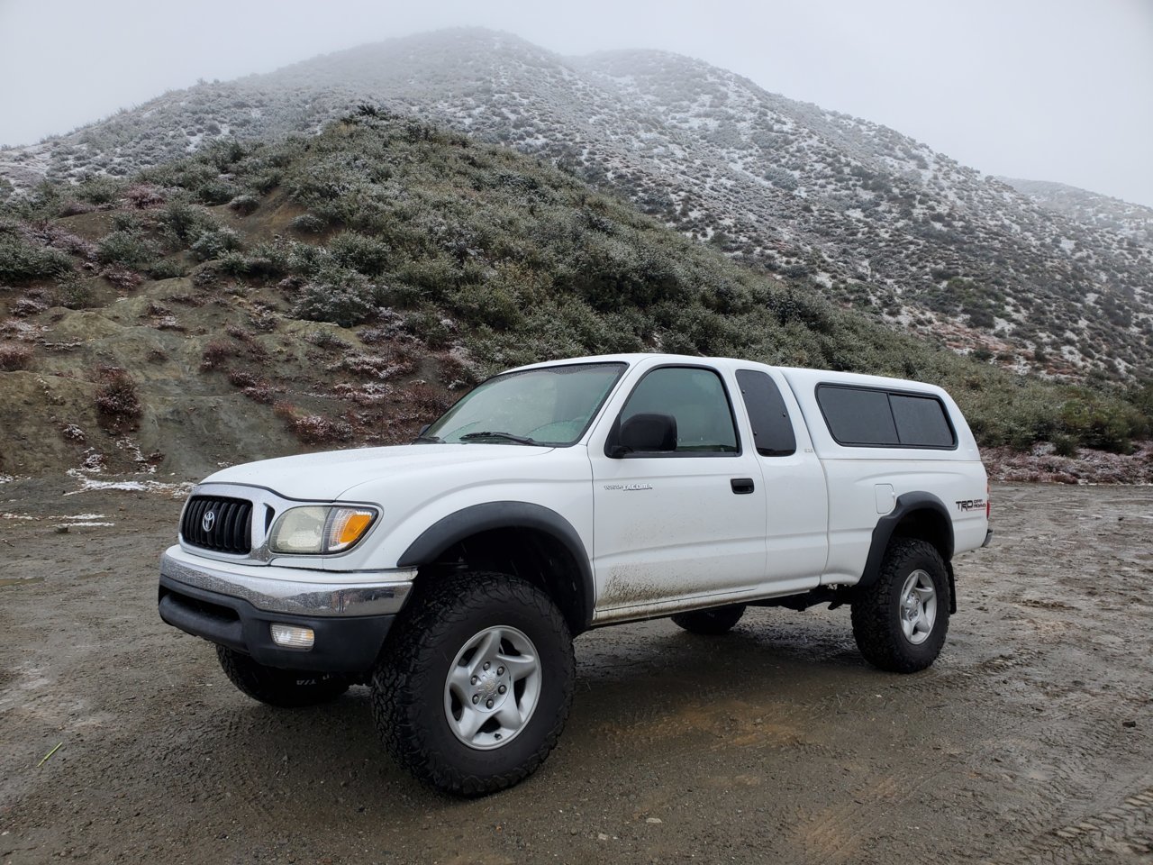

    Here's my setup ome struts/shocks 881 coil, deaver add a leaf, spc ucas tires are ko2 265 75 16
