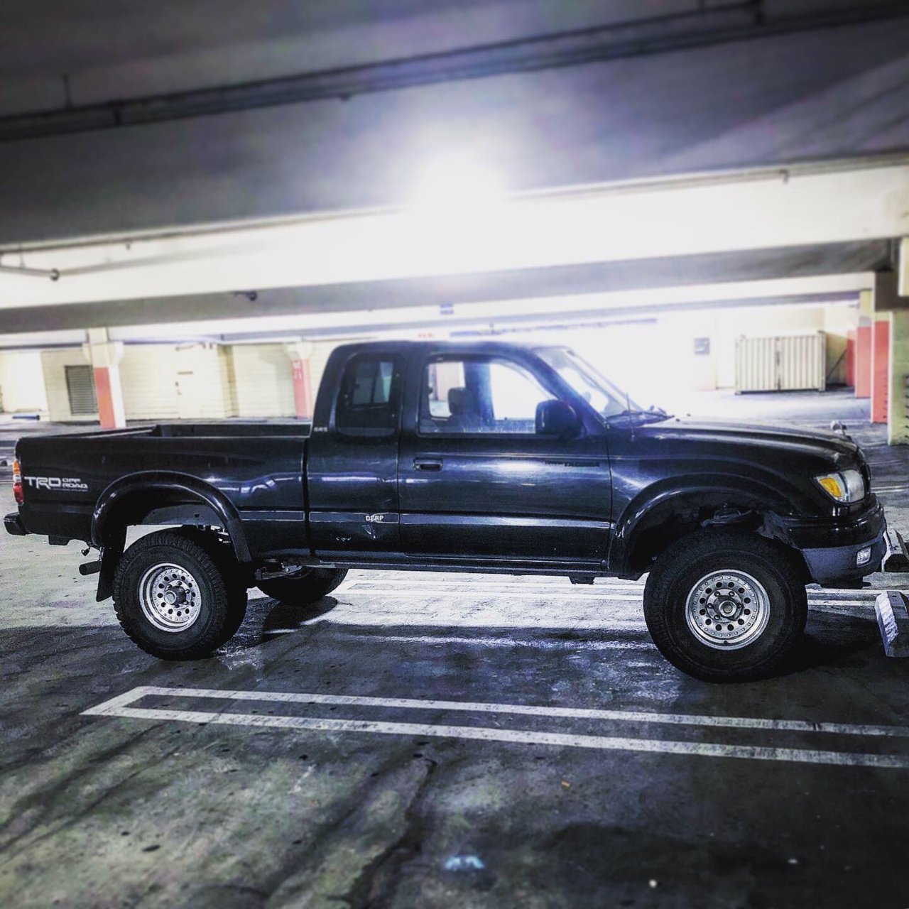

    2003: Bad clear coat, OME HD kit w/Dakar leafs, ShmellFab sliders, Badland Bumpers rear bumper, Bestop Supertop & Yakima/Tyger roof rack. SOLD - 2002: TRD PreRunner with a DERP sticker, some desert stripes, couple of rock scrapes, E-locker, OME front & rear w/Dakar leafs, and CURT front/rear hitches.
    V6s in both trucks. Let me see if I took any photos right before I sold it, and hopefully with no weight in the back...
    Ok, found one from the day the head gasket went. Last time I drove that beauty :sick:
    They really didn't settle much. Dakars are fantastic for constant load, or putting weight in the back. I sold it to my mechanic, and he doesn't keep weight back there, so he wants the OEM leafs back.

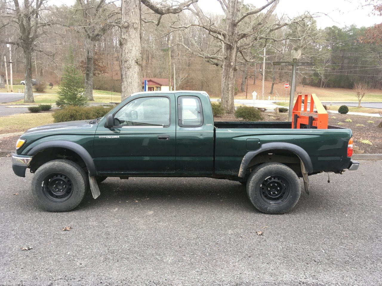

    yeah im gonna slap'em in and throw some weight in the back for bout 300 miles... if the leafs dont settle, ill pull the 3rd leaf out.

    OME 880's with dakar leafs. 2" rake... put my tractor forks (~250lbs) in bed. gonna drive it for 300mi or so to see how much they settle. id be fine with a 1" rake. handle and drove great... axle wrap is gone!
    8DB4A910-582B-462C-8132-FD156C36F334.jpg BC6596D1-9184-4DCD-B906-F22F27355CDD.jpg
    big thanks to @Kwikvette on the "how to" install dakar leafs pics. ratchet straps made it simple as pie... did it solo no problem!

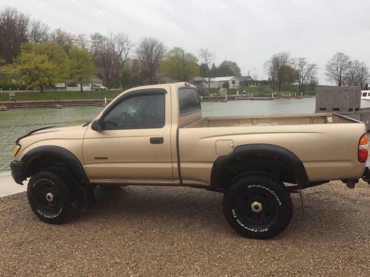

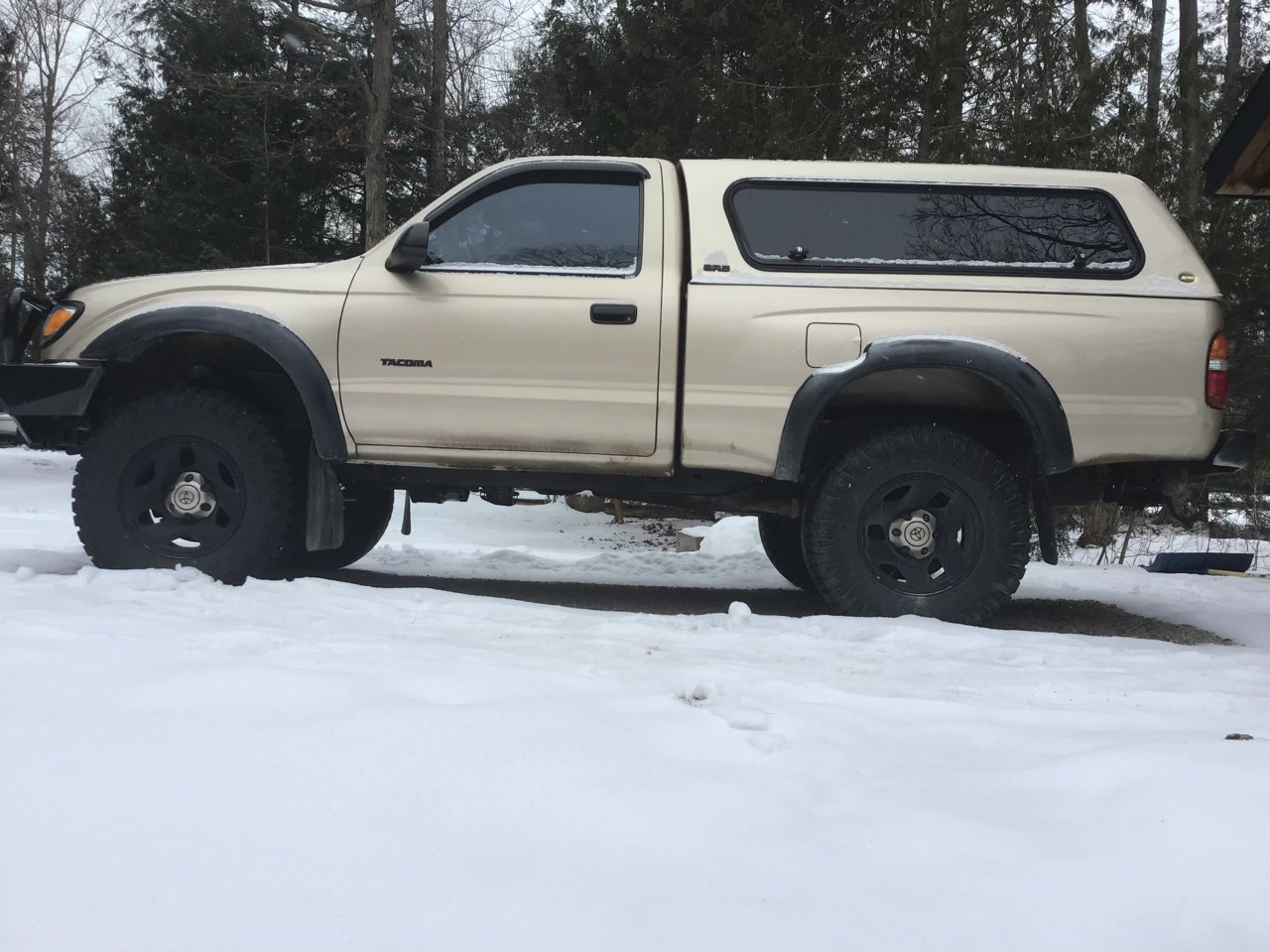

    Blacked out badges-rims OME lift with 881's & dakar pacs, summer tires=BFG 31x10.5x15 on 93 4runner rims,winter= 265 75 16 DURATRACS on stock steelies,Flowmaster exhaust, deck plate mod, ARB front bumper
    100% OME suspension Installed in October 2011. 881 Coils. ARB BUMBER added in 2017.
    May 2017 picture Just before I sucked a deer into my radiator. The second picture was taken in January 2021

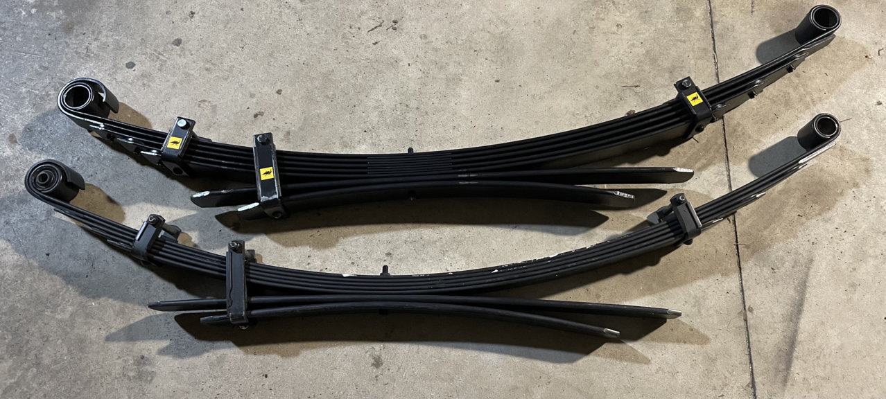

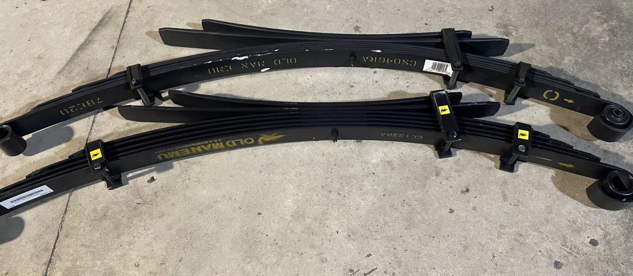

    Just in case you guys wanted to see what the new EL part number rear springs look like for our trucks, I’ll post a few pictures. My kit finally shipped just for ups to lose one of my springs. ARB made it right, but told me that they were sending me a complete new set, and to trash the old CS part number spring. I didn’t understand why they were sending me two more springs instead of the one I needed, that was lost. Looks like the main difference is the leafs are spaced apart, they look better to me. Install time!20D12A9A-377F-4BE1-8155-EE5D9097D94C.jpgFDE011B1-9499-49A3-A42B-97B3791C4505.jpg
