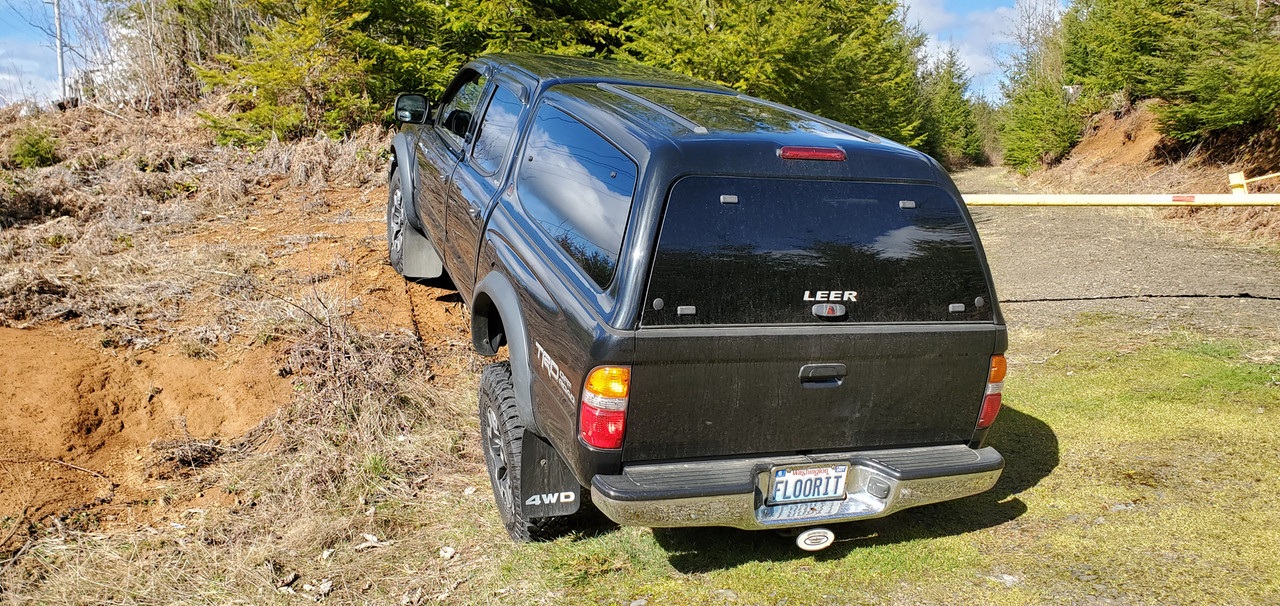

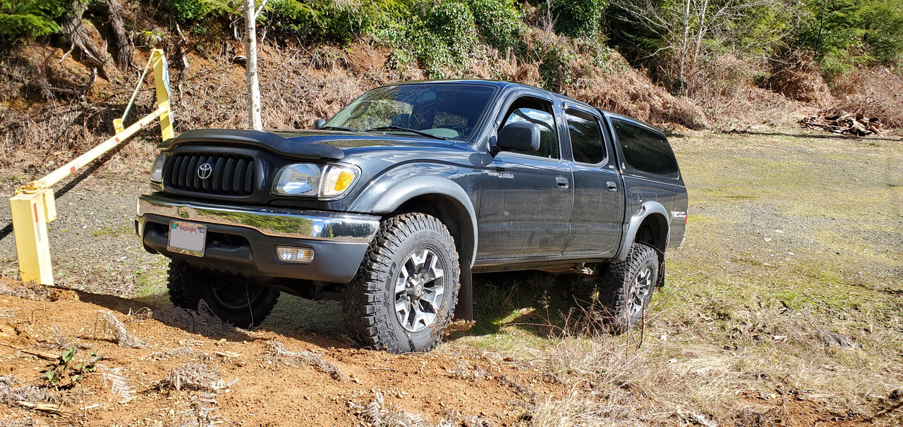

    Currently my truck has a spacer lift with AAL. The shocks/coils are tired, and leafs almost flat, after hauling over 2k a few times.
    I'm thinking of ordering the OME kit. Problem being, I'm new to off-road, and don't know which coils are the best choice.
    The truck has always had a Leer installed. It will stay. I do plan to have a winch, although a full winch bumper is not likely.
    I'd appreciate some input from others.
    What would be the best configuration?
    Here's the truck.

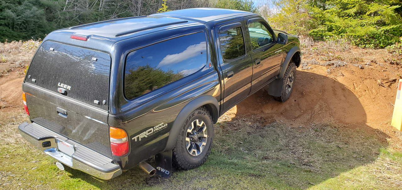

    2004 DblCab 4x4
    OME 882 Dakars Falken 235/85R16s
    My being new to the off road scene, my son talked me into removing the sway bar, for better articulation.
    After, the test drive proved it was safe. (A little body roll, but nothing to worry about.)
    I decided to make the truck articulate.
    Mind you, it was a virgin to these positions.
    Everything appeared to stuff nicely.
    I popped her cherry. :D
    Now I really want to get an OME suspension lift.
