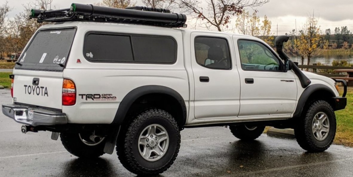

    So with my 02 double cab, I initially ordered without the AAL. Kit arrived and I installed. Immediately noticed a slight droop in the back with my Leer 100, rack and assorted load in the bed. Drove with it for a bit and it just bugged the hell out of the OCD. Touched base with Josh @Wheeler's Off-Road Inc and the info I received back from him was anything with an additional 220+ lbs, get the AAL. It's also on the product page. Ordered the AAL, pulled the packs, installed. PITA but satisfied with results. upload_2021-3-10_16-32-22.jpg

    Nice Truck, Sir!!
    I get what you're saying, and I can relate.
    I already have an AAL in the back that I can use, if necessary.

    Okay that helps I was first wondering about that cause I have a canopy + a rack on daily and then pretty frequently towing a boat and or loading the truck up with gear for extended camping trips. So with that though, what are you running for a lift up front and how does it level out? I'm running 5100's on the second setting, and I'm okay with more of a raked look as it'll settle when loaded down but I'm not into that shit they do down in Carolina lol.

    OME 881 coils paired with OME Nitrocharger Sport shocks. The stance is fine. Completely satisfied with how it sits.
