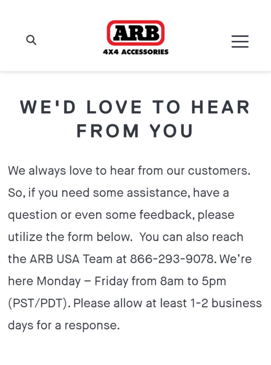

    Call ARB USA, ask them directly, I would.
