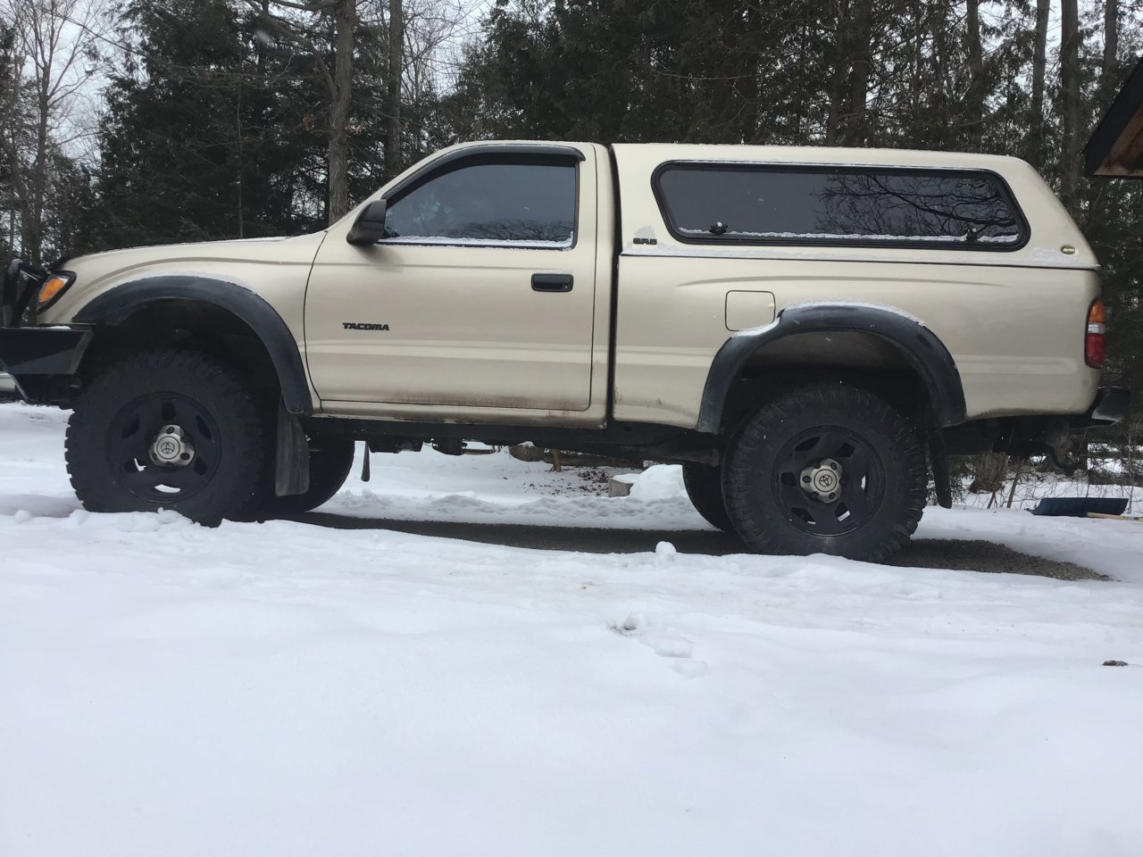

    @scott777taco INSTAGRAM
    SW Ontario, Canada
    2001 Reg Cab 4x4
    Blacked out badges-rims OME lift with 881's & dakar pacs, summer tires=BFG 31x10.5x15 on 93 4runner rims,winter= 265 75 16 DURATRACS on stock steelies,Flowmaster exhaust, deck plate mod, ARB front bumper
    This picture is 10 years after 0ME installation....881.
    The ARB bumper was not planned But sucking a deer through the radiator changed that in 2017. I was worried the 881s wouldn’t be enough but they’re fine however a winch would change things. Your 3.4 L probably weighs a little more than mine.
    2.7 L engine and I initially installed the AAL but removed it after one year because it was too much. Can’t say enough about the suspension it’s great and I keep thinking I may need to put the AAL back in but not yet!

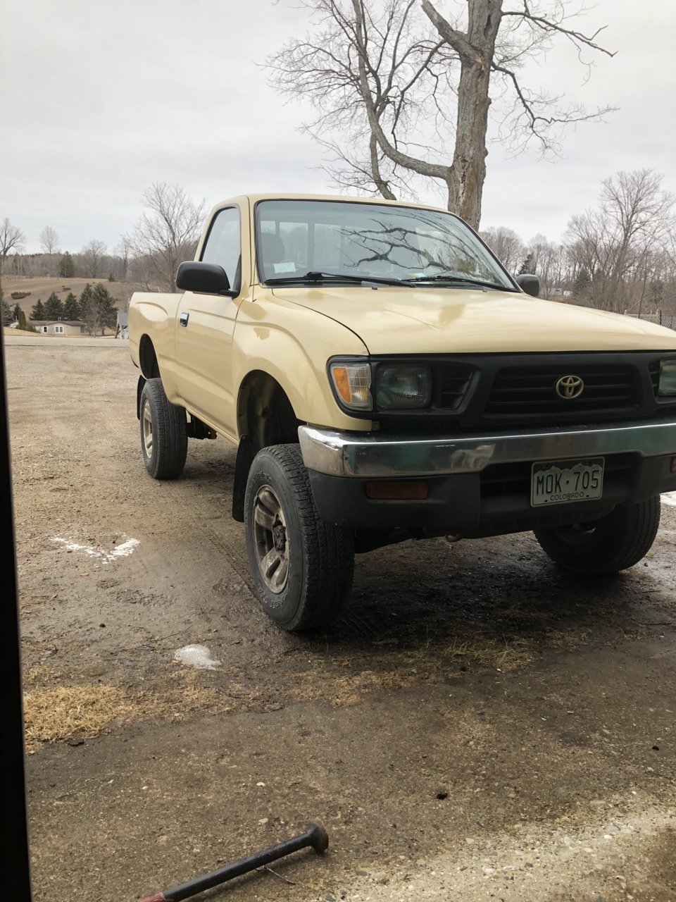

    CCB01B06-2426-4112-902F-BCA8F71B6EF5.jpg 383EA772-C1CB-4201-A987-75F7214A7F15.jpg
    881’s gained 4” up front
    Dakar leaf pack gained 3” in rear
    2.7 4x4.

    You gained 4” from where the tired old springs were.
