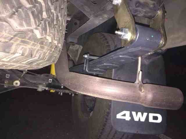

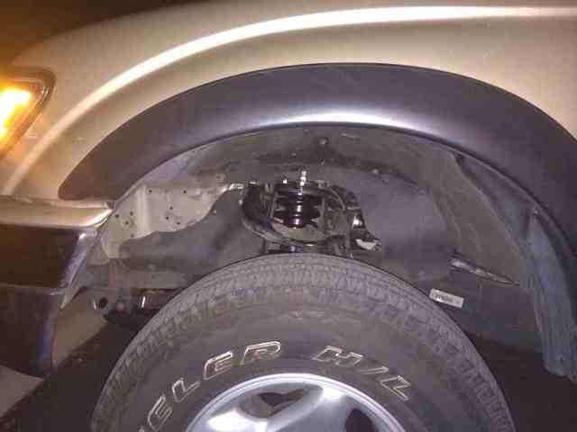

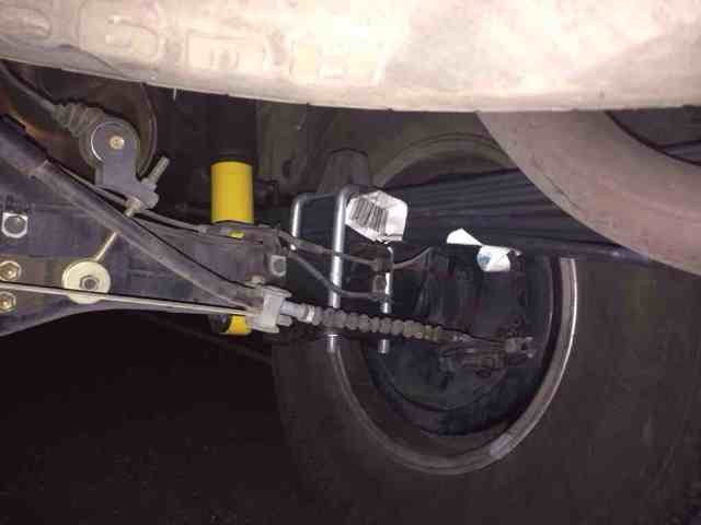

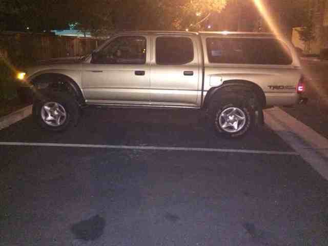

    Looking good. I leave and get home when it's dark so this is as good as it gets - vibe I think is front diff problem but didn't get a chance to fully diagnose before heading out. Seemed like it went away with 4wd on... Will at least entertain carrier bearing shims, since it is free and easy to try. Still have not taken above 55.

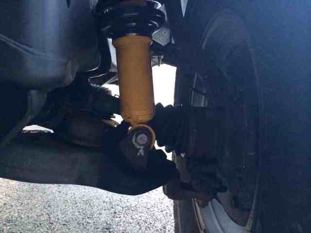

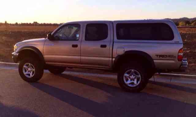

    Cv angle with diff drop. I think it helps. Also a better pic of the truck, thank goodness for the time change

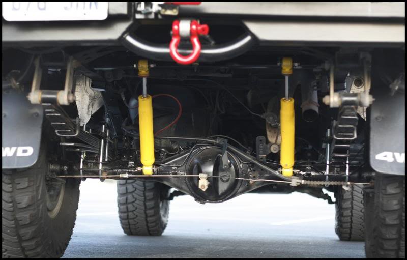

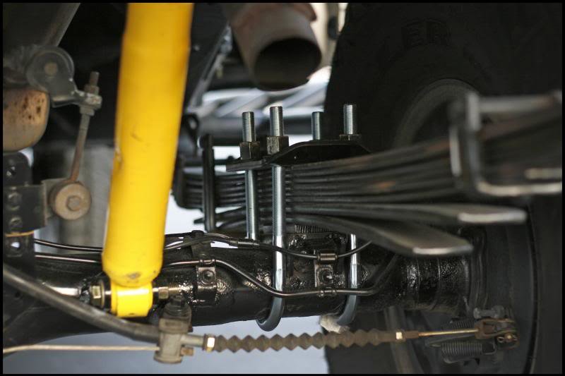

    So... If you plan on actually carrying any kind of weight consistently, I would highly suggest the aal. Otherwise the *** end will drive you nuts. In my case, I really don't want to pull the leaf off again so I'm gonna bandaid it with longer shackles for now. Hope it helps make your decision easier.
    Btw ^ pretty sure Adam relocated his shocks to allow more travel. Please correct me if wrong.
    EDIT: I searched, and it is indeed for allowing more travel. Looks like a bear of a job for a layman like me.

    I've found with the stock location the Dakar leaf packs scrape the OME shocks when getting into full flex. I'm researching re-doing the rear suspension with the AAL and some Icons and might include a relocation.
    I've been wondering if mine came with the AAL. I've never had any issues with the rear-end sagging when carrying a load. Might explain why I had to put on the top plate spacers to level out the front end.
