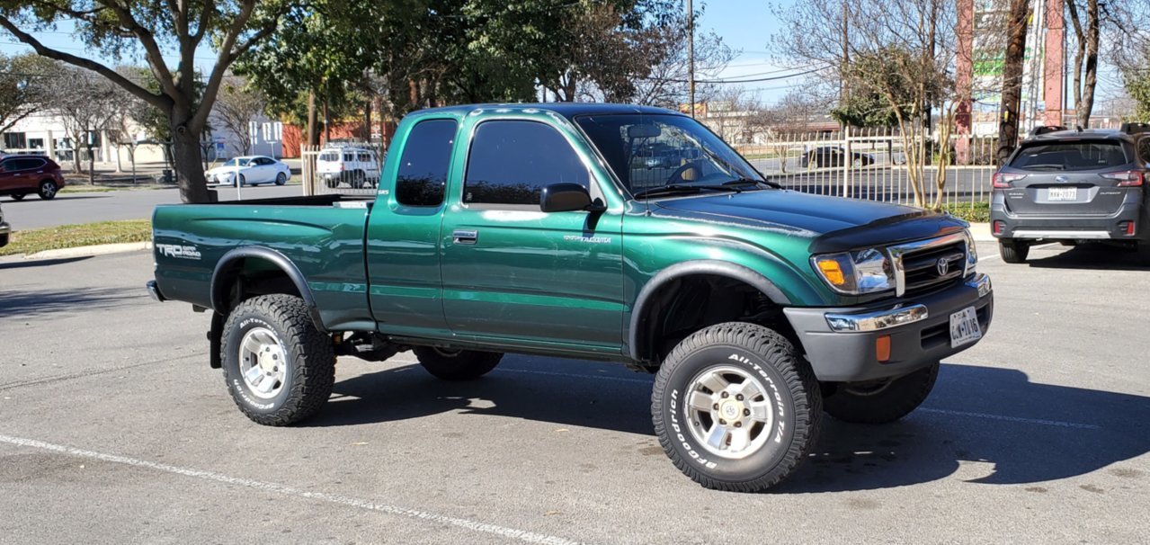

    I put my OME suspension on and ready for some 33s leaning for some BFG KM3s 285x75r17 anyone have that set up with bronze wheels or black also thinking of going with the 17s TRD pro wheelsScreenshot_20210208-215920_Gallery.jpg

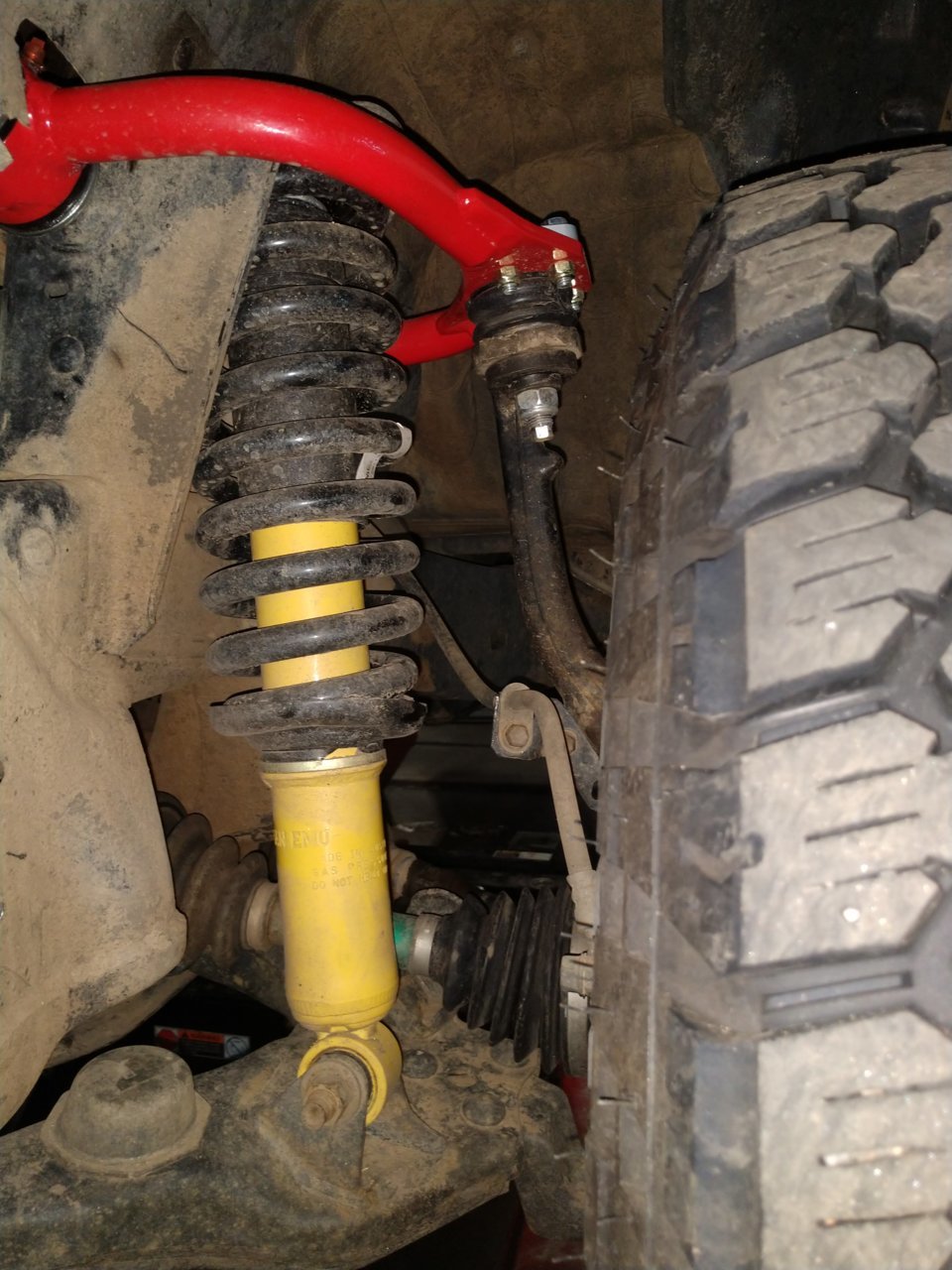

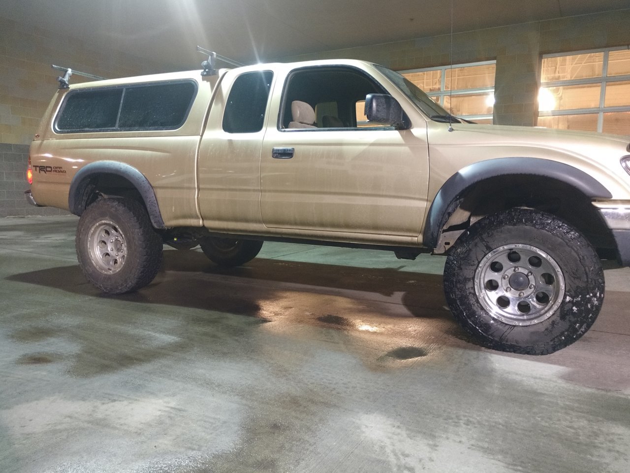

    IMG_20210305_220217043.jpg IMG_20210322_192423400.jpg 881s, Nitrochargers, Dakar springs and JBAS
