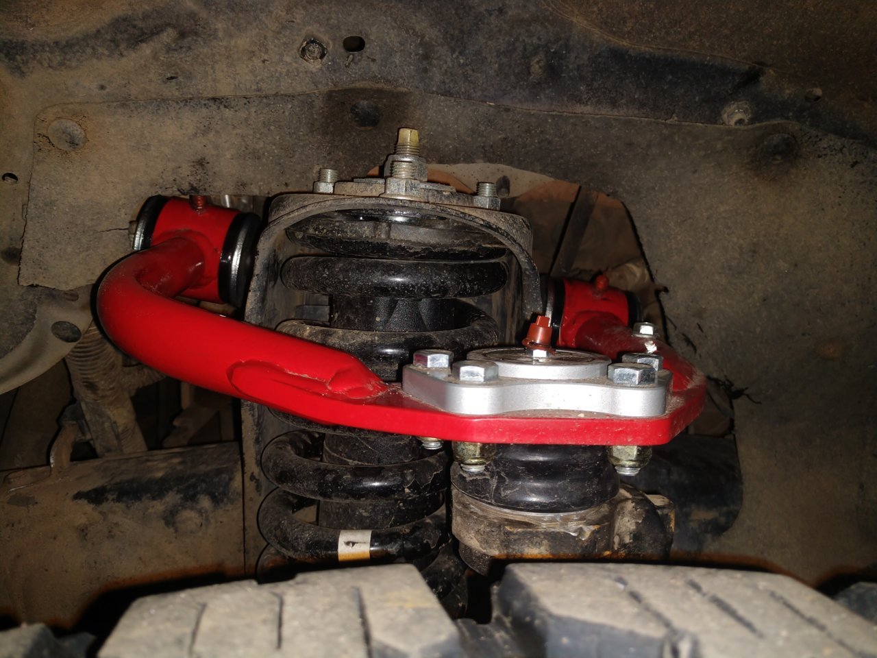

    Highly recommend upper control arms. I went and tried out some flexy spots after I installed the lift and the upper control arms were contacting the spring coils. I gained the extra clearance I wanted between the springs and upper control arms and the alignment came out just about perfectIMG_20210322_185751806.jpg

    Which did you go with?

    My bad, I went with the JBA'S

    Cool thank you. Been looking at those and TC
