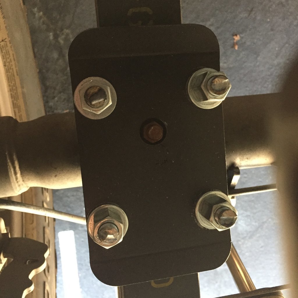

    If any of you are looking for u bolt flip plates drilled for relocation plates because Dakars are annoying AF like that LMK.

    Totally agree and glad you're offering this. My buddy @Ritchie did these for me back in 2017:[​IMG]

    I was actually planning on doing a U-bolt flip relatively soon and was looking at kits. Would be down to take them off your hands
    How did you mount your bumpstops to them?

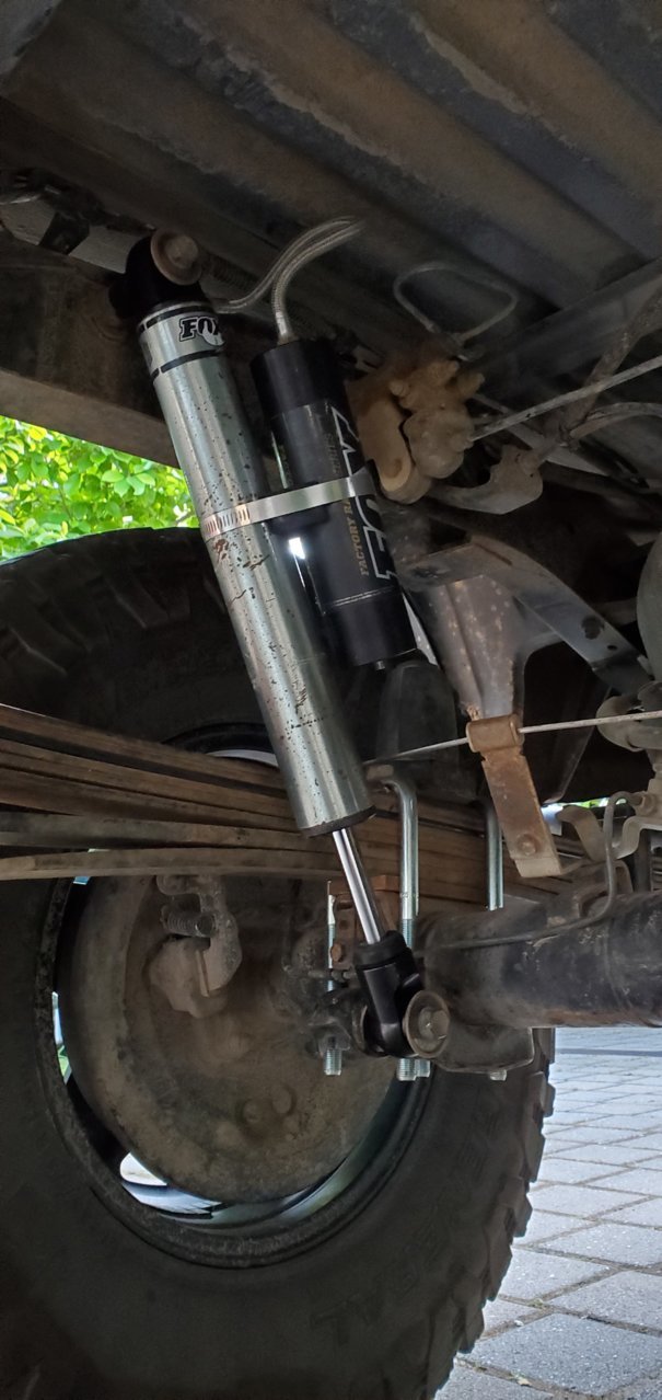

    And I extended the stock bump contact points on the frame:
    As you can tell even with the AAL the dakars have seen better days as far as carrying capacity goes (that's ride height), hence the direction of airbags lol.

    I have the 4.25" durobump ones and they work well and don't let the leafs go too far negative imo.

    The bumps were extended after cycling the suspension and based on the fact that the bumps would compress to about half their static height. After real world use is appears they compress 1" less than expected so they could be about 1" shorter. This is also based on I am running a 10" shock as vertical as possible compared to forward/backwards like stock shocks are oriented. If you compare your ride height and my ride height before I added a much weight as I have statically, we had about the same amount of space between the bump and the contact point:
    [​IMG]Untitled by Michael Halat, on Flickr
    Bump spacers and shocks were mounted in a way to be able to go this negative:
    And droop this much:
    I had a pretty perfect 50/50 ratio of up and down travel when all was said and done, but the packs can't handle all the extra load. The proper fix is custom packs and getting rid of the Dakar's all together but the airbags can act as a bandaid for now. Ideally i need Alcan's or Deavers custom spec'd to the static load weight of the truck not loaded for a trip, just my daily load. Then if I load up for a trip or load the bike in the bed I can have the airbags assist then. But for now the bag's are going to make up for the fact that these Dakar's are shot and can't keep up.
    The most difficult part of custom setups is you don't always get things right the first time and your uses sometimes change. I honestly wouldn't even be surprised if I need to tweak these airbag mounts at some point. I mean I definitely will once I ditch the Dakar's and relocation plates, but that's life.
