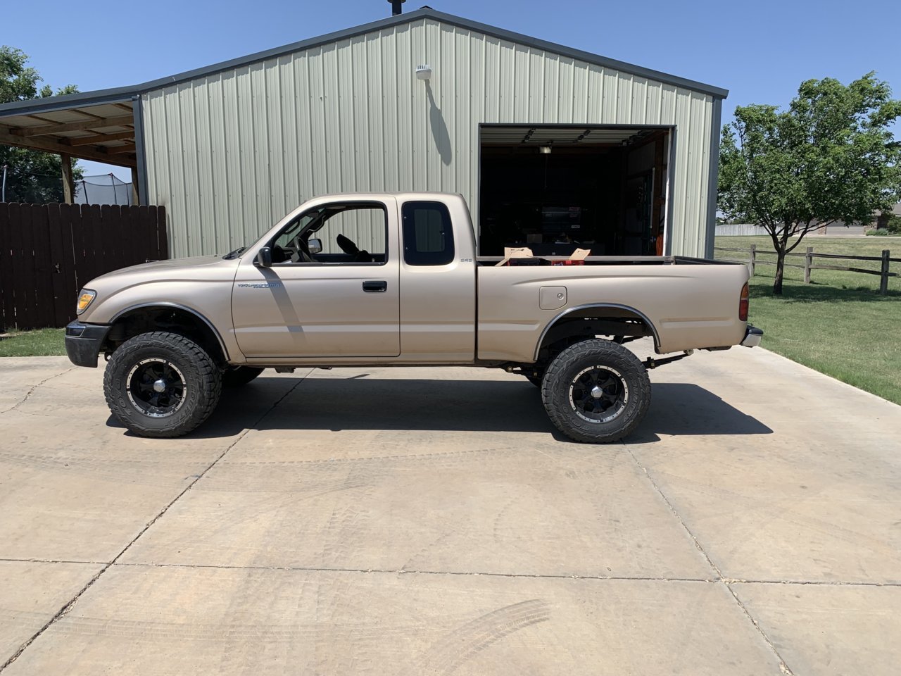

    I have the Dakar leafs on my truck and they did push the wheel forward a bit. I noticed it right after installing, then confirmed the same reading on here. You can kinda tell in this pic...

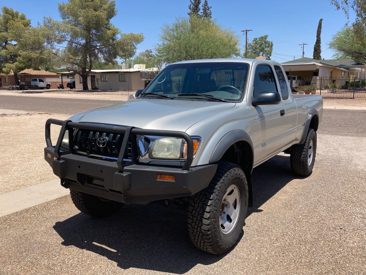

    It's interesting it is more noticeable on some trucks vs others, being the same year range and leaf pack. i would still argue that yours is still forward though @Nano909 but less noticeably than @FreshOldTaco for sure.
    My truck is hard to use for comparison since it's on 35's and of course user error could have happened when chopping the fenders, but even with the axle pushed back 3/4" it feels like it is biased to the front.
    This is the best side profile shot I could quickly dig up.
    [​IMG]Untitled by Michael Halat, on Flickr
    Had a hard time finding a full stuff pic, but this shows that I'd likely be eating the body if they weren't pushed back.
    [​IMG]IMG_8254 by Michael Halat, on Flickr

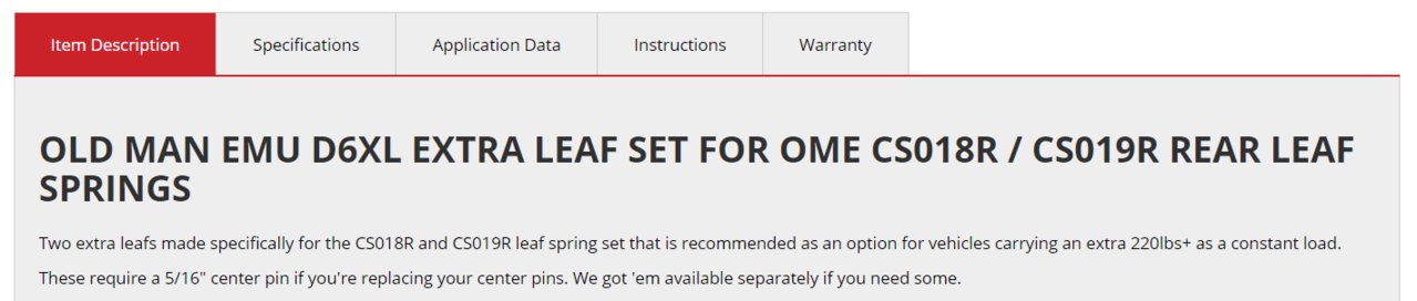

    Looking at ordering the OME kit from Wheelers. I've got an extra cab with a soft top and load up about 100#'s of stuff daily, was thinking 881's and add a leaf? This a safe bet?
  7. May 29, 2021 at 7:49 PM
    #5107
    GoPedTed
    GoPedTed Member
    May 8, 2021
    #365131
    23
    2002 TRD 4x4 Dbl Cab
    I was wondering same thing for my truck. I just got Wheelers progressive AAL in the mail today. Its 1.5". About to order 881s. Mine is dbl cab v6 4x4.

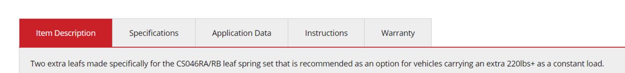

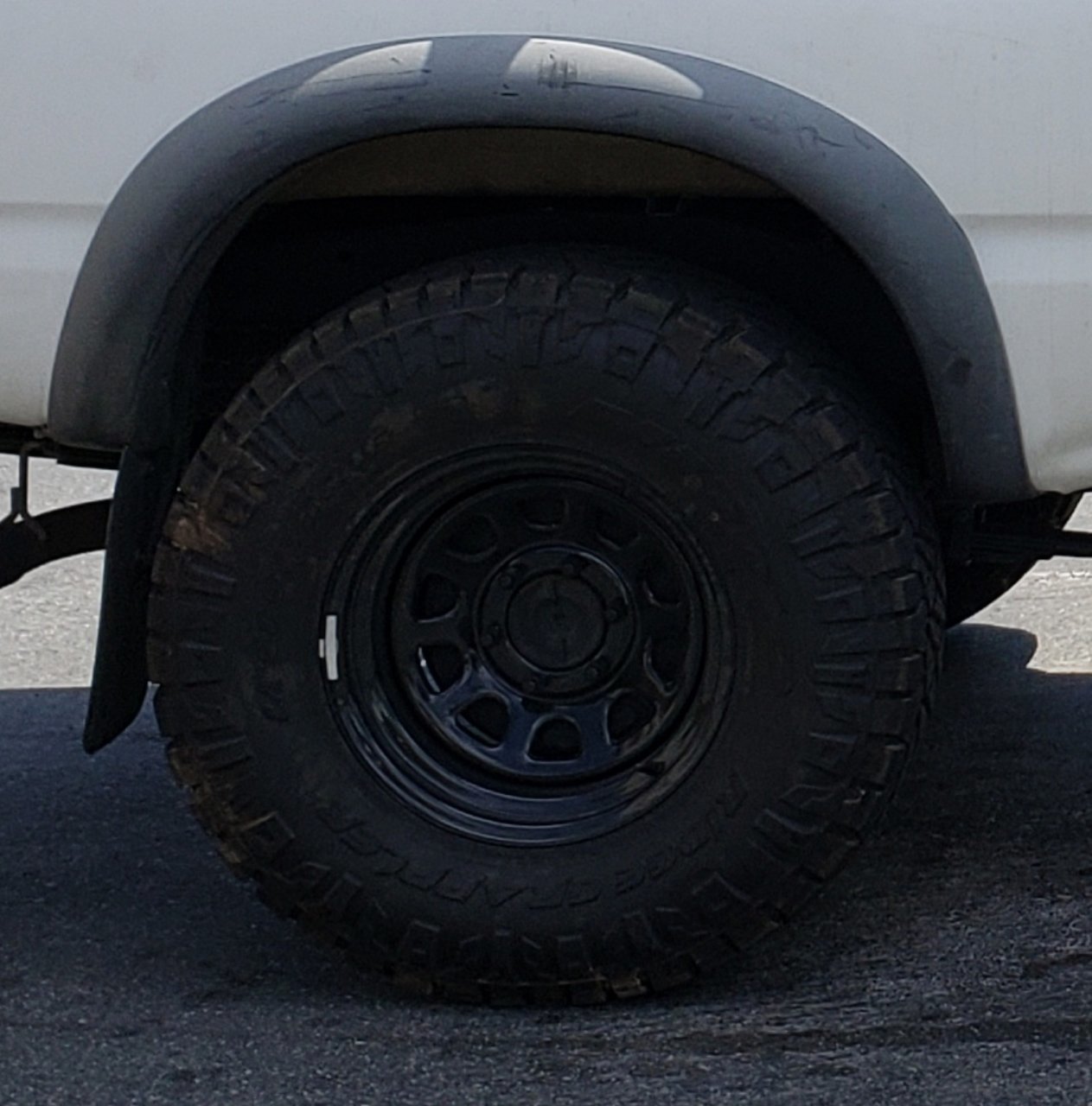

    Finally got my big tires on. Running 275 70 18 on lexus gx460 rims

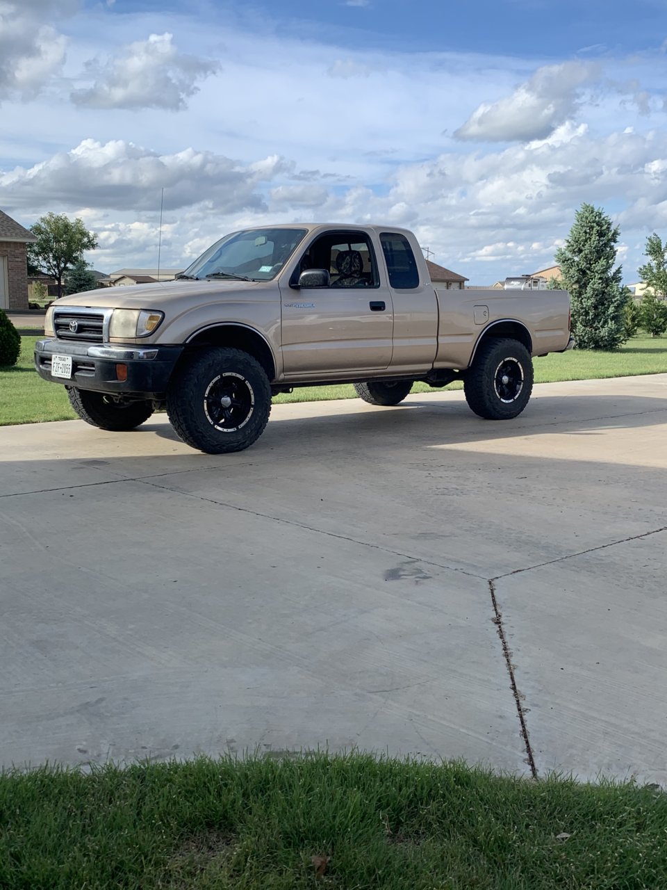

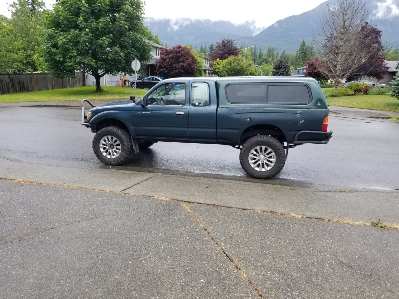

    Got my OME kit installed today. Took me longer than I thought mainly due to wrestling everything by myself. I gained 4” in the rear and 2” in the front with Dakars and 881 coils with no AAL. Truck is currently sitting on 31x10.5x15 tires. Drove a couple of miles just to do a quick test and everything seemed good. The old stock stuff from 1999 had 195k miles so it was well worn out. After I drive it some I’ll come back and give some more thoughts. Here’s a before and after pic.

    Looks good! a smidge high in the back but over time should settle.. but I like the stance, not a fan of too much lift, this looks good! You get any drive line vibes?
  12. Jun 19, 2021 at 4:08 PM
    #5112
    DeerHunter44
    DeerHunter44 Well-Known Member
    Jun 1, 2021
    #367402
    49
    1999 3.4 4wd AT
    No vibes at all. I hauled some deer corn today and after I unloaded it seems the rear has settled quite a bit. I didn’t measure but I’d guess I’m within 1/2” of level now.

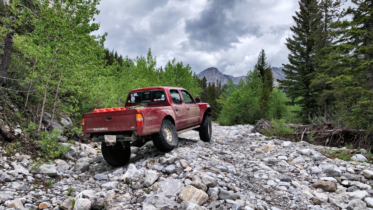

    Losing the ARB bumper makes me want to swap out my 883 coils. They’re definitely too stiff at this point. The rear is still pretty good, for ride and for flex.

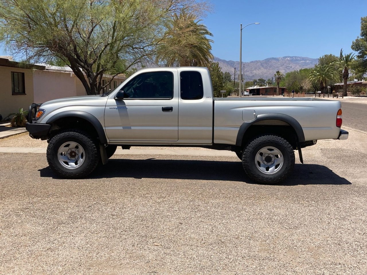

    Got my OME lift put on a few weekends ago. Have the 883's in the front and the Dakars in the rear. Still waiting on the AAL, hasn't come in yet but may throw it on depending on what happens when I get my camper shell.
