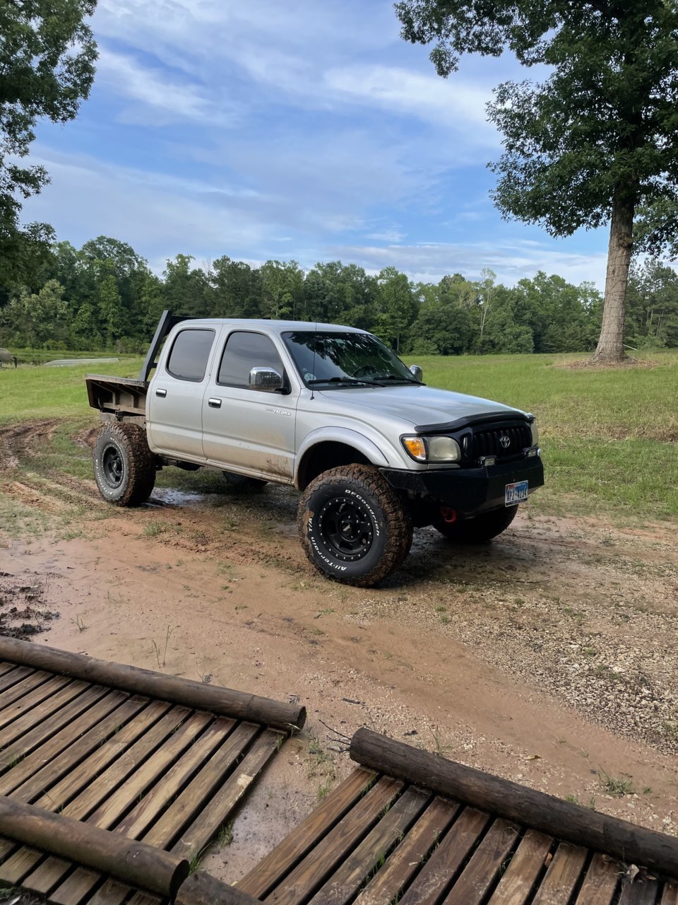

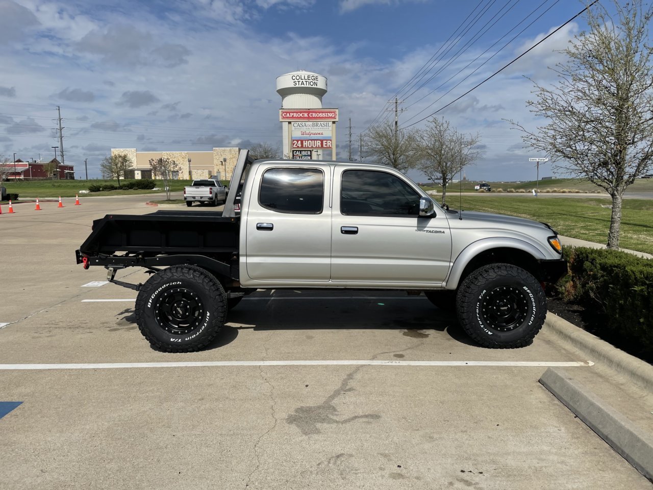

    03 (un)Limited
    03 (un)Limited New Member
    Mar 28, 2021
    #360905
    Zane
    2003 Tacoma DCSB TRD Limited
    OME 2.5” lift kit with 883 coil springs, Dakar leaf pack with add-a-leaf, and nitro charger shocks 1.5” diff drop Extended rear brake line Homemade front bumper Corner light blinker conversion Homemade flatbed New wheels and tires
    Here are some pics of my truck with the 883 coils in front and Dakar’s with aal in the back.
