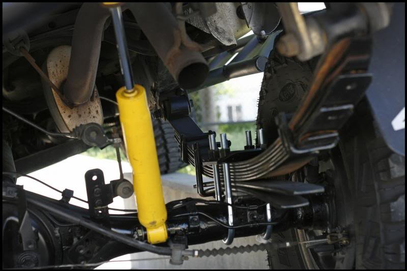

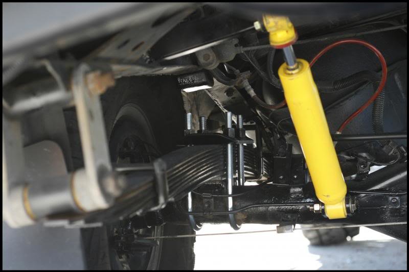

    Ok here's some details about the dakars... and OME leaves in general.
    They do not have a constant arc from front to back. They have a slightly "flat" spot at the center where the spring hits the spring perch. This is to keep the ubolts from having to force the springs to flatten as the ubolts are tightened. Less strain on the ubolts, no tension on the springs and they "seat" better against the spring perch. This contributes to the "wavy" look Monte pointed out.
    OME spec photo
    In addition the springs are designed to be nearly flat at static ride height. In Australia where they are designed, they are not meant as a "lift" spring but as an upgrade from OEM springs with better behavior on washboarded tracks in the outback. A flat or close to flat spring gives a much better ride over high-frequency bumps like potholes and washboards than an arched spring. This is the primary function of the OME leaf springs. They do provide some lift but it's primarily a stronger better riding upgrade to stock suspension.
    For those wondering the AAL or the D6XL extra leaf for 1st Gen Tacomas should be the third leaf from the top when installed. This makes a HUGE difference in load capacity over the standard Dakar leaf packs.
    The Dakars have two progressive overload leaves to limit the negative arch of the springs when flexed or loaded. Since they are designed to be nearly flat at static ride height, they will frequently go into negative arch. This is normal and how they are designed. The two overloads will keep them from compressing to the point of damaging them.
    Someone pointed out that the OME shocks can contact the springs with the shocks in the stock Tacoma locations. This is true. You can see the body of one of the shocks in the photo I posted above that is dented.
    As for why I relocated my shocks it was because the OME shocks were limiting droop. The springs would drop farther than the shocks would allow. I wanted to get all the travel I could as well as accomodate the ubolt flips I added that ditched the stock lower shock mounts. Keeping my shocks essentially vertical rather than angled inward like /\ keeps the truck more stable with less body roll in turns. The new location of the shocks like I have them allow for full travel of the leaves while still using OME nitrocharger shocks.
