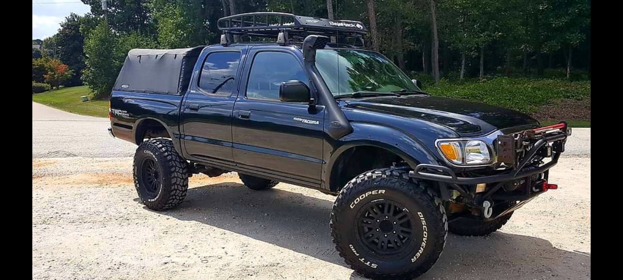

    OME 881 coils with OME nitrochargers shocks up front. TC UCA's OME Dakars with extra leaf in the rear. Warn 8000 winch with 80ft custom braided synth line. Custom 60ft synth extension. All pro tube bumper, Hi-lift jack, Safari Snorkel, Wilco tiregate. 2019 Jeep JLUR.
    I'm not converted to 4x4 yet, so no cv's.
    I think I got 2.75 and settled to 2.25.

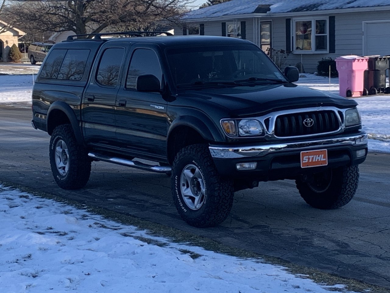

    OME 881s with bilstein 5100s. 2” AAL and 5100’s in the rear. It’s settled a little more now in the front.

    Looks great! Always liked those factory alloy's.

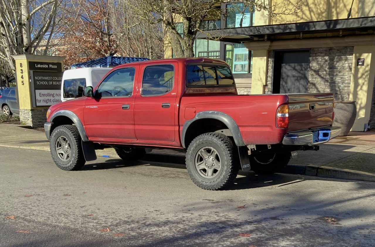

    I guess about 2 - 2 1/2". Probably more before they settle. Unfortunately, I never took before/after measurements. My Dakars are the old style, very well seasoned, and I still have a little rake. I removed the canopy to work on it and I gained some lift, so I'm thinking they still have a lot of life in them. I even had to put some sandbags in the back to smooth out the ride.

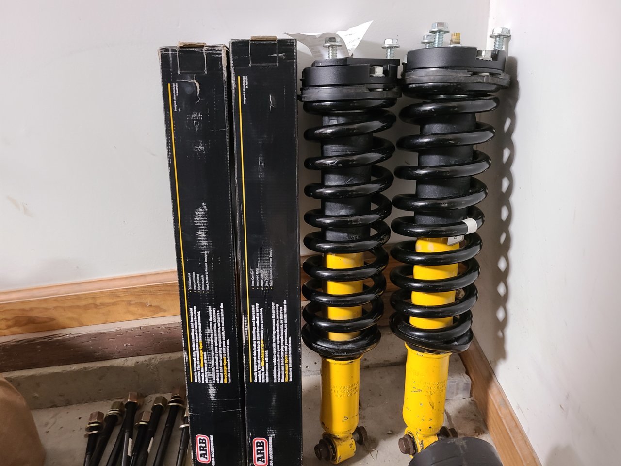

    I believe they are, I bought the 881's and front nitrochargers separate from a private party unused and went to the local Toyota hot spot for whatever I needed OME on the rear to match.
    They were the ones that talked me out of using the 1" spacer on top of the 881's that came on them and set me up with the rear OME leafs. I asked if it was likely I would have to add to them to get to level with the front and he seemed confident it would set level....but....I read here of others with the same setup needing an add a leaf as well?
    In pic you can see the spacers on top they talked me out of using.16431637352392831138560544613880.jpg 16431637352392831138560544613880.jpg

    I ran a spacer lift on my first 01 I owned and it was a cheap option. A lot of people frown on them but if it’s just to level on a budget and if you aren’t wheeling hard, they work fine imo.
    honestly you will be fine with the 881s and the dakars, you should sit pretty good. I wouldn’t worry about it.
