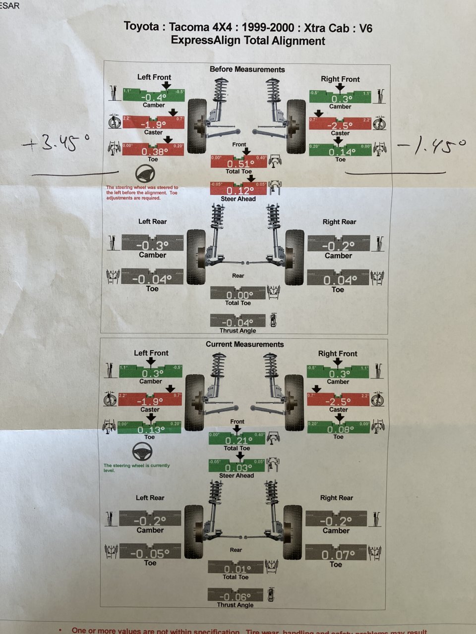

  16. Jun 12, 2022 at 9:20 AM
    #5216
    Tuluk
    Tuluk Well-Known Member
    Apr 23, 2022
    #395640
    263
    1999 trd manual 4x4 ext cab
    Adding this for anyone interested in alignment specifics. All of the following were done at the same time, zero miles on anything, including tires.
    BFG K02's 265/75/R16
    Spidertrax spacers 5-1/2" x 1-1/4"
    Dakars, 882 coils front.
    Delphi OEM style upper control arms from rock auto;
    Whiteline LCA bushings; OEM steering rack and OEM tierods;
    OEM upper ball joints and OEM lower ball joint.
    Upper control arms are maxed out as expected. Here is the best that was possible according to the alignment shop:
  17. Jun 12, 2022 at 10:56 PM
    #5217
    Digiratus
    Digiratus Adventurer
    Mar 26, 2010
    #34006
    23,745
    Roaming the PNW
    The RedHead
    2002 XtraCab TRD 4x4 SCv6 AutoTrans With Lots of Mods ADS COs w/Compression Adjusters Camburg Uniball UCAs Whiteline Lower Control Arm Bushings Kartek 7" Limit Straps Plastics Guy Front Bumpstops Total Chaos Sprindle Gussets Custom Alcan Springs +800 lbs +3" ADS 10" Stroke Triple Bypass w/Resi Rear Shocks Custom Rear Shock Relocate All-Pro U-bolt Flip w/Timbren Bumpstops 4.88 Nitro Gears ARB Front Locker ARB Twin Compressor Black 17x8 Konig Countersteer Type X 285/70r17 Falken A/T3w Gunmetal 16x8 SCS Ray10s 255/85r16 Maxxis Bighorns Limited Edition (Relentless) Elite Front Bumper Smittybilt X2O 10K Winch Diode Dynamics SS3 Sport Selective Yellow Fog Lights in the Bumper Diode Dynamics SS3 Pro 4,000 Kelvin SAE Driving Lights with Clear Lenses on the Bumper Morimoto D2S Projectors XB35 Ballasts + 4300K Bulbs Badland Sliders FrankenFab Tire Carrier Swingout bumper w/kitchen BudBuilt Front & Bellypan Skids BAMF Rear Diff Skid Dometic CFX 55im Fridge/Freezer Alpha II Hardshell RTT Badland Custom Bed Rack Denso 210-0461 105 amp alternator Dual Northstar 24F AGM batteries BlueSea 7622 ML-ACR Battery controller Peak DBI Dual Battery Voltage Monitor Haltech IC-7 Display with Mako Dash Insert Haltech Elite 2500 Standalone ECU Magnuson MP62 Supercharger w/URD 2.2" Pulley Denso 650cc Fuel Injectors Aeromotive Stealth 340 Fuel Pump TransGo A340F Reprogramming Shift Kit Doug Thorley Headers 2.5" Magnaflow Hi-Flow CAT Magnaflow 18" Muffler w/Vibrant Resonator 13WL Brake Calipers Braided Steel Brake Lines Kenwood TM-71A Dual Band Ham Radio Larson 70CM/2M Antenna Midland MTX275 GMRS Radio w/Roof Mount Antenna Uniden 520xl CB radio 3' Firestik Adjustable tip antenna Pioneer DEH-P9400BH HU Alpine Amps & Type R components (F) and coaxials (R) Wet Okole Seat Covers Weathertech Digital Liners Deck Plate Mod 1" Diff Drop Carrier Bearing Drop
    Find a new shop.
    That is a piss poor alignment. They didn't touch the caster and that much negative caster is no good. It looks like they never touched the LCA cam adjusters, which is where all of the caster adjustment is done. I assume your cam adjusters are not frozen since you replaced the LCA bushings.
    It is important to note that OEM UCAs cannot be adjusted for an alignment. I've never heard of the brand you used but if they are OEM style, there is nothing adjustable on them.

  18. Jun 13, 2022 at 9:21 AM
    #5218
    Tuluk
    Apr 23, 2022
    #395640
    263
    I’ll have to take your word on that, I know only the basics on alignment charts. what I meant was that the 882’s have maxed out the sitting angle of the uca with these tires. The delphi branded upper control arms are identical to oem, completely non adjustable as you said.
    The cam adjusters control both caster and camber on these trucks, so I assumed they wouldn’t be able to correct that much caster without losing the camber.
  19. Jun 14, 2022 at 12:00 AM
    #5219
    Digiratus
    Mar 26, 2010
    #34006
    23,745
    Roaming the PNW
    The RedHead
    If your cam adjusters are working correctly, the alignment tech should be able to get a little positive caster without hurting camber. The more lift you have does make it harder to get the caster higher, but they should be able to get between 1.5-2° positive.
    It's pretty obvious your tech chose not to touch those adjusters as the caster numbers from the before and after readouts were identical. If the camber changed very slightly, it is only from adjusting the toe and the steering wheel being centered.
    If it were me, I'd call them on it. If they choose to do nothing at that point, find a shop who will do the alignment correctly.
    FWIW, caster is what gives the truck a great driving feel. The higher the better. Personally, I like +3° of caster. With it that high, no more buffeting from side winds or when passing a semi and the truck is unfazed by ruts in the highway. I'll bet right now yours is very twitchy at highway speeds.
