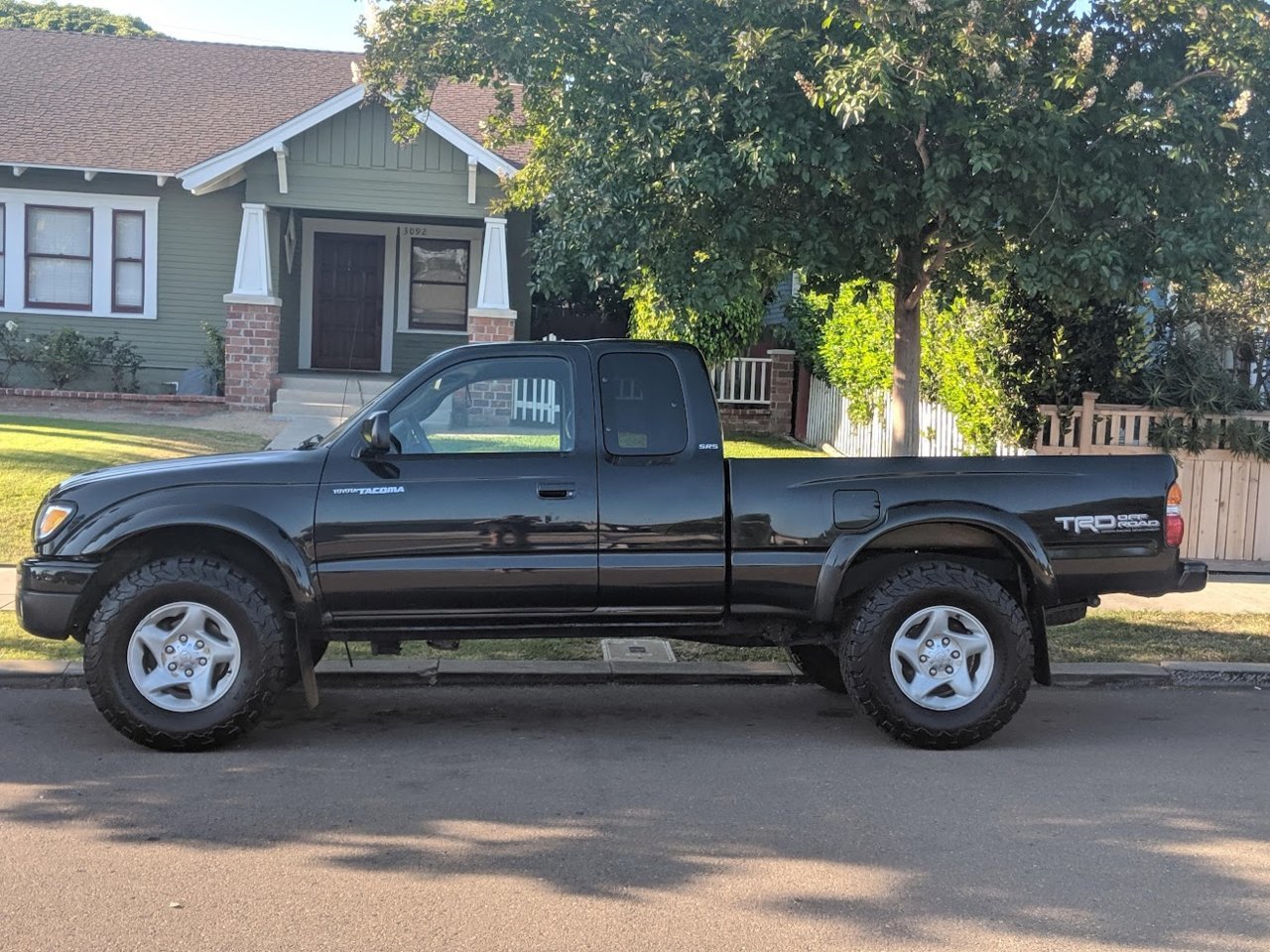

    Before - stock suspension all around:

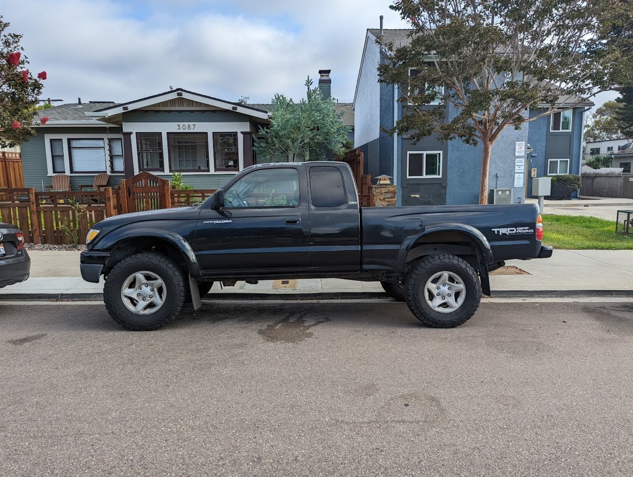

    After, OME Front - 880 Nitrocharger Sport Coilovers, Rear - Dakar Leaf pack + rear Nitrocharger sport shocks
    I'm not happy with the massive amount of front rake. I was hoping for closer to a 2 inch rake but I'm between a 2.5 - 3 inches height diff between the front and the back. I also did not get the advertised 1.5 inch lift in the front, I gained 1 1/8 inch on the drivers side and not even an inch on the passenger side. The driver side with the trim packer leaves me at 37 inches fender to ground and the passenger side is 36 3/4 fender to ground. I thought I would be closer to 37.5 in the front.
    Any Ideas why I only got an inch lift up front? I replaced stock coilovers.
    As for the rear, I'm sure it will settle maybe a 1/2 inch or so, especially once I get a camper shell on it. I think I need to go for the 881 coils to get back to level/1 inch rake right? Pretty sure the 883s would be way too high up front for what I'm trying to do. Any advice is really appreciated.
    Area51Runner and Brake Weight like this.
  9. Aug 27, 2022 at 5:19 PM
    #5229
    Brake Weight
    Brake Weight But it hasn't rained in weeks...I'll make it.
    Jan 27, 2015
    #147363
    2,882
    Deep South near the Third Coast
    Taco pulling 33s and a B6 pushing 33psi
    Weld on sliders, fiberglass shell, 12k winch in an Elite Offroad bumper, front Aussie Lunchbox
    880s are more for the 3rz trucks. I’ve got 881s on mine with a 3rz, plate bumper, and winch. But using middle setting of 5100s. For the rear I’ve seen where people get a couple of big sacks of concrete and place one on each side of the bed between the wheel well and the tailgate. Sort of expedite the settling process. The topper will help as well. If it doesn’t settle lower in a couple of weeks then you can look for a shorter leaf shackle.
    tacogatito and Area51Runner like this.
  10. Aug 27, 2022 at 5:47 PM
    #5230
    Area51Runner
    Area51Runner Well-Known Member
    Jun 26, 2014
    #132748
    12,006
    Northern California, Bay Area
    02 3.4 DC TRD PreRunner 4WD SWAP
    Looks good. Yep, 881s would've been the the way to go. You would not like 883s at all with that stock front end.
    I chose the 881s and Dakars w/AAL for my cap. OME recommends if you're going to be carrying 200 or more lbs then to AAL.
    tacogatito[QUOTED] likes this.

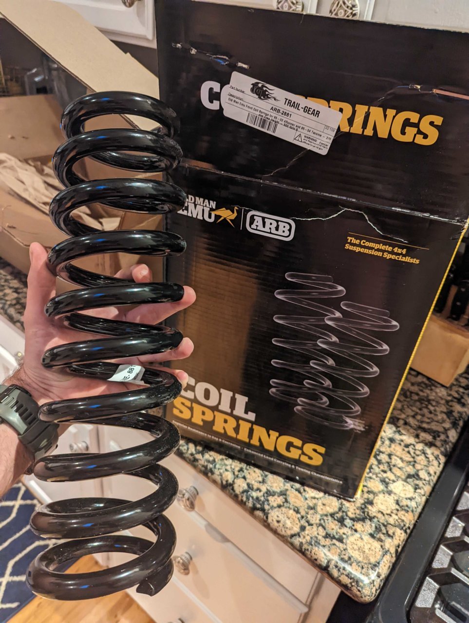

    New coils arrived!
    I'm going to have SD Truck Shop swap em out. I was talking to the shop owner and was asking him his opinion on UCAs. He told me JBAs were junk and was highly recommending me these 'Built Right' UCAs. I understand he has a fabricator here in SD that makes them. Anyone here have opinions on these arms? Seems like nothing but positive reviews from what I've seen but there isn't a whole lot of info on them.
