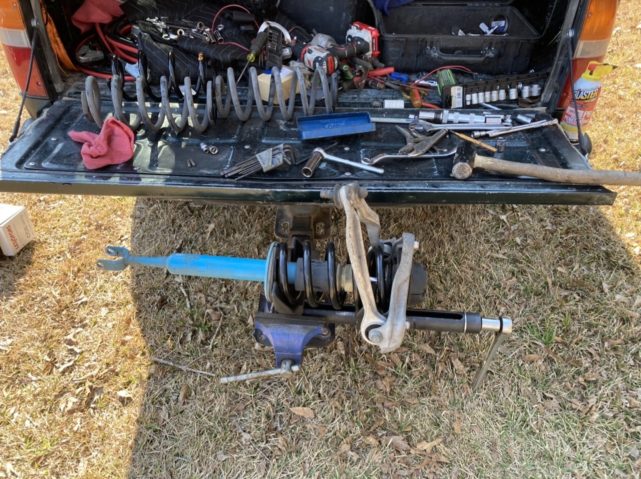

    CV boot mod done? I rebuilt 2 sets of axles to replace boots and finally just bought AZone lifetime axles for almost as cheap as good boots. Straight from the box I snip the metal clamps off the small boot ends, stretch them out as far as I can over the axle, burp the ribs back out, and zip tie them down. They’ll last years this way.
    Tuluk[QUOTED] likes this.
