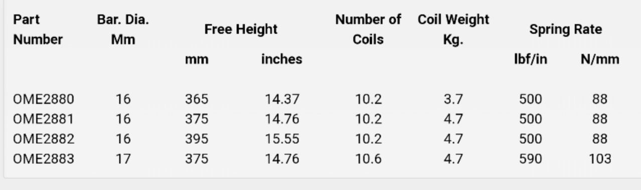

    Oh hell. My bad. I just dug up my DM exchange with Josh over at Wheeler's at the time I picked up the ARB bumper. Ignore the part about the mounting kit (My ARB is from a forum member and I was looking at replacing the mounting hardware).
    Looks like he recommended the 882s if I want to keep my current stance. I still want to confirm that since its not just additional weight from a winch but now includes CVs, front diff, etc. @Wanderlust Bus, sorry bud - 882s are apparently the correct choice - not 883s.
    Also there's this -

    I went thru this back in 2014, started with 881's and a 1/2" aluminum spacer, then went to 883's with a 1/4" spacer, then to 882's, with 1/4" spacer, then removed the spacer and stayed with the 882's.
    The 882's will net the same lift as the 883's with a slightly softer ride and better compression/upstroke. 883's have thicker, but less coils, 882's thinner but more coils.

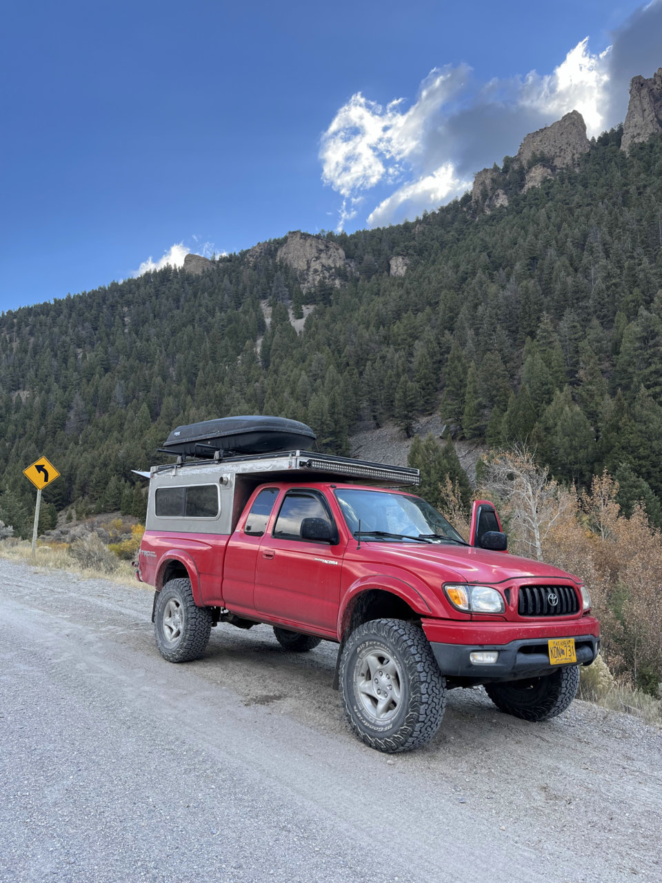

    Full OME kit with 882s and Dakar with AAL in the back. On 33s a 1 inch adapters up front but pretty much stock other than that. Topper probably weights 250-300 pounds

    thats not a topper... its a HOUSE! :rofl:
    Color matched Impulse Red grille FTW!

    what kind of camper? homemade?

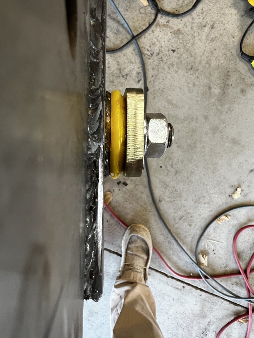

    Can anyone speak to the fit of OMESB121 bushings for the rear frame shackle mount on an ‘03 4WD? I’m using a Safe T Cap replacement with the same inner diameter of the factory one but the bushings had to be forced in (fought the entire way in) and are now bulging around the outside rim. The greaseable pins had to be pounded in. That isn’t right is it? In the pic, that isn’t even tightened. 75B2CED0-E972-4713-A560-7621D342BB2A.jpg

  15. Oct 25, 2022 at 12:08 PM

    1999 trd manual 4x4 ext cab
    I’ve had mine on and off three times now, the greasable shackle has to be tapped in with a mallet, but certainly isn’t difficult. Same with the bushing itself, it’s a very snug fit, but just tapped right in with a mallet
