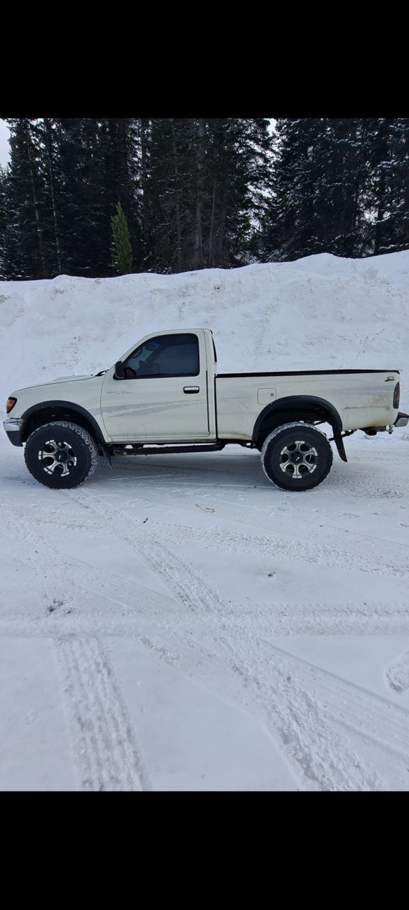

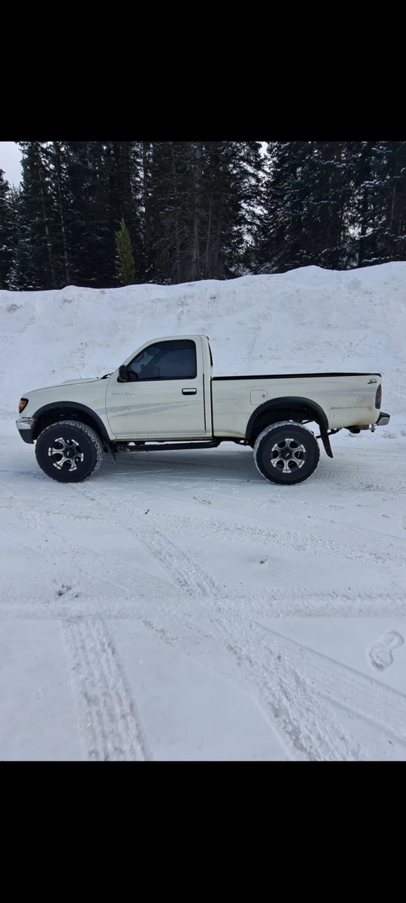

  3. Jan 20, 2023 at 7:33 PM
    #5303
    1997tacomav6
    1997tacomav6 V6 5sp,RegCab,TVS1320 Supercharger,Haltech, 800k
    Oct 5, 2013
    #113940
    10,419
    John
    Denver
    97 reg cab, v6 5sp 300hp supercharged, Methonal Injection, 800,001 plus miles, Original Owner
    V6 5sp,RegCab,TVS1320 Supercharger, 56mm pulley, methanol injected Haltech ECU, AC Tvs1320 supercharger,(MUST DO) every 125,000- 150,000 needs rebuild Projector headlights HID 5 speed manual Amsoil for all drive train Smaller 56mm custom pulley, (MUST DO) 2004 DESNO fuel injectors, zero ping ping, 2004 side door mirrors Dick Cepek Rims, Michelin tires LTX, ATM Pathfinders Dynopro ATM ( that last 100,000 miles) Now running Dynopro ATM mud and snow tires KN cold air intake Cat back dual exhaust with ss exhaust tip, Raised exhaust tail pipe to 2" below body line Optima*dry cell battery,red top Alpine sirius radio, 200 watt amp, focal is165 split door pod speakers Focal door speakers Subwoffer behind seat Viper alarm, Electric Locks Dark tinted windows, bucket seats corbeau lg1 Tacoma Rubber floor mats TRD fender extenders, Bilstien shocks, King shocks JBA UCA trailer iv hitch, electric brake control, Drilled slotted brakes, High carbon steel (MUST DO) EBS green stuff 7000 series pads(MUST DO) TRD engine oil cap TRD stick shift, Marlin crawl shift kit. Rear sliding window 2002 4Runner functional hood scoop cut into Tacoma hood, 4Runner dual overhead map light Gentex Auto dim + Compass + Temp, garage,rearview mirror Snow Methonal kit stage 2 Custom 3 core aluminum radiator Linex bed liner Haltech stand alone ECU, Intake supercharger gauge. Stainless steel brake lines, Custom leather wrapped steering wheel, Haltech stand-alone ECU,
    Got them installed, pulled two of the lower springs out,
    She rides great but the back is still 1.5” higher than where I want it to be so that it’s level with the 2” lift on the front from the kings.
    I put 400 pounds of sand bags in the back and that makes it level,
    Any tricks to getting the back end to settle 1.5” down?
    Drive it with 400 pounds of extra sand in the back for a month?

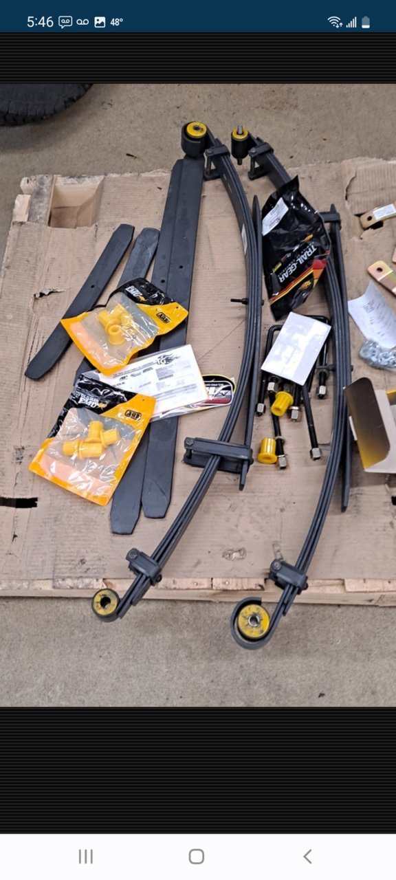

    I think I found out my problem,
    The install shop ordered CS018R OEMS, apparently they don’t make a rear spring for the single cab 95-97,
    Makes sense, going to return them and get Deavers I guess,
    I bet the springs that were ordered are for the 98 single cab which would be a little longer hence the 2” lift after two leafs were removed

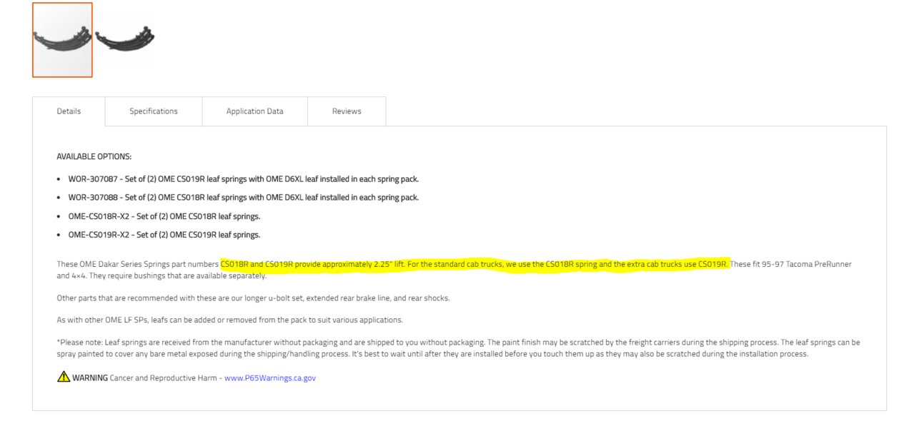

    Found this over on LowRange's site -
    https://lowrangeoffroad.com/dakar-leaf-spring-set-for-1995-1997-tacoma.html
    1997tacomav6[QUOTED] likes this.

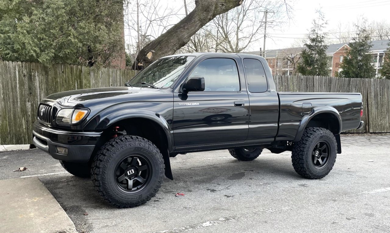

    My truck is higher in the back with the Dakars but I don’t mind it. Sits pretty level with weight in the bed or towing my trailer.
    ontarioyota and 1997tacomav6 like this.

    It’s strange I did too just now but if you go to the old man’s website I don’t see them available there, nothing for 95-97,
    Totally lost and confused now, I measured again today and I’m at 2.5” too high with two leaves removed, does not make sense
    Area51Runner[QUOTED] likes this.

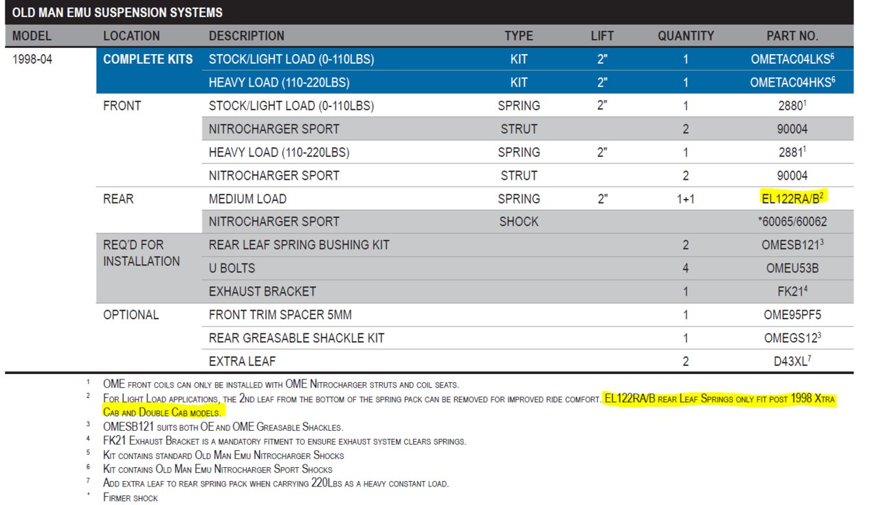

    Northern California, Bay Area
    02 3.4 DC TRD PreRunner 4WD SWAP
    Yeah, ARB really purged their spec/product sheet. Saw that too. Nothing for pre-98 and nothing for standard cabs.
    Maybe confirm the pack that you received is in fact the CS018R. Sorry man, frustrating as hell I'm sure. Sucks.
