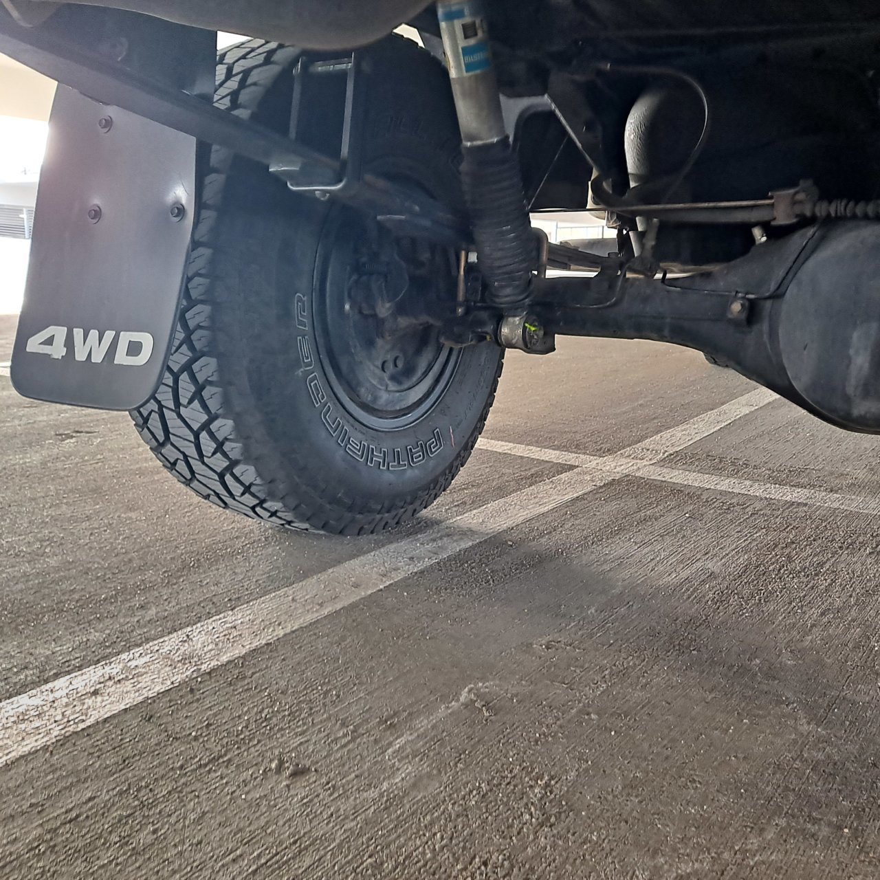

    That’s the plan for now, hopefully they come down an 1” at least and I can live with that
    If I was loaded down more like your setup with an extra 200 plus pounds they actually would be perfect.
    With 300 400 pounds in the rear it’s perfectly leveled with a 2” lift with the kings upfront. FYI for anyone else wanting that setup with these springs

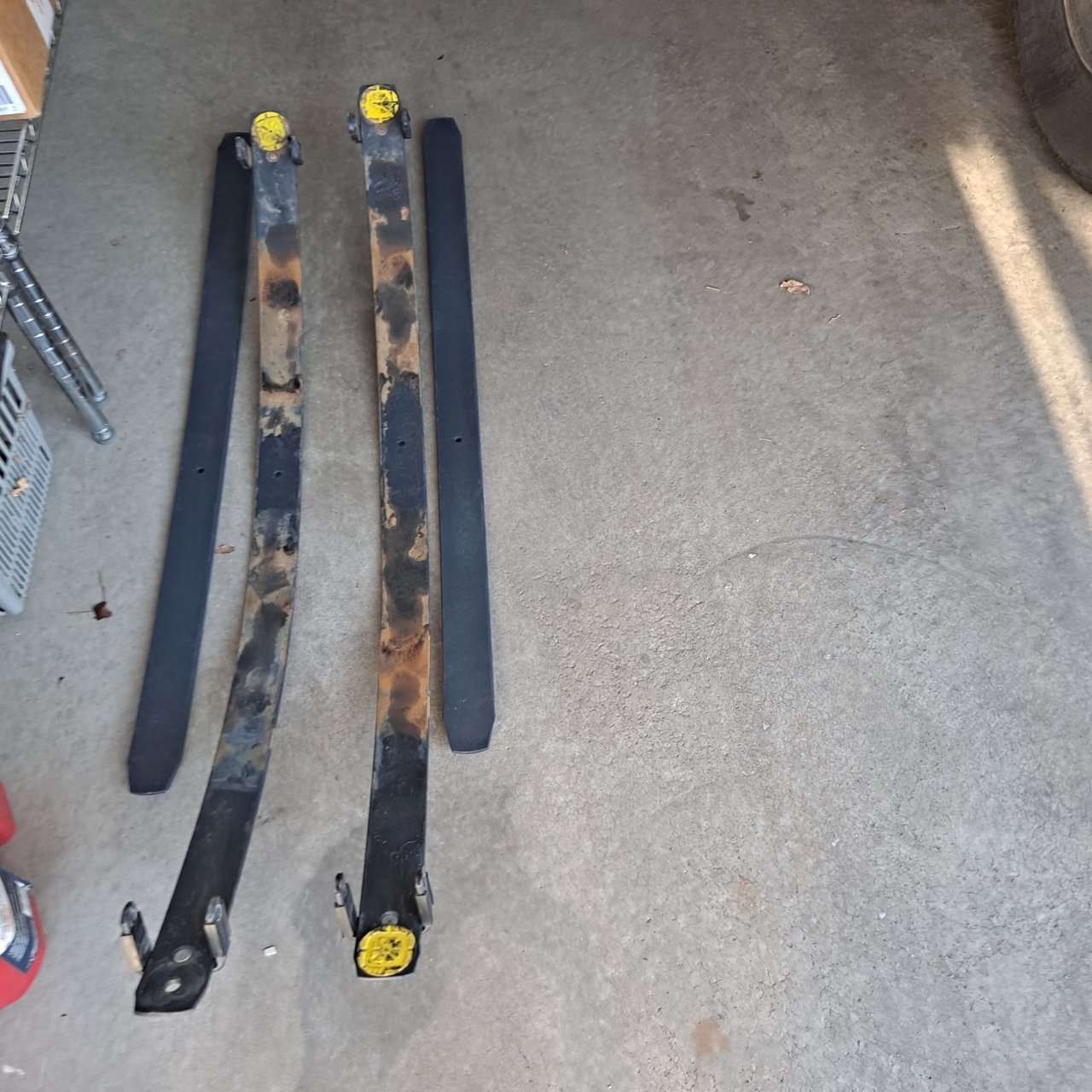

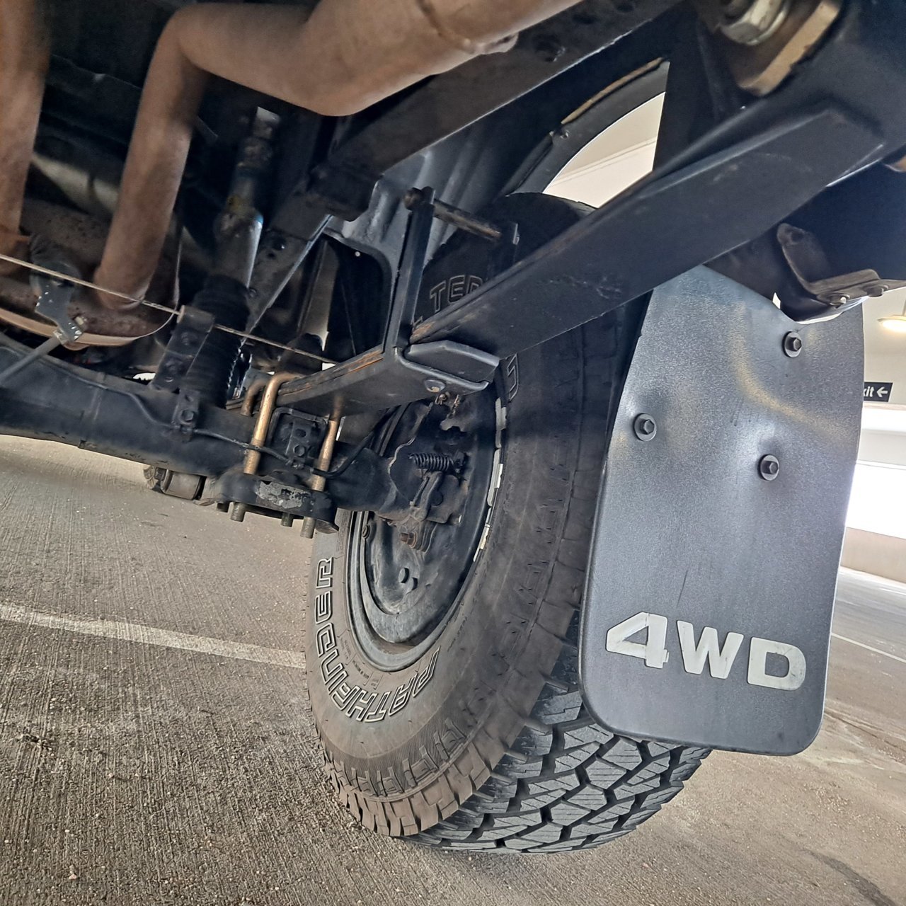

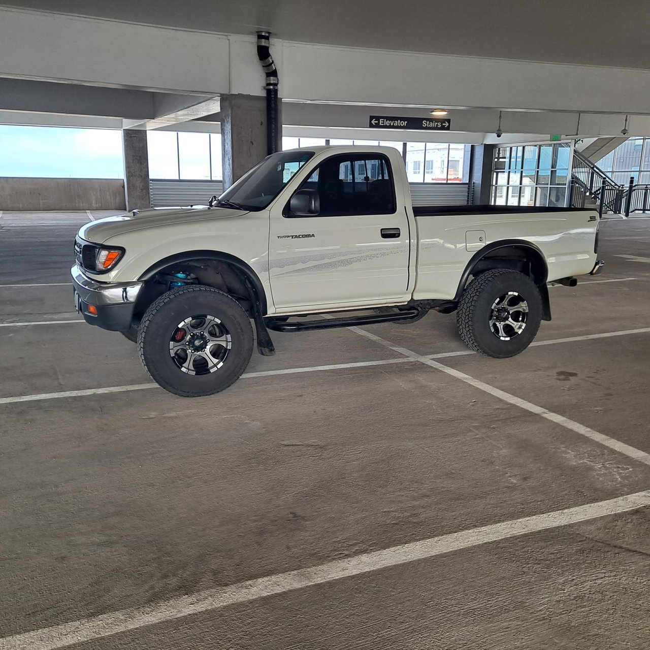

    An update on the CS018R OME Springs,
    So I called OME and they said they don't make a spring pack for the 1995-1997 tacoma trucks,
    The CS018R springs pack is actually for a Hilex pickup
    These springs can be used for the 1995-1997 single cab BUT need to be modified.
    The hillex weight is 4500 lbs and the single cab is 3200lbs.
    So if you install the complete 6 leaf pack you will have a 4" lift or so in the back.
    So if you want a 3.5" - 4" lift these will work or if you plan on 300-500 pounds in the bed they will work.
    Im shooting for 2" lift in the back with kings up front that give the front 2" lift.
    Passage side I removed the 3rd spring from the top and 2 of the overload springs and this gave me my 2" lift at the rear and now im level.
    On the drivers side I removed the 3rd spring from the top and ONE overload spring so the drivers side is raised the thickness of the smaller overload spring 1/2" to help off set the taco lean.
    It rides very smoothly now and adding 400 pounds of gear flexes the rear about an inch or so down
    happy with the outcome and finally leveled!
    Below are the 2 springs I removed from the original 6 leaf pack

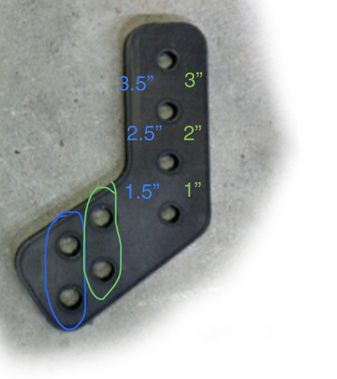

    This look right to you?
  8. Feb 20, 2023 at 10:03 AM
    #5328
    Nessal
    Nessal Well-Known Member
    Dec 30, 2012
    #94081
    1,433
    Texas/Bay Area
    2003 V6 4X4 TRD DCAB
    My rubber piece is more flat than yours but prob work just fine
    Area51Runner[QUOTED] likes this.

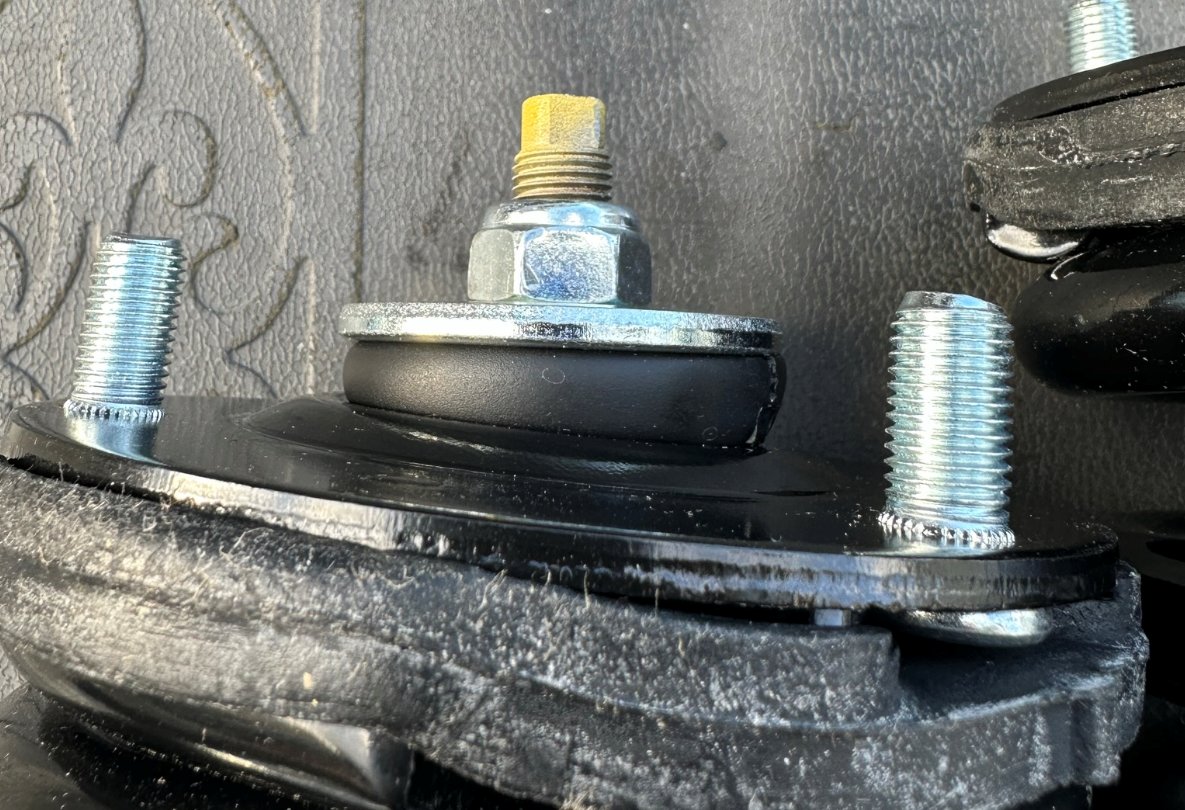

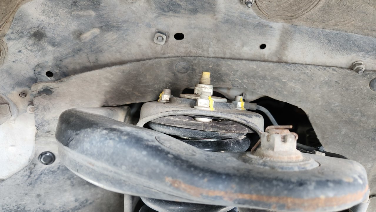

    Post a pic of the bottom of your spring. It almost looks like the spring is upside down.
  12. Feb 23, 2023 at 3:56 PM
    #5332
    Area51Runner
    Area51Runner Well-Known Member
    Jun 26, 2014
    #132748
    12,007
    Northern California, Bay Area
    02 3.4 DC TRD PreRunner 4WD SWAP
    Ouch. Even though these were a Wheeler purchase, they were shipped out of trail gear. The assembly people over @ trailgear need to take some pride in their work.
    These are both going to be re-done. Not going to trust their work. Plus that trimpacker wasn't put in.

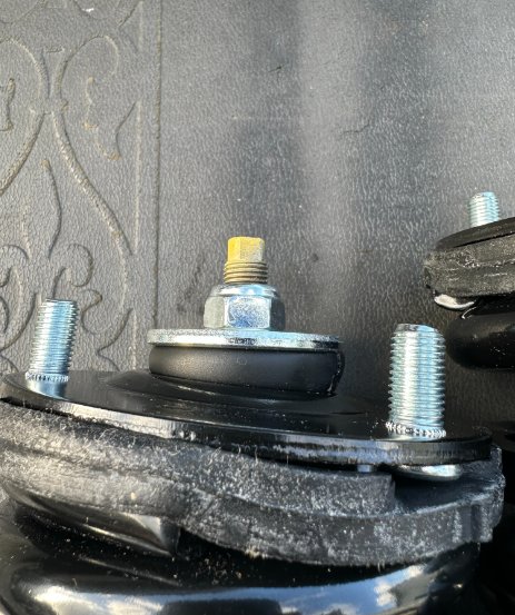

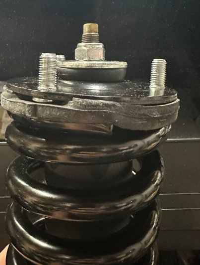

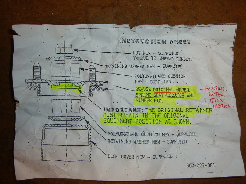

    So broke down the crap assembly trail gear did yesterday using an OTC Strut Tamer compressor (bad ass btw). Didn't notice it yesterday but ran into an issue when I looked at the driver side this morning.
    ISSUE: The bottom metal cushion retainer rattles around, and has about 3-4mm of vertical play on the shaft of the shock, and the dust cover is loose and rattles.
    I must have botched the install since it wasn't rattling/had that much play before.
    Install instructions below. Found a more legible copy than what I received. @scocar uploaded some time back, those are his notes in red, not mine) -
    Everything is there but there is movement. Not sure why. Any ideas?
    If anyone has a better assembly approach, please suggest away. Kind of burning out on assembling these things and getting ready to toss them in the parts bin and forget about them for a year or two lol.
    These are 2882 coils with nitrochargers.
    Thanks!
    EDIT: FWIW, according to the instructions you're supposed to re-use your OE retainer but these were fully assembled by trail gear. So whatever top hat/spring seat locator they used must've included it.
    2002Tacoma4x4 likes this.

    Based on their shit work, I don't think it is reasonable to assume they did. Someone was poorly trained, or not trained, or high as fuck.

    So finally resolved this coilover nightmare - thx Wheeler's/TG. Disassembled, trim packer added, reassembled. Scratched them up a bit but it's done.
    2882s ready to go on once I decide on a winch and possibly dump stock skid for aftermarket. Truth be told these springs are probably going to end up sitting in the box for ?? months. Not in a rush.

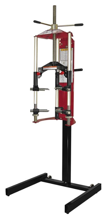

    Ended up using this compressor -
    https://www.amazon.com/dp/B01DP2CDJU
    Felt completely safe. Took a few minutes to figure out the best way to seat the 'jaws' on the coil spring but it worked without issue - even used the impact on it. Impressed with this compressor.
    I do still want that Brannick 7600. Just can't justify that 1500+ price tag.

  17. Mar 12, 2023 at 10:17 AM
    #5337
    Brake Weight
    Brake Weight But it hasn't rained in weeks...I'll make it.
    Jan 27, 2015
    #147363
    2,882
    Deep South near the Third Coast
    Taco pulling 33s and a B6 pushing 33psi
    Weld on sliders, fiberglass shell, 12k winch in an Elite Offroad bumper, front Aussie Lunchbox
    I bought one of these compressors last year and have used it at least 8 times between finding the coils I wanted for my b6 Avant and swapping struts on my Tacoma. Will be using them in a few weeks to swap in some 883s. I have a receiver hitch mounted bench vice from HFreight and simply clamp the compressor into it and use the tailgate as a work bench.
    Area51Runner likes this.
