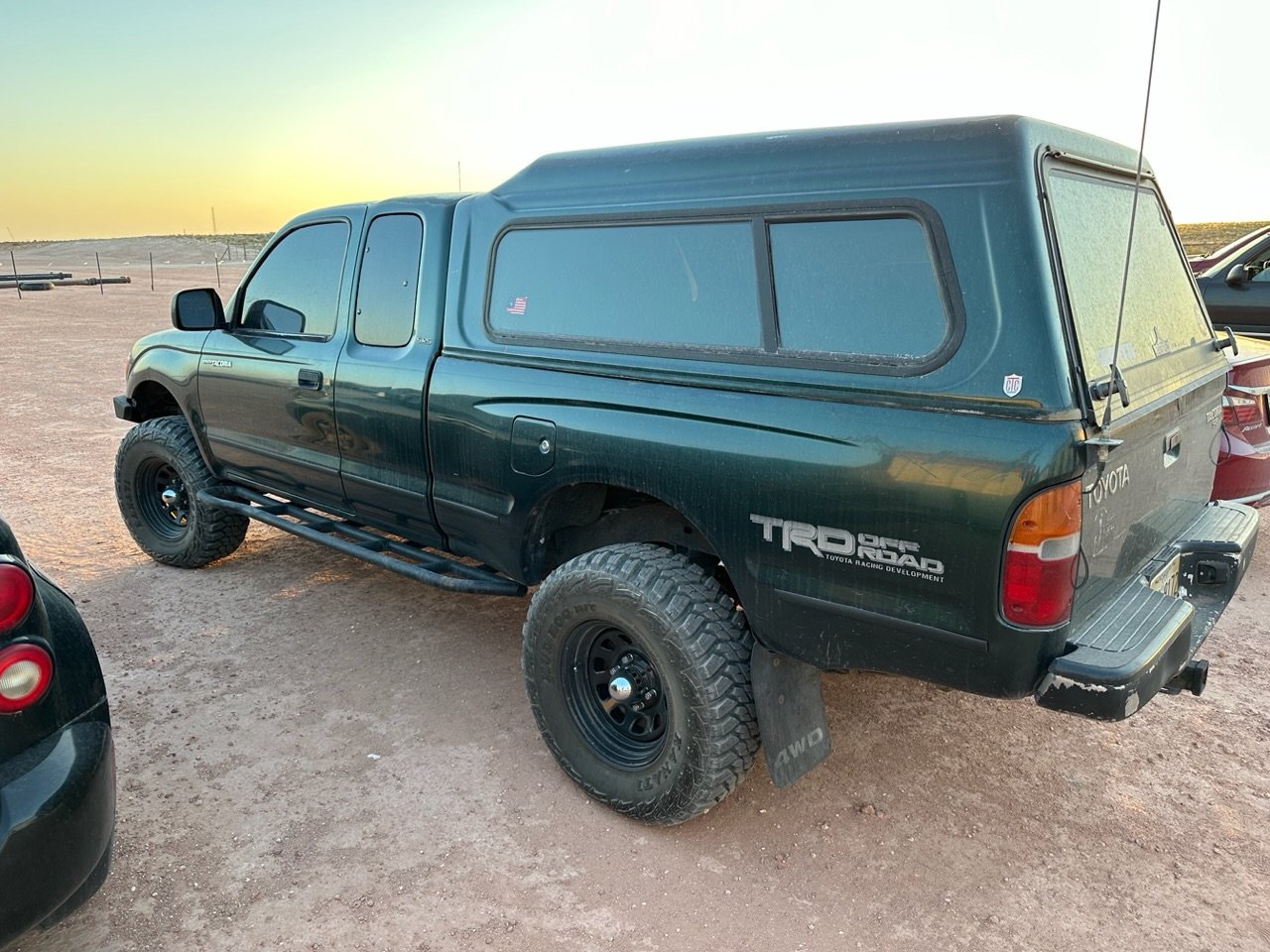

    I am an old man here is my Emu This is a100_0101.jpg 100_0314 (2).jpg Birds eye view

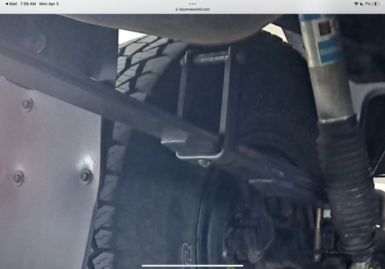

    Because my OME pack CS018R is actually a hilex pack for a 4500 pound truck the 6 leaf pack is now a 4 pack for my 3200 pound truck.
    How much should I cut this rear bracket down to?

    Whoa! Yeah, definitely needs to be trimmed. Have no idea to be honest. If I had to do it, maybe leave about the same amount of space as a normal pack has? :notsure:

    Drill the holes before cutting it shorter.

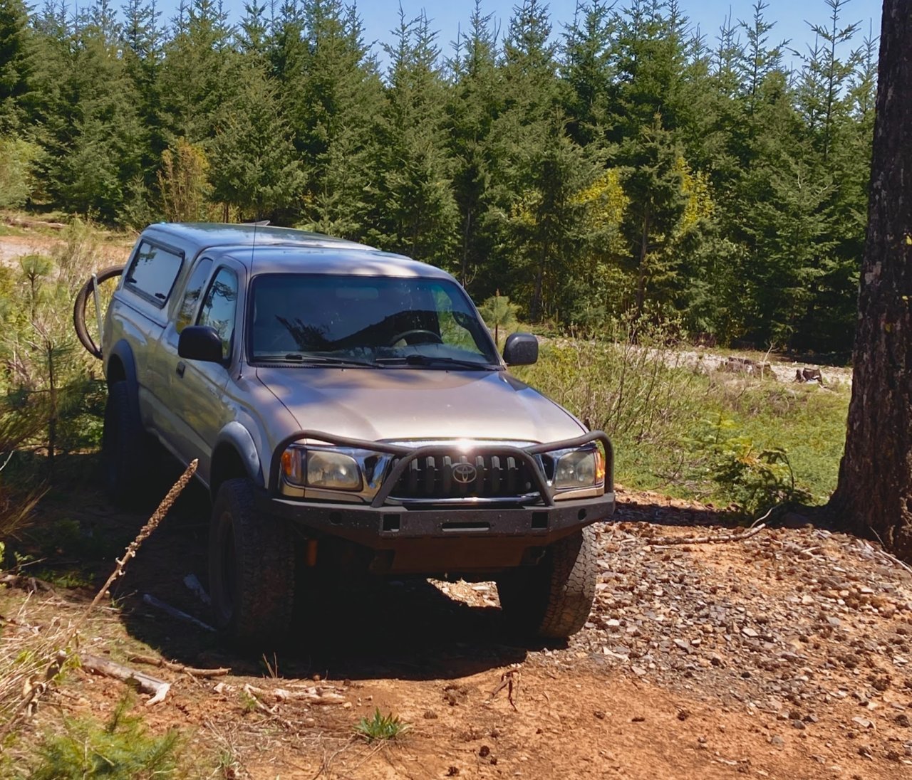

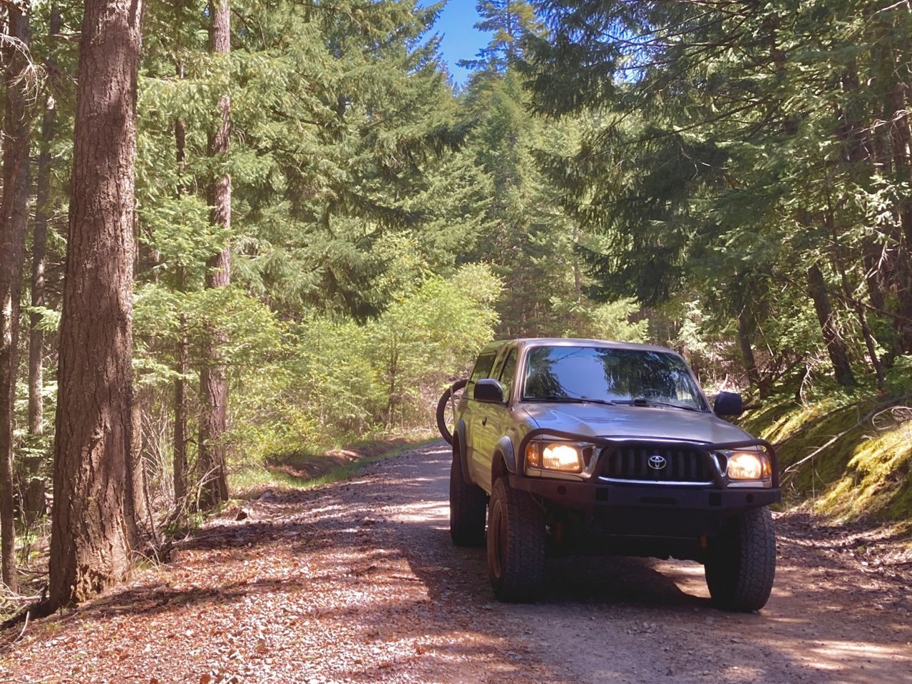

    Little late to the party but heres mine:
    03 Xtra Cab
    285/75/r16 Tires on Steelie 16x7.5 rims
    Old Man Emu Shocks, with 881 Coils
    Wheelers Off road 3 leaf Progressive AAL
    ~ 2.5 inch lift + level
    Check Out my Build!

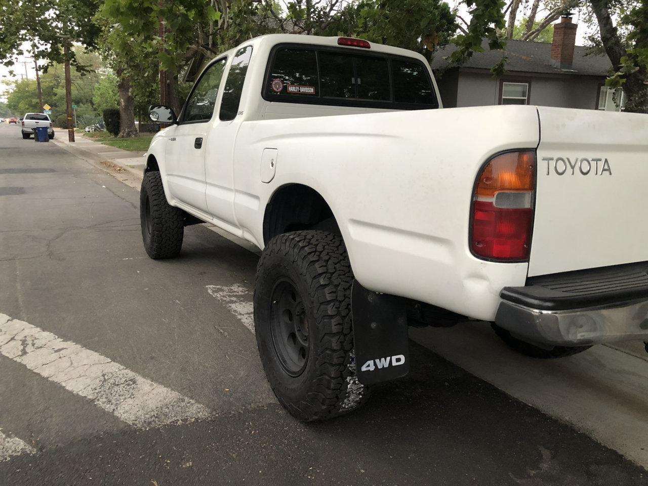

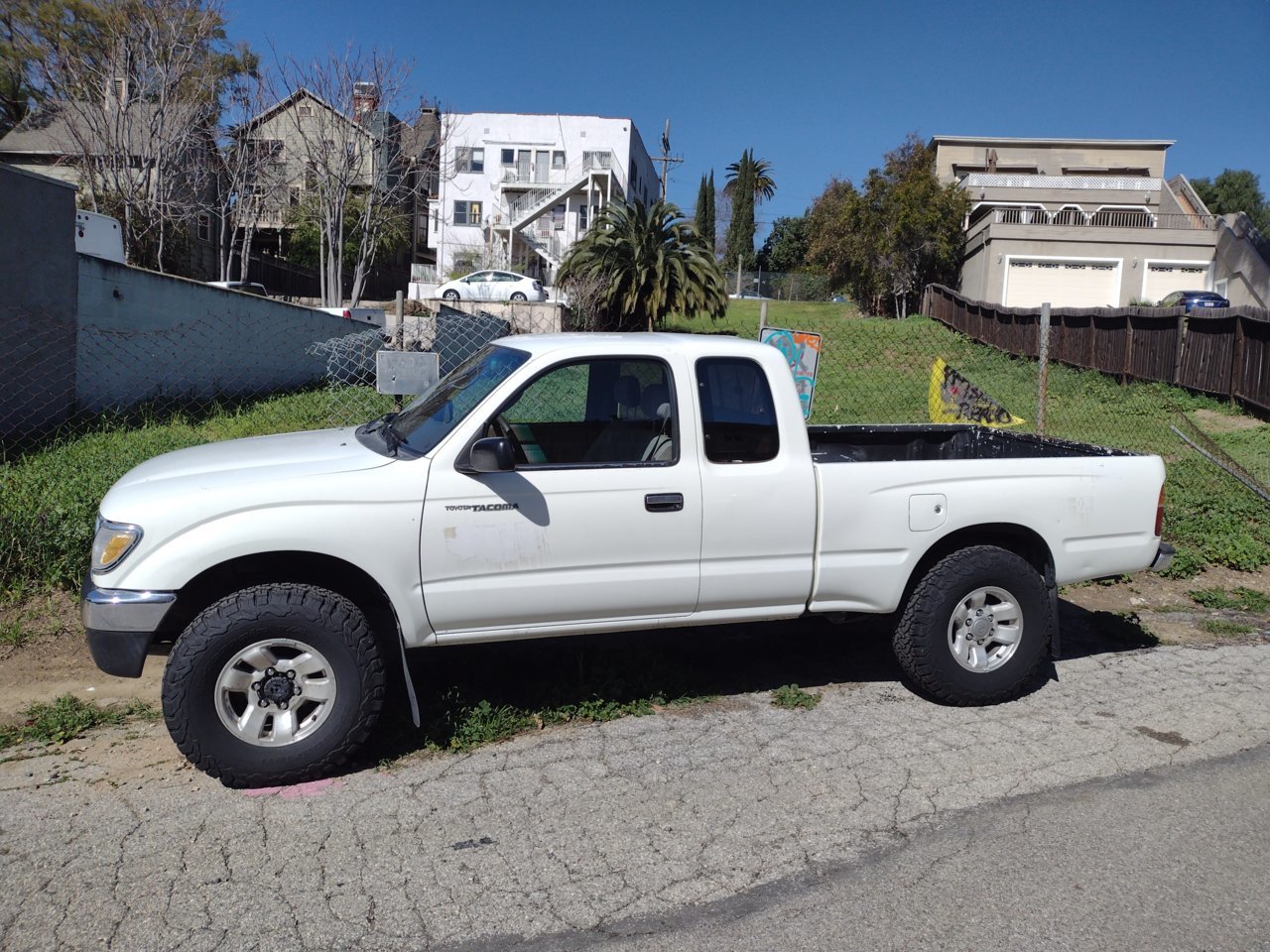

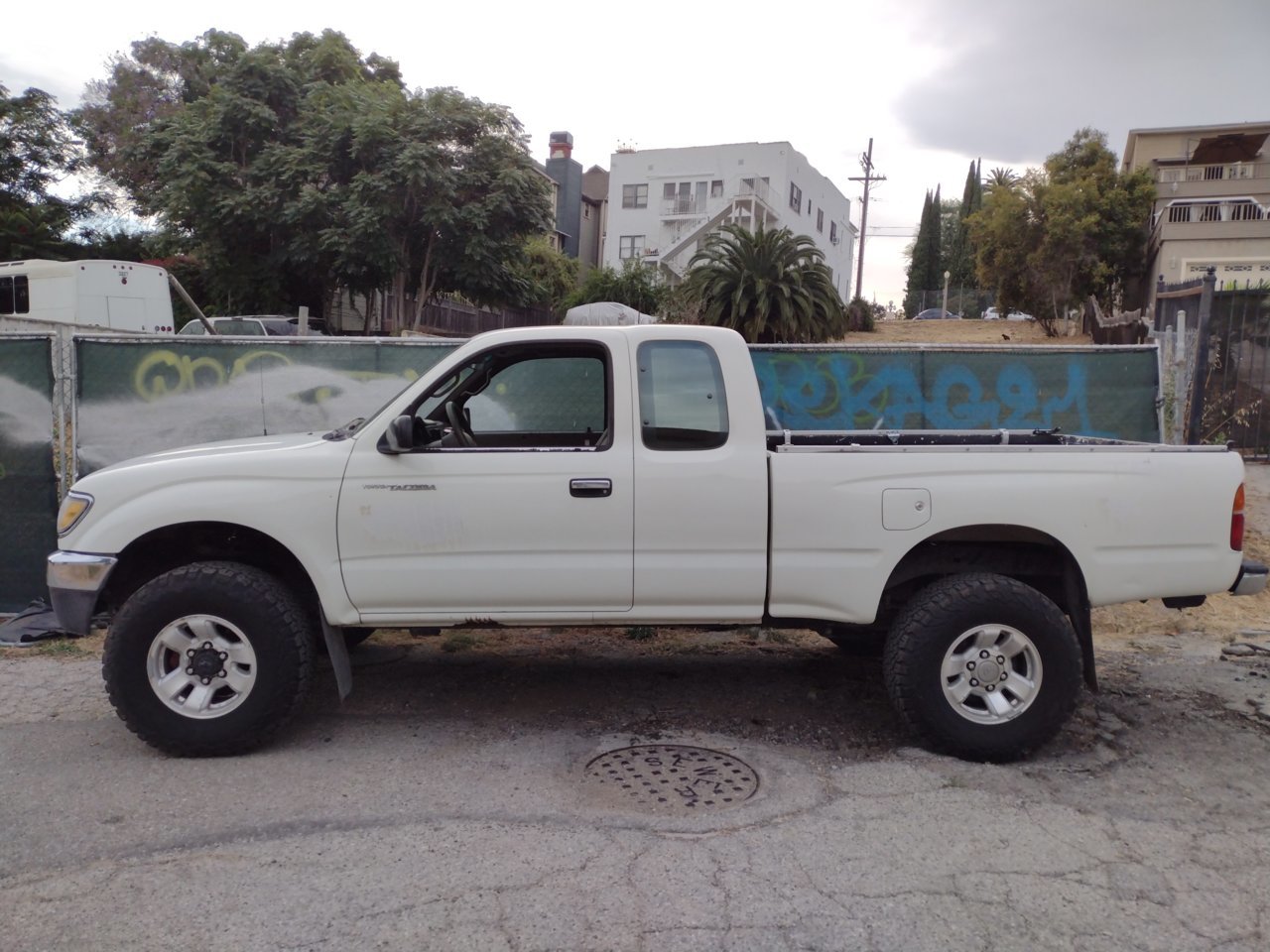

    Man, I read this thread till my eyes bled. Here is mine. 1997, 2.7L, 31x10.5 tires, 4x4.
    Old suspension was completely clapped out. It rode like a boat. 188K miles.
    Did OME shocks all around, 880 coils up front, Wheelers 3 leaf progressive in the back, kept the stock overload spring in there. Got just under 2" in the front and about 2" in the back. Has about a 1" rake. Rides great except for some driveshaft vibrations at 25mph. I'm hoping the coils in front don't sag too much cuz it's perfect for me right now.
    Before and after photos below.

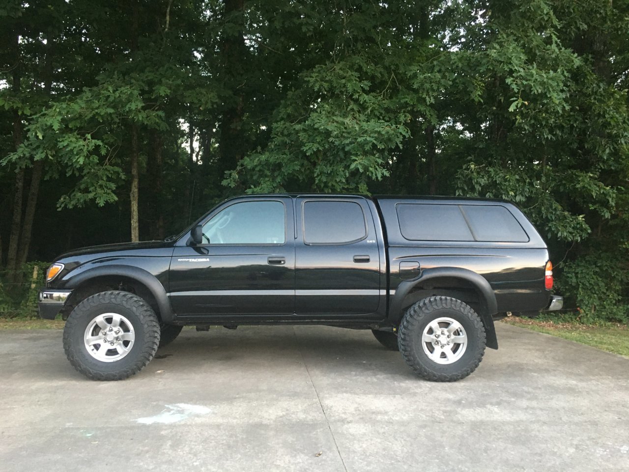

    Ima say get the 882 instead 881. I’ve got a plate bumper, winch with steel cable, and no extra skids and it sits decently. Think I’m on second notch of the 4 notch 1st gen Tundra 5100 struts.
    Most current pic on my phone. 31/1050-15s. Leafsprings are a homemade pack out of 2sets of leaves.
