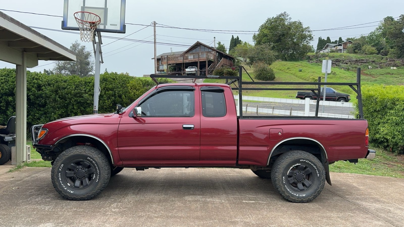

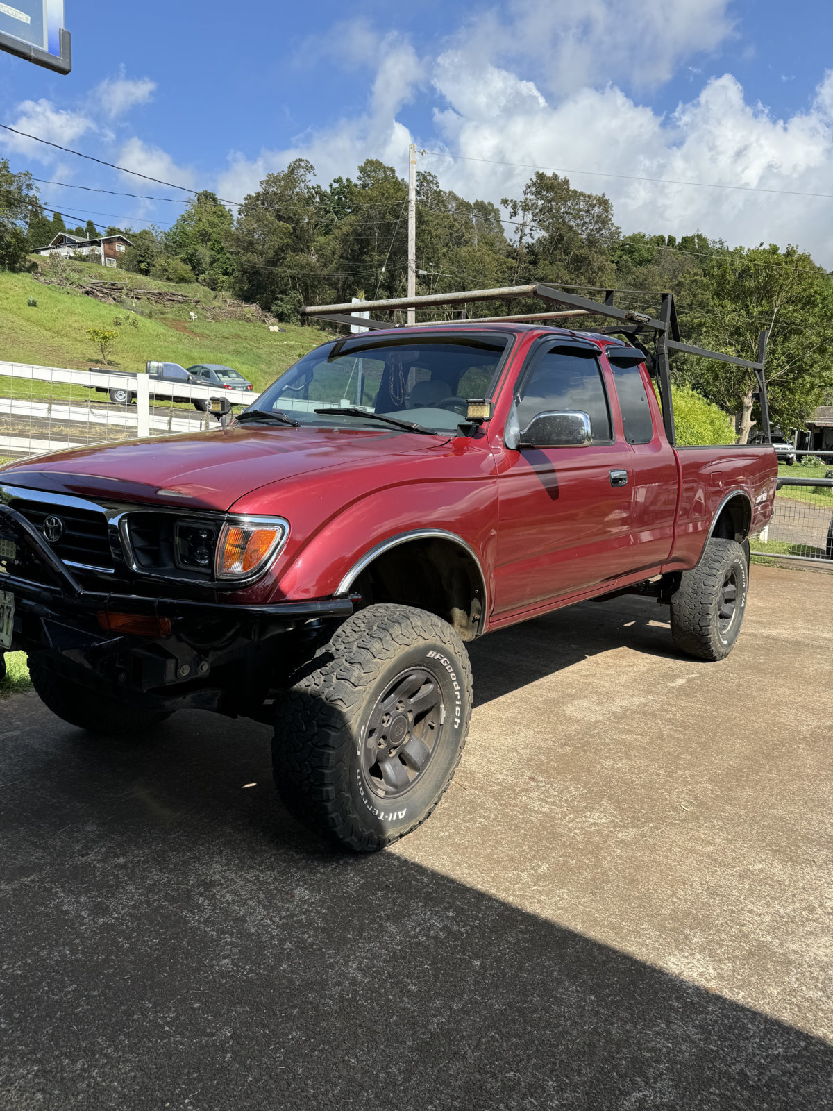

    MAUIAUSTIN
    MAUIAUSTIN Well-Known Member
    May 27, 2016
    #188067
    92
    Austin
    Maui, Hawaii
    1995 Ext. Cab 4x4 SR5

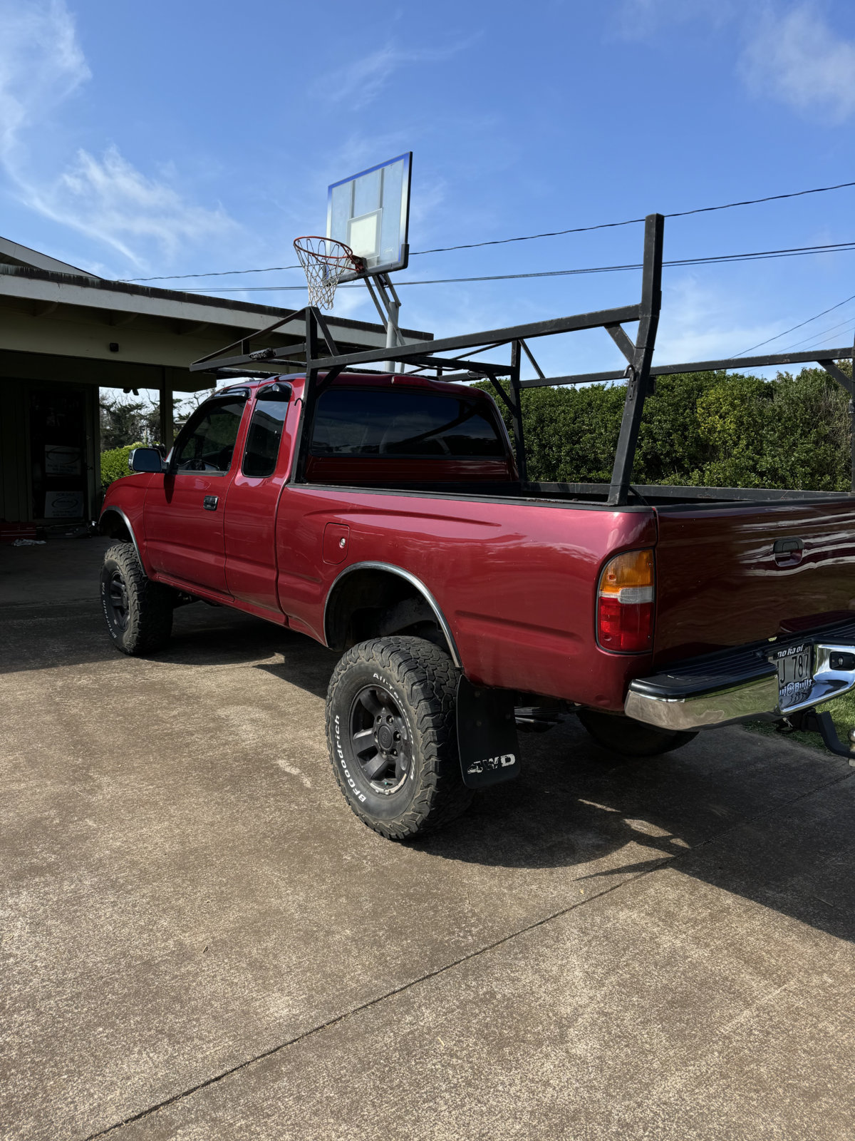

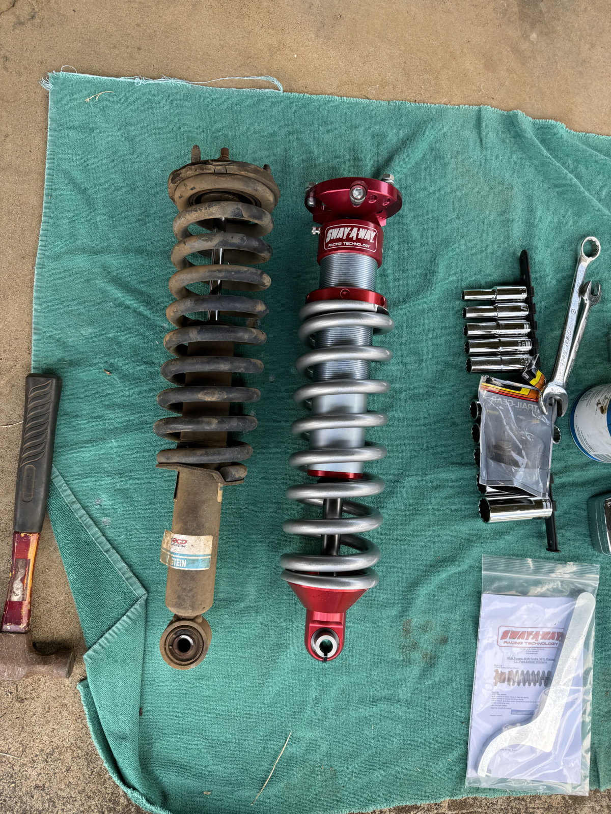

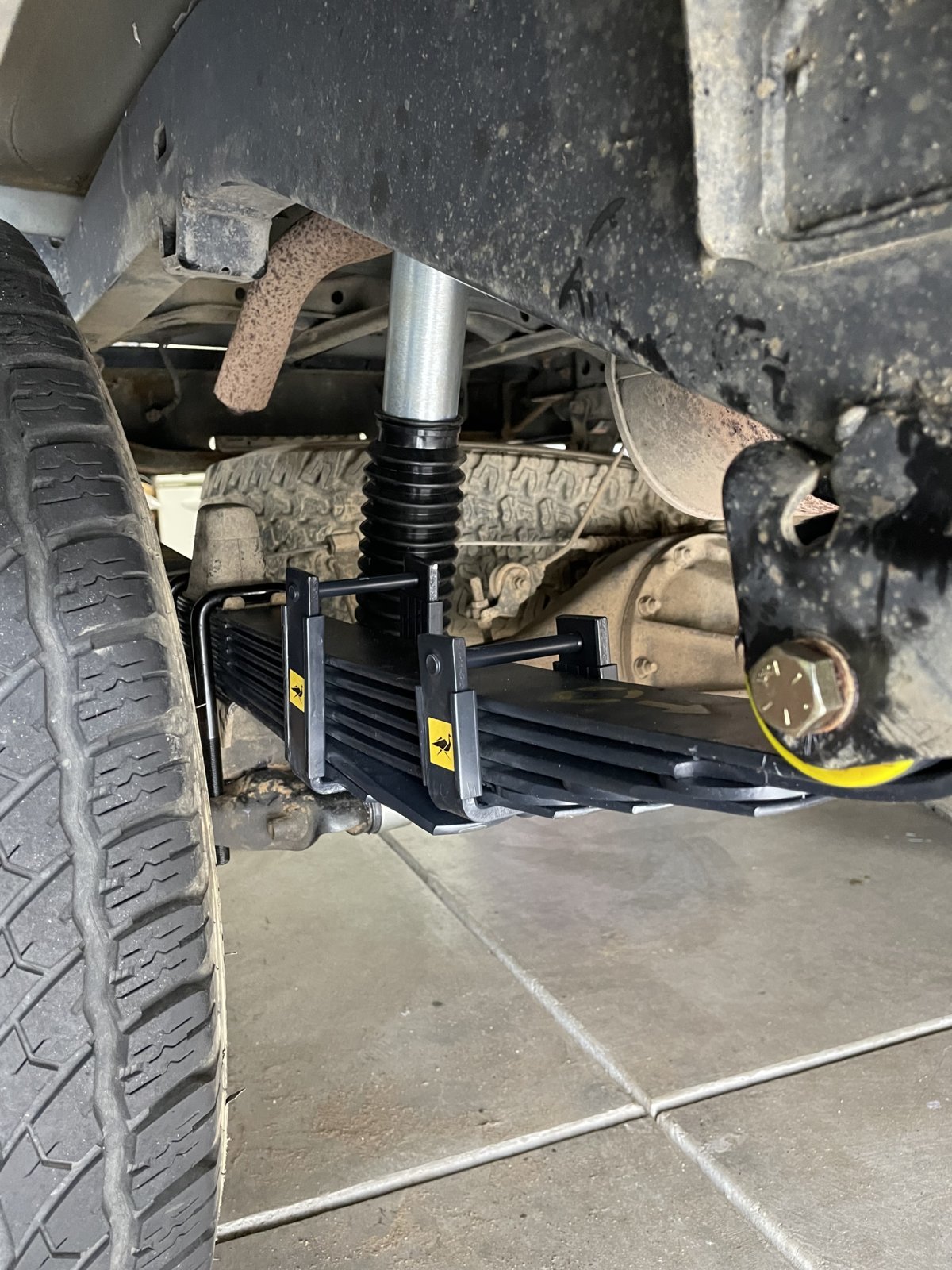

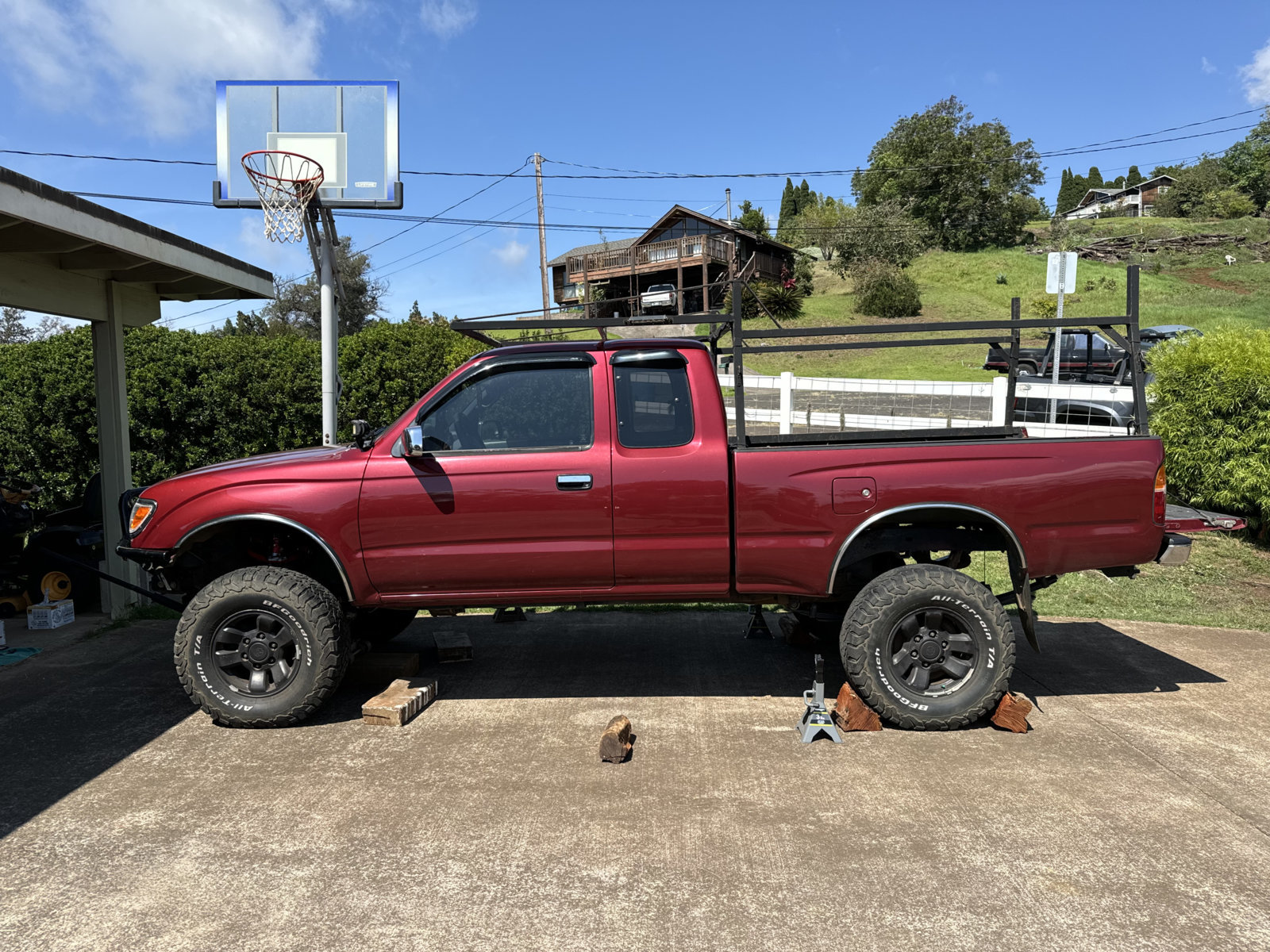

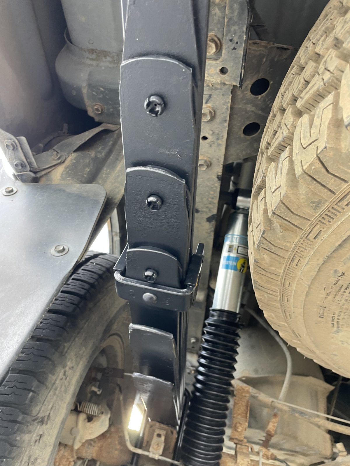

    Sway A Way 2.5 Coilovers JBA Upper Control Arms Old Man Emu CS019R Leaf Springs Old Man Emu Stock Length Greasable Shackles 10" Travel Bilstein 5125 17" DX4 Terrain Wheels 265/70 R17 Falken Wildpeak AT3
    Sway-A-Way 2.5 Coilovers, JBA UCA's, Old Man Emu Dakar CS019R Leaf Springs (no AAL), Old Man Emu stock length Greasable shackels.
    Before the lift sitting on 5100's at middle setting with sagging coils and an AAL in the rear sagging leaf pack.
    [​IMG]The Replacements:
    [​IMG][​IMG]The Results:[​IMG][​IMG][​IMG]
    If anyone has advice or experience on extended length rear shocks for excessive lift situations, check out the discussion thread I just started with my detailed problem with the dakar leaf pack lift and shocks. https://www.tacomaworld.com/threads/1995-tacoma-rear-shock-advice-with-pics.834800/
    time623 likes this.

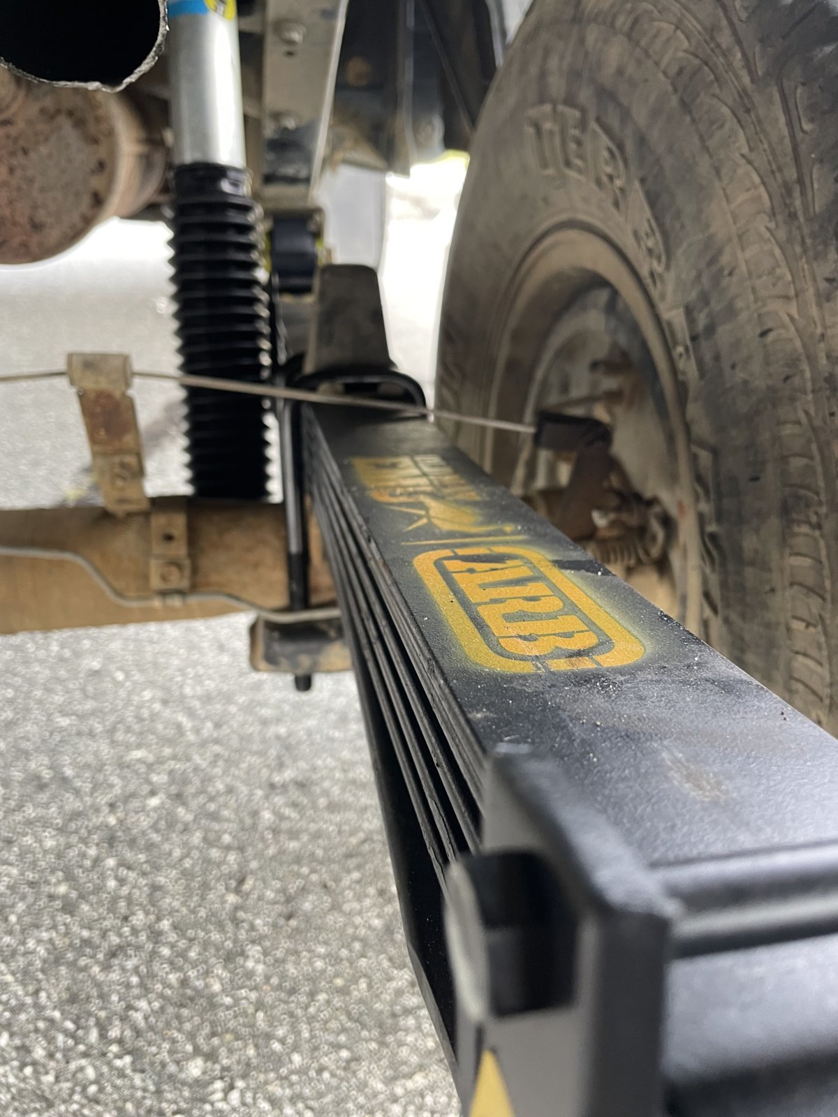

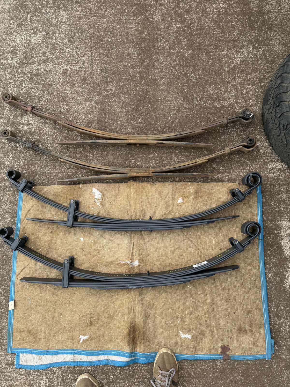

    Installed new leafs this weekend, OME CS019R
    There seems to be some confusion about the bushing kits for these leafs with stock shackles. Wheelers Offroad, posts in this thread, and various other posts across TW all recommend the SB89 Bushing Kit if you have stock shackles. The SB89 kit did not fit the leafs, regardless of whatever shackles you have. The front leaf eye was a significantly larger diameter than any of the bushings included in SB89.
    I am quite confused how the SB43 kit is marketed for the OME shackles, while the SB89 kit is marketed for stock shackles, when the bushings are the same for the shackle side and different for the frame perch side.
    The SB43 kit worked perfectly, though you do need two additional 181469 bushing spacers than just the two included in the bushing kits. Most post I've seen do include a note to buy (2) 181469 bushing sleeves, but never notes that that is an additional 2 from the 2 you get in the bushing kits. I was probably just slow to not pick that up, but I figured I'd specify that here for anyone else looking to install these in the future.
    StreetTaco95 and MAUIAUSTIN like this.

    MAUIAUSTIN
    May 27, 2016
    #188067
    92
    Austin
    Maui, Hawaii
    Looks great with the rear end of the truck picked back up. let those springs break in a bit an youll notice they ride quite nice and haul weight like its not even there. I came across the same dilema with bushing kits and the possibility of needing the addtitional 181469 bushing sleeve reducers. I ended up going with the OME greasable shackles so i didnt need the sleeves but i still ordered them incase i changed my mind and wanted to use oem shackles. in the end 2 full OME SB43 bushing kits were needed to install the CS019R Leaves WITH OME SHACKLES. If your are using stock shackles you will need those bushing sleeve reducers. Great job @time623 at navigating that mess of a system. Hope you enjoy your new leaf pack for many years to come. Maybe someday i may remove a leaf or two to soften it up but i actually like the way it rides now that its broken in!
    time623[QUOTED] likes this.

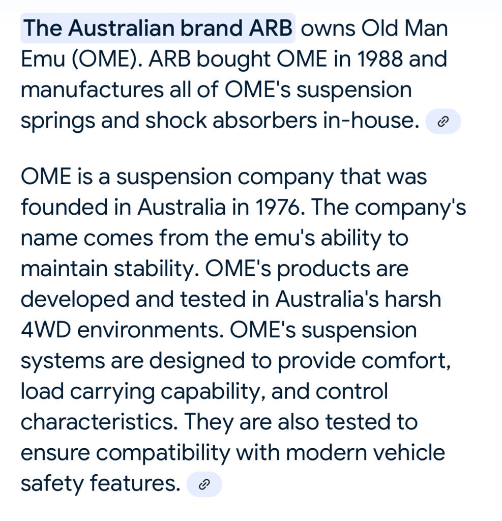

    Old Man Emu made those springs. ARB may have marketed them but OME makes hundreds of springs catering what seems like a Toyota based market.
  18. Sep 5, 2024 at 10:33 AM
    #5378
    Speedytech7
    Feb 20, 2014
    #123587
    58,557
    FCQM+VG Cheney, Washington
    It's less Tacoma and more mod
    OME is an ARB owned brand entirely. They're one in the same
