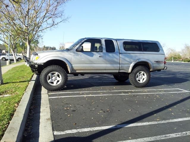

    Here's a pic of mine after I got the 255/85-16 Cooper ST's mounted yesterday. I'm gonna wheel it tomorrow and see how it does.

    :thumbup: looks nice!!
