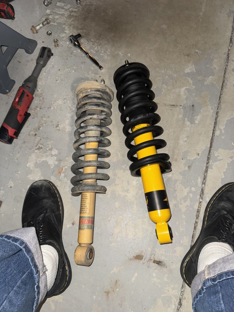

    Alright! After all the research, consideration, and labor, the Tacoma is riding proud with Nitrocharger Plus shocks on all four corners and Dakar springs in the rear. With information gained from Cruiser Outfitters, I believe my first gen is one of the first installs of the new generation of the Nitrochargers (Nitrocharger Sport -> Nitrocharger Plus; [880, 881, 882, 883 coils] -> single coil option with adjustable coil seat)
    I decided to tackle the job in my garage to save some $$$ ... While I did save the money, I sure as hell lost a lot of time because this job took me and two of my buddies about 25 hours of labor... LOL - and then an additional 6 or 7 for me to replace the tie rods and LBJs. Admittedly, I am a novice mechanic at best, so this project taught me boat loads of skills and ultimately boosted my confidence for future projects.
    The Front End

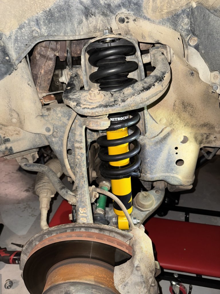

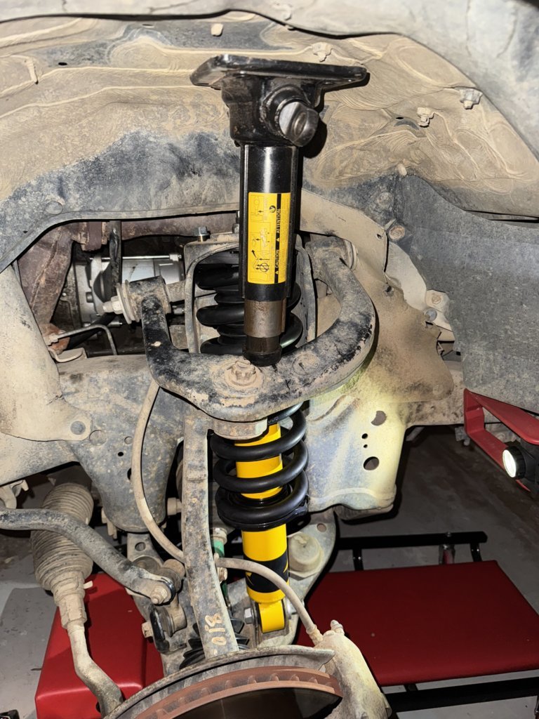

    I was able to complete the front end in one evening's worth of work. Pretty much everything was smooth sailing, and I was stoked to have 0 seized bolts in the front end. Only hiccup for me was getting the lower shock mount to align with the shock. I ended up using a bottle jack to push the UCA down... pretty ghetto, I know :)
    22 year old Shock vs. New Nitrocharger Plus
    Bottle Jack Method
    Shock Mounted

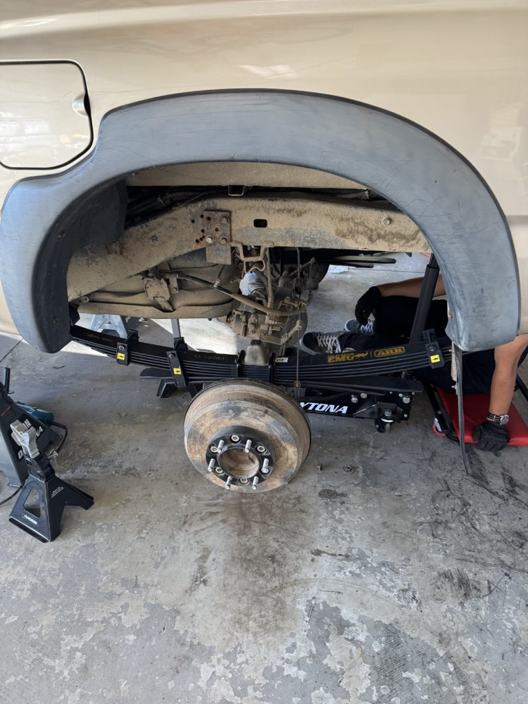

    The rear of the truck was easily the most difficult portion of this project. The commonly seized bolt on the front leaf mount was seized on my truck (of course), so it took an angle grinder and some high quality Sawzall blades to cut those hardened steel bolts out. Again, I'm a novice mechanic so it was pretty much my first time using these tools... Would've been faster if I had more skill like you guys!
    The next challenge was the fact that my stock shackles were seized. I ended up using a blow torch to essentially melt the rubber bushings on the stock shackles so that I could pull them off the mount. They were replaced by OME Greasable Shackles which should hopefully never seize.

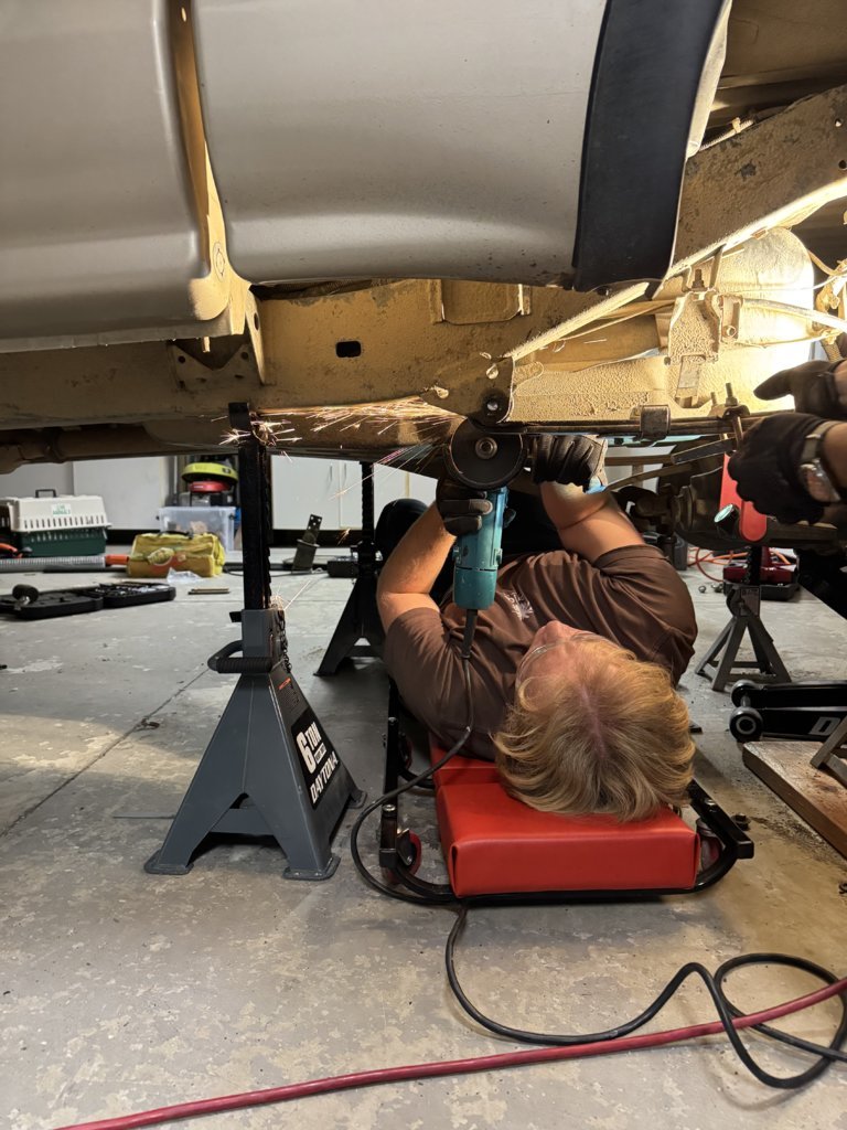

    Lastly, to fit the massive Dakars in the back, the axle had to be dropped pretty far. I ended up unbolting the brake hardlines from the axle so that I could get it to fall far enough downward. I was really thankful to have my buddies in the garage with me to help me lift the springs into place... they're huge and awkward to maneuver, so this was essential IMO. I am shocked that people do this solo.
    Angle grinder go brrrr
    Dakars are mounted!

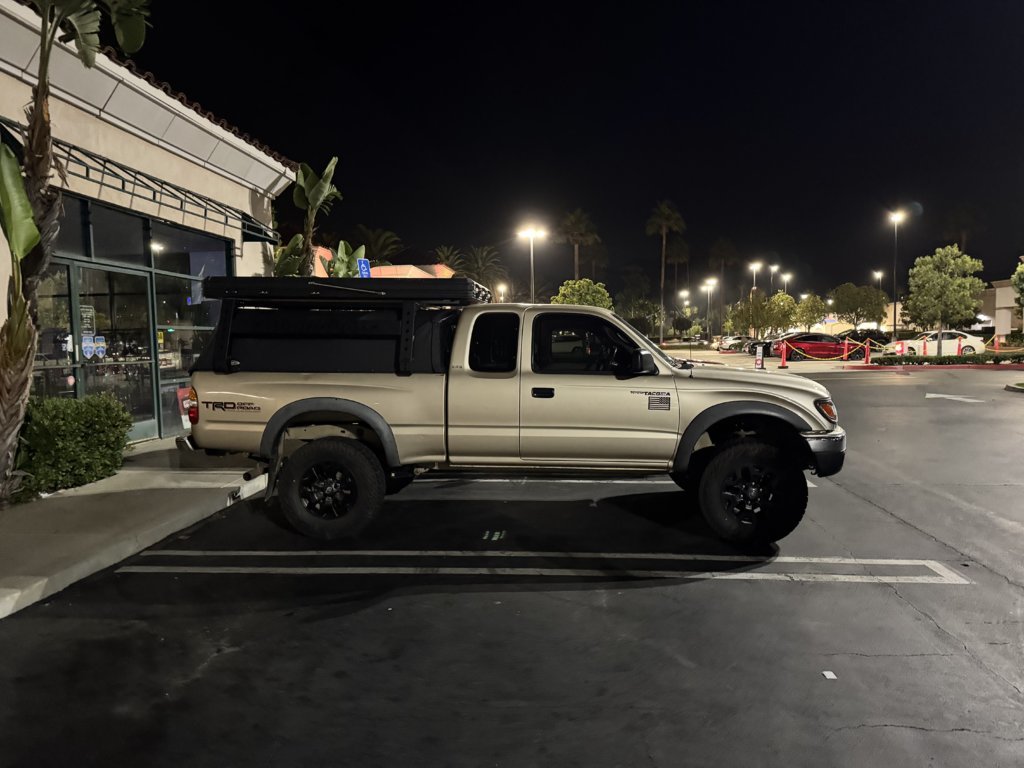

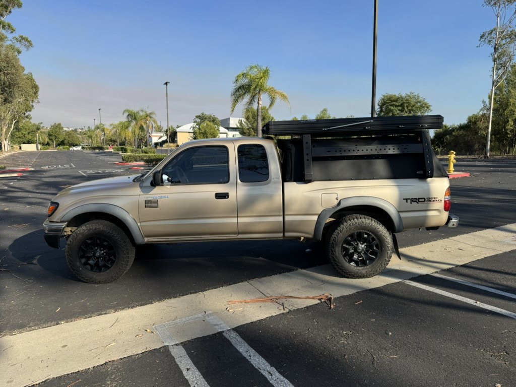

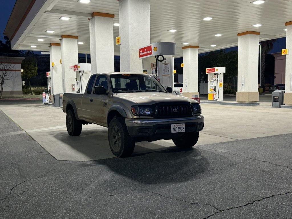

    Okay, first off, I was super nervous of the notoriously stiff ride that OME tends to provide us First Gen guys. To my surprise, however, the truck feels GREAT. It drives on road a lot better than my stock suspension, and it feels so much more stable off road. Keep in mind, however, I have quite the load in the rear that is helping with the softness. All this to say, it drives like a truck still, but a truck that doesn't have blown out 22 year old suspension :)
    Visually speaking, I was nervous about the size of my tires (265-70-16) looking too small with the lift... However, I think my truck actually looks far more proportional now overall. I'm obviously biased, but to me, this is a huge improvement over how it used to look. The ride height has settled about an inch on all four corners since these pics have been taken
    Once I use up all the tread on my tires, I will most likely add a leaf in the rear and upgrade my tires to 285s!

    Before the lift...
    After the lift...
    My truck next to my buddy's sweet first gen
    Had to flex it out in a parking lot right away lol
    Thanks for readin!

    Brave muddersucka using the bottle jack method. Props to you though. I finally bought a macpherson style compressor and it’s never been easier.
    Truck looks good, BTW.
