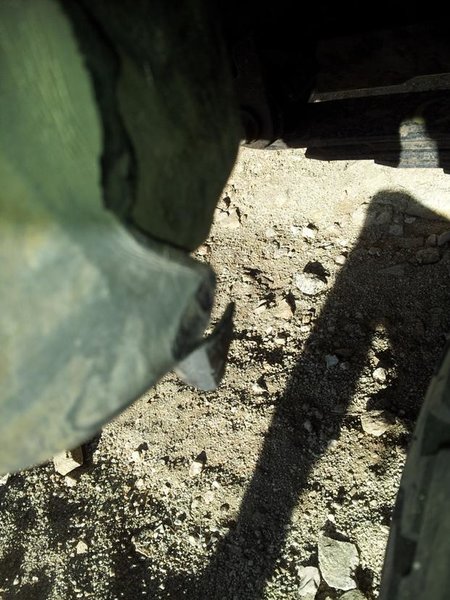

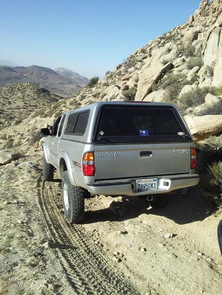

    I did my first run with the OME 883/Dakar's and 255/85-16 Cooper ST's yesterday and everything worked great. The only rubbing was at the front of both rear flares. There was no rubbing at all in the front no matter how twisted up I got it. Since I expected some trimming would be needed in the front I consider this a huge success!
    There were a few places I missed my Jeep but the Taco held it's own just fine. I did have to back out of one spot due to not having my sliders welded on but that was just to prevent body damage. If the sliders were mounted I could have snaked right through.
    Tire placement seems to be more critical too since I'm used to 35's and just leaning out the door to pick my line. The "smear" technique doesn't really work well with the skinnier rubber either. More seat time should get me more comfortable.
    One initial concern with the Taco was how "tippy" it was going to feel vs my TJ. With the limited articulation of the IFS I expected more 3 wheeling and pogo issues but the rig felt planted in most spots. I would rate the trail we did as a 3+ and a good representation of the stuff I like to run.
    My initial idea of building up a Tacoma was to have a true dual-purpose rig. Something that could get me to the Rubicon in comfort, handle the trail, and then return me back home. So far in the 3 months I've had it everything has worked out better than expected. Just a few more mods to wrap up in the next couple of weeks and it should be perfect.
