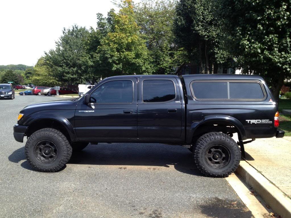

  11. Jan 4, 2014 at 5:27 AM
    #571
    soup101
    soup101 Active Member
    Dec 6, 2012
    #92585
    41
    Joe
    Maryland
    04 SR5 TRD DC 4x4
    OME 882 Coils, OME Dakars with D6XL AAL, Nitrocharger Sport Shocks, Sky Manufacturing rear axle relocation plate set 3/4 inch towards rear, BAMF BPV Relocation Bracket, Leer 100R Shell, Trail Gear Sliders, Trail Gear Low Profile Front Bumper, CBI Outback 1.0 Rear Bumper w/ tire swing-out, Cornfed Suspension Diff Drop
    I agree 100% that the 882's and D6XL AAL based on what you said you plan to do. Heres my truck and its setup almost how you plan with camper shell and TG front bumper and CBI rear bumper.
    OME 882 Coils,
    OME Dakars W/D6XL AAL,
    Goodyear Duratracs 285/75r16
    86c2cb98-b29a-40a4-9118-3bbe985aec74_zps_d8e6c4a670c3e5e43e2a4881ba4b20a8530dae72.jpg

  12. Jan 4, 2014 at 6:44 AM
    #572
    Madjik_Man
    Madjik_Man The Rembrandt of Rattle Can

  14. Jan 4, 2014 at 8:00 AM
    #574
    soup101
    Dec 6, 2012
    #92585
    41
    Joe
    Maryland
    04 SR5 TRD DC 4x4
    I can't directly answer you question but can give you my experience from using 882's and the AAL on my truck above. When I installed my suspension I still had stock bumpers front and rear and always have my shell on. I had about 3/4in rake which was nice IMHO. Once I installed front and rear bumpers I sit pretty much level which is OK but I like a little rake for when I carry a load. IMHO 881's and the AAL will give you well over an inch of rake with your camper and prob over 2 inches with it off and no load.
    I would do what scocar suggested if you are going to run the 881's and run the dakars and evaluate whether you need the AAL later.
    Heres a pic pre-bumper.
