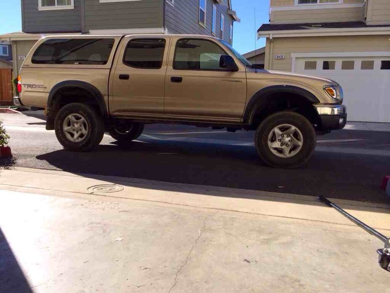

    I needed to add 1.5 shackles and remove shell on mine to make it .5" rake. See pic.ImageUploadedByTapatalk1391544317.239896.jpg

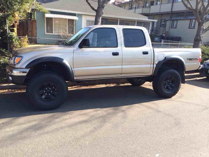

    Here is before with shell:ImageUploadedByTapatalk1391544428.946328.jpg

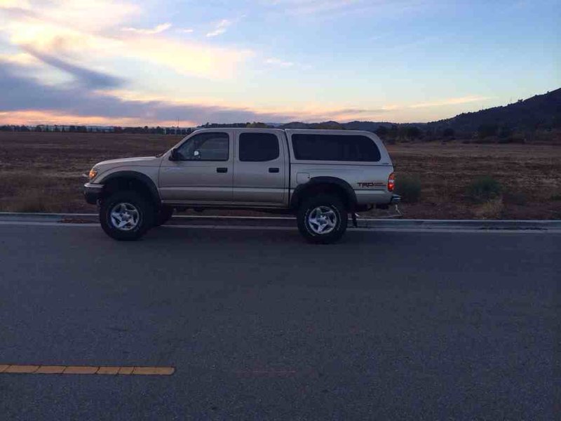

    And after with shell:
    My .02 is to install aal to start with. I'm kicking myself now for not doing that.
