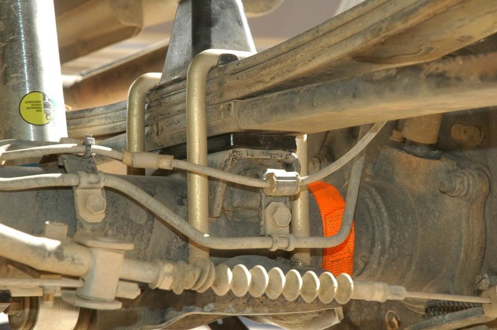

    IIRC, the dakars contribute to this and some have had to use axle relocation plates to move the axle back just a bit. The relocation plate goes between the spring perch on the axle tube and the springs.
    Here is a link where this is duscussed:http://www.tacomaworld.com/forum/suspension/225486-rubbing-post-axle-relocate.html

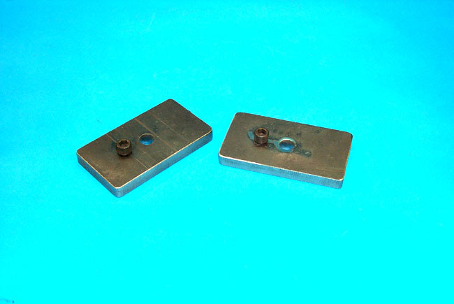

    Relocation plates:
    How they fit:
    DSC_7565_62ddc65d02391bbdbd7d0d3af4b7c705f8fbecae.jpg.

    the relocation plates are a good fix for rubbing at the front or rear of the wheel wells. I suggest getting the plates at 4crawler.com They allow for two positions, either 3/8" or a full 1" of adjustment in the axle location so you can get it just right.

    i put these on to fix the rubbing and also the bottoming out of the slip yoke on the drive shaft. took all of an hour to slip under the leaf pack by myself.

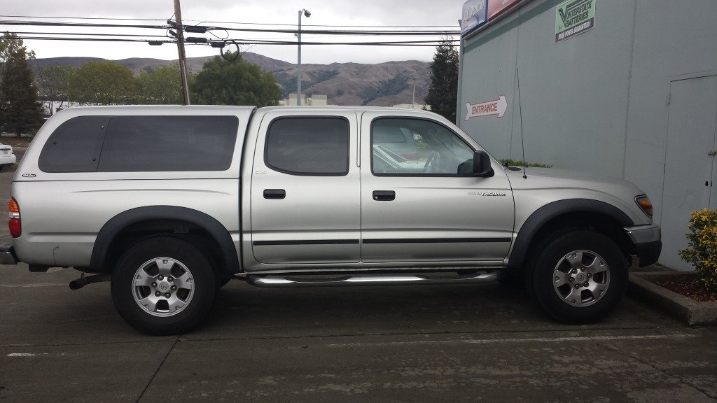

    Here's my before pic from earlier today

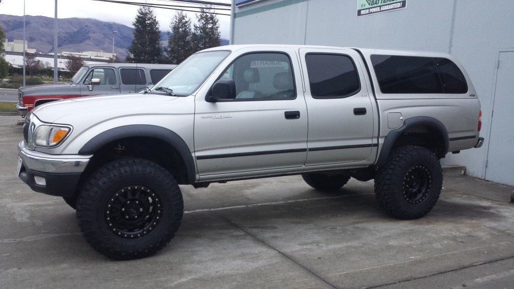

    Here's my truck with a OME lift kit. I went with 882 front springs and dakar rear leaf with aal's.

    That looks perfect!

    Looks KILLER! what tires you runnin there?
    stock shackles?
  14. Feb 8, 2014 at 11:14 PM

    Looks great man! I'll be going with that same setup in about 4 weeks!! How far you think the back will be down compared to the front, without the AAL?

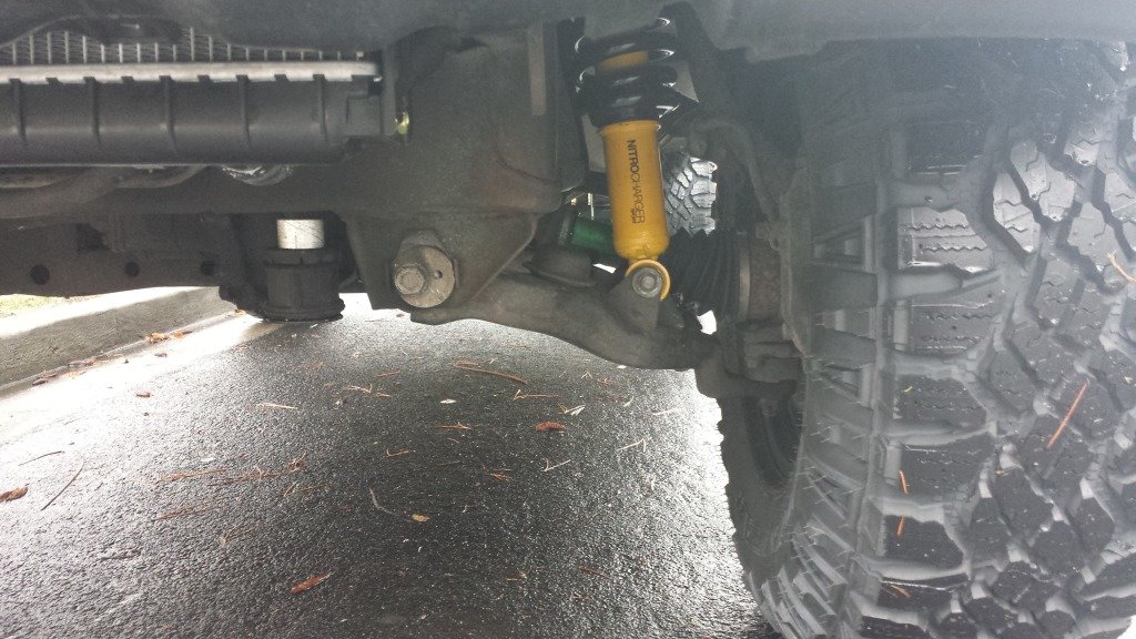

    Looks great, will most likely be doing the same. I've got two questions though:
    1. Is that the 10 mm JK spacer I see there?
    2. Got any pics of CV angles?

    Would also like cv angle pics

    I'm running 285 - 75 - R16s Duratracs with 16x8 Method double standard wheels with 4.5 back spacing. And All Pro 1.5 longer than stock shackles.

    Aw man, that looks so good. Glad to see it worked out. Jelly of your aal. For the meantime, I'm going to set my shackles for a 2" setting (ugh!!!) to maintain rake with shell. Did you go with a diff drop or no?

    Yeah I got cornfed 1" diff drops and I'll post pics of the cv angles later once I pick up the truck from the alignment shop.
