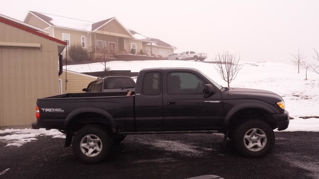

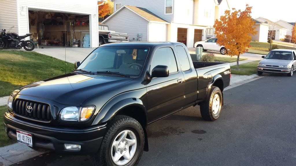

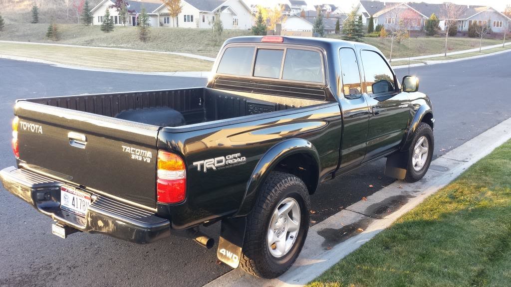

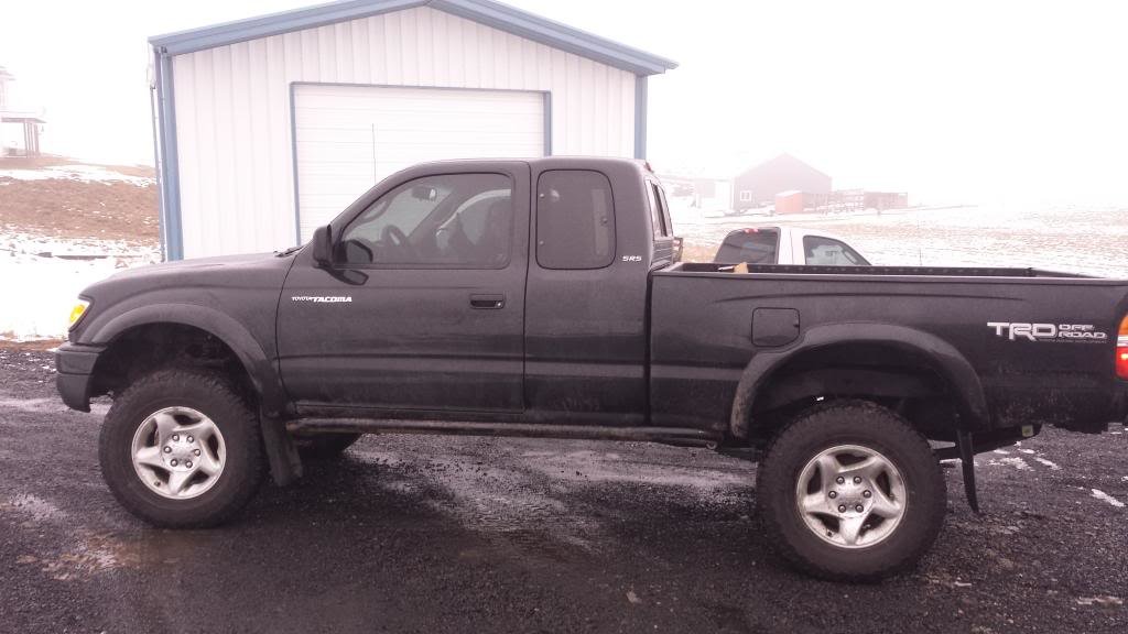

  8. Mar 2, 2014 at 8:52 PM
    #728
    Cykososhull
    Cykososhull Better not bring your kids
    Sep 29, 2013
    #113508
    316
    Anthony
    Texas
    03 Tacoma SR5 TRD
    uniden cb, Grey wire, Deck plate, OME 883 coils, Dakar w/D6XL, 4X innovations sliders, tinted windows, debadged, TG low profile bumper, Piaa lights, Allied soft 8s, Bighorn 285,75,16s
    Just installed today. It is night and day. I love the way it feels now. :D
