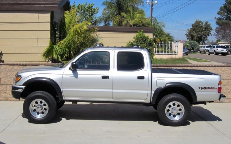

    Friend & I, installed this set up:
    I ordered these assembled from Wheelers.
    882 coils
    90004 front Shocks
    1 - 5mm Trim packer on Driver side
    Just had alignment done, i Like it!!!! I have a Bro lean, I knew i would but wanted to get this front-end pkg installed and see how much lift i need in the rear to level her out.. Ride is not bad, not bad at all...
    From Center of Hub to Bottom of Fender is exactly 25" Both sides..:

    All this. I'm adding a winch, not just so I can keep from getting stuck but to add weight to get the nose down. Somewhere after the winch and a belly skid, I'm going to reasses the ride height and possibly reduce it if needed. The only reason I have downtravel right now is I paid the big money for some uniball UCAs.
    3" is hard on the IFS.

    Looks pretty good, might be a little high..
    Any pics of your cv angles from the front?

    Hello, wanted to Thank you for the guidance... 2WD here....
    Front end shop advised alignment not an issue and all looks real Solid... I like the stance....Working on rear leafs now..... The ride is fine for this High lift... I am happy with it,,...
